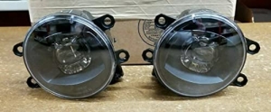

    I just purchased a 2020 tacoma TRD Off-road Double cab. So far the only upgrade I’ve made is installing a beautiful set of KO2’s in a bigger size. It looks amazing! :)
    The one negative is my 2020 didn’t come with the upgraded LED headlights nor the fogs. I’ve been reading and researching for the past 2 weeks to which direction I want to go. I’ve decided not to purchase new OEM LED Housings from Toyota and instead change the bulbs to LEDs.
    Initially, I was going to run Morimoto 2.strokes on hi’s/lows. and then the XB LED Fogs… but after a lot of research this is the route I’m leaning towards for my hi’s/lows.
    1. GTR Ultra Series 2 GTR Ultra Series 2 H11 for both Hi’s / Lows - ANYONE USE THESE YET AND HAVE ANY FEEDBACK ON THE THROW? My lows/projector are H11 and highs are H9. I don't guess difference between two and the H11s will go in both?
    2. Fog lights… I’m stuck from this thread between three options.
      1. KC G4 LED Fog - These are my #1 choice for the Lux it produces and feel these will offer the best performance. These are the most expensive of my options, but leaning towards this.
      2. [​IMG]Toyota PT413-42191 Black Fog Light PT413-42191- These are the OEM ones here that will fit the toyota. I saw these were Chinese and cheaper than the Japanese (heard japanese are better built and ones to get over chinese mfg'd). The lux or output isn’t as good as the KC G4. OPINION GUYS? What is the main difference between the Chinese and Japanese version?
    3. Any recommendations on reverse lights?
    This is the direction I’m thinking to go? Do you guys have any feedback or advise? I really appreciate that a lot before I pull the trigger and get these today or tomorrow! :)
    Btw... anyone know who or where the best place is to purchase all of this? I live in TN.
    Parker315 likes this.

    Well first off, welcome to the forum brother and congratulations on the new truck!!
    You asked some excellent questions and you’ve listed some great options. There are SOOO many options on the market now.
    Those GTR lighting bulbs are definitely in the high quality spectrum, I might also recommend you to check out two other options as well....
    1- VLED: Great company with some EXCELLENT products for High, Lows, Turn Signals, and Reverse bulbs. Definitely a killer one stop shop and the headlight bulbs are adjustable so that they sit perfectly in the housing.
    2- XenonDepot: Again great company, well made and solid products for Highs, Lows, and Fogs and and these headlight bulbs are also adjustable so that they sit perfectly in the housing.
    As for the fog lights, you’re definitely on track with replacing the whole housing. You can do a drop in bulb replacement there as well, but your going to see greater performance out of a whole new housing that’s designed for LED. Some great options there if your wanting to keep the round design are Baja and KC.
    I would continue to research a bit more, because again there are so many options. I know of tons more, but considering the price range you’ve listed, I feel these are good options. If you have any questions at all, feel free to ask here or PM me. Good Luck!
    Oh and FYI: Do not get the Morimoto XB’s they SUCK lol I had them and the output I was not impressed with.
    https://www.vleds.com/
    https://www.xenondepot.com/
    Fog Options:
    https://www.bajadesigns.com/products/Toyota-Tacoma-16-17-Lighting-Kits.asp
    https://www.kchilites.com/industry/fog-lights/gravity-led-g4-toyota-tacoma-led-fog-light-system.html
