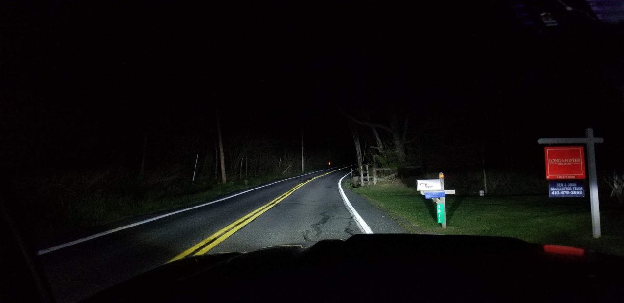

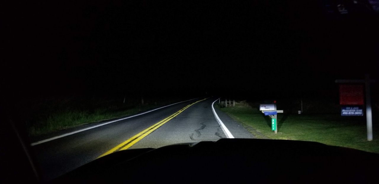

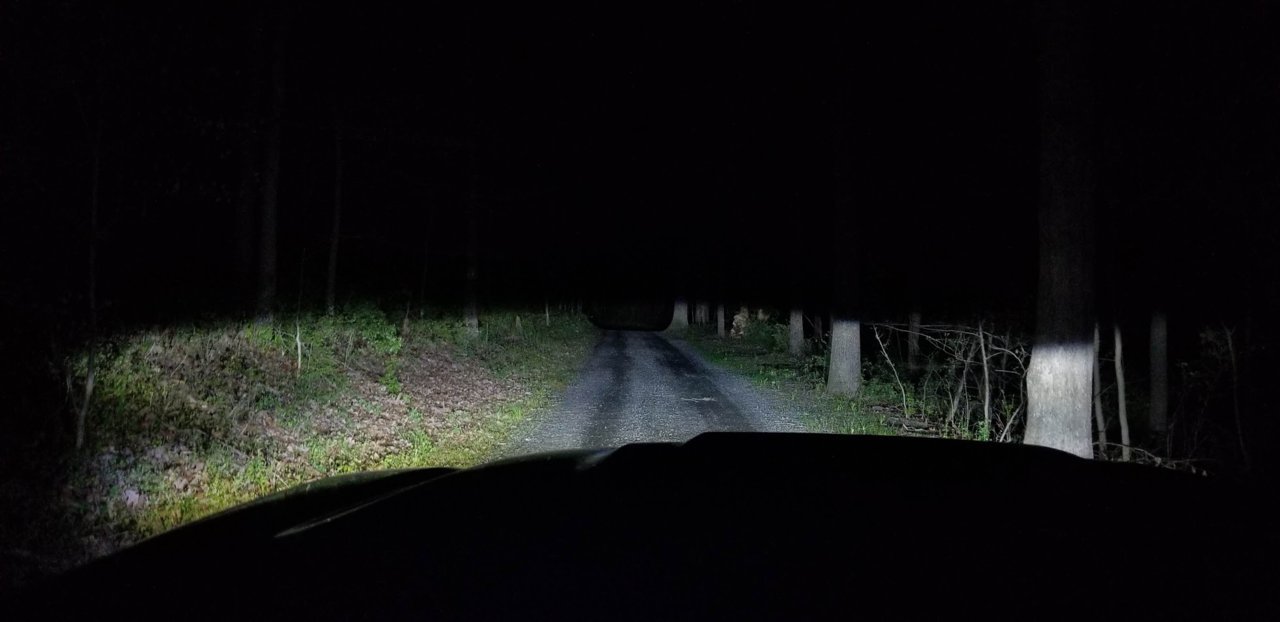

    Sup My Brother!? As you know Brett, when the Sport was totalled I lost the Xenon Depot headlights. When I finally replaced the Sport with the Pro, I remembered I still had the Hikari's so I threw them in there.
    Here are a couple shots. These are unadjusted, out of the box and look at that cutoff everyone likes to say is impossible with the 3rd Gen headlight housing.
    In the woods just low beam and oem (Rigid) fogs.
    TYa-s0KS5lsFfW9qg-0fdp8JPgKkdMmCdKz1ouSF_836ba679a31b41c1e140b928378aa83fb42e7f9a.jpg
    Out on the road with the lows and oem fogs
    Fd4ufdwDB4O5cz9_0KP0VWwCJ8rlfplqB7iZKV35_c3cc942ae1f607338b3f8ff6d145e438bae4644d.jpg
    and just to show how much difference it is, here are the low and high beams together
    ACtC-3er9bpQENl65j69LuIND7P2D4slNIH0pa9S_04282cdd5d47dd920efc5a602900549864525e71.jpg

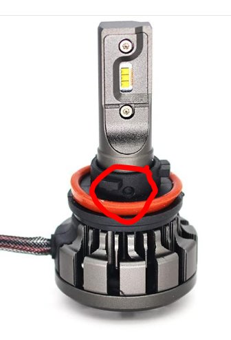

    Yea, I have the exact same bulb in both. When we all bought these there were some other guys in the thread that were much more technical than me. They actually removed the screws that holds the base to the blade, shown here
    then they were turning the blade (the silver part with the leds) so that when it was finally locked into the socket the led's were at 3 o'clock and 9 o'clock. The Xenon Depot bulbs had this ability built into them.
    I didn't do it then, and I am not doing it now.
    I can tell you this, do not twist these into the socket hard or any other way that they are suppose to be, because the locking tabs will break. One of them is larger and shaped differently so they only go in one way.
    My review of the Zenon Depot bulbs goes into great detail about how the adjustments are made to those. The same would apply to these except for you'll need to drill into them.

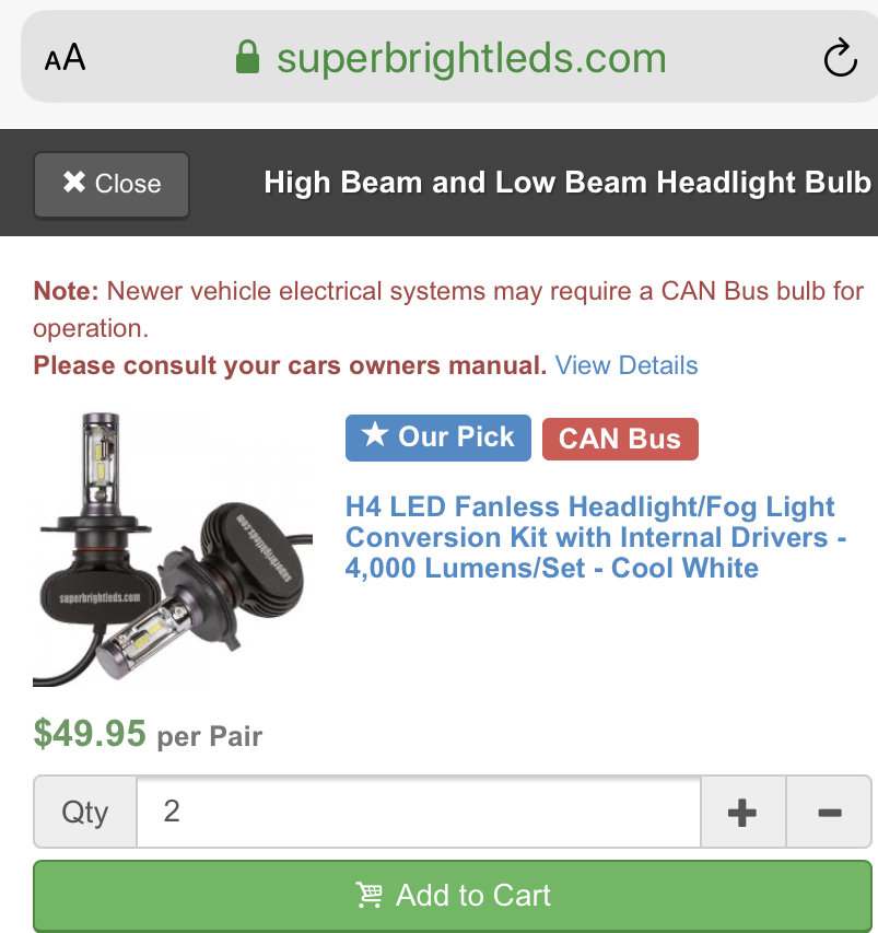

    I was looking at these until I stumbled onto this thread. Supposedly plug n play. I’m just starting to think about swapping. Their interior lights are excellent.

    Those are going to be better than the OEM halogens but you can do better. How are these cooled down with no fans? The LED chip doesn't get hot but the internals do.
    Be careful with these. Also, these are rated at only 4k lumens per set, so 2k per bulb.
    I think you should look around a little.

    More awful advice all round. The Xenon Depot LEDs are well documented to be a very poorly designed and low performing product, not sure why you would try to upsell these as a "very solid but expensive setup". As clearly documented in the thread here where they fail to meet the stock halogen output at 42'. They produce lots of foreground light which may fool people that don't know better, but the loss of distance light is catastrophic, which is the entire point of a headlight.
    As to the Hikaris, only one of those actually attempts to replicate a halogen bulb filament. The XHP50 that you recommend fails to replicate a halogen filament in any way, it is their entry level square LED like those from 5 years ago. The Hikari Ultra is their high performance flagship LED. It is odd to recommend the low performing entry level LED product not designed to replicate a halogen filament at all over the flagship performance product that is best in class at replicating a halogen bulb. A botched design like the XHP50 will certainly create more short range light scatter, which might fool one into thinking they have brighter lights, but little do most realize the high beam does actually have a focused hot spot just above the low beam cut off for maximum distance projection. And going to an LED that doesn't replicate a halogen at all will drastically reduce the distance projection, reducing the range of the high beam, which is counter to their entire purpose.
    Claiming your LEDs are 'adjustable' is admitting you do not understand headlight optics at all. No reputable brand has 'adjustable' LEDs. The emitters should always be placed at 3 and 9 o'clock, zero exceptions.
    Don't fall for that BS. There are so many issues with dual filament LEDs and trying to make them perform properly that even the worlds best LEDs by brands like Philips cannot compete with a halogen upgrade. LEDs by lesser companies just end up with with poor focus, irregular output, low performance and excessive glare. See this thread for everything you need on 2nd Gen headlights:
