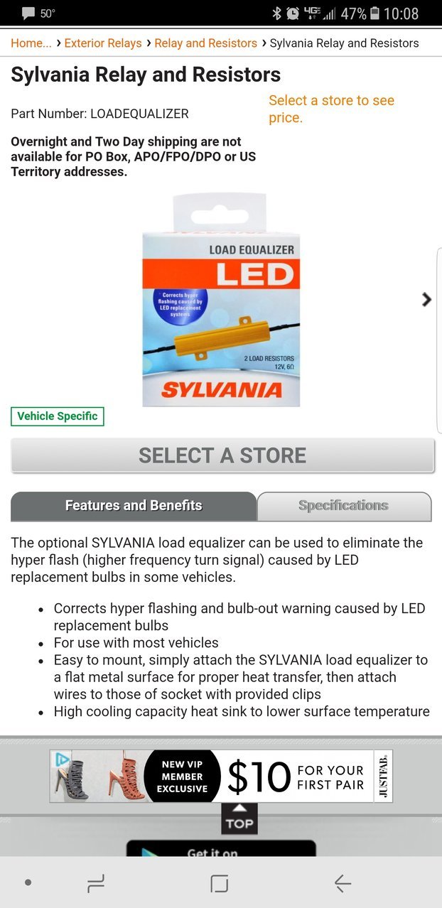

    So I just installed those rear tail light LEDs and they hyperflash when the tail lights are on. But not when the lights are off. Anyone else seen this? Fixed this?

    Need to get a resistor

    I'm sure that'd help but how? I mean I don't want to solder some 100W resistor in the tail light assy.

    Only way I know of. Need to tap a resistor into the turn signal line, 1 side into positive, one into ground line.

    Alot of auto places carry them now. I've seen them at a few autozones and O'Reilly.

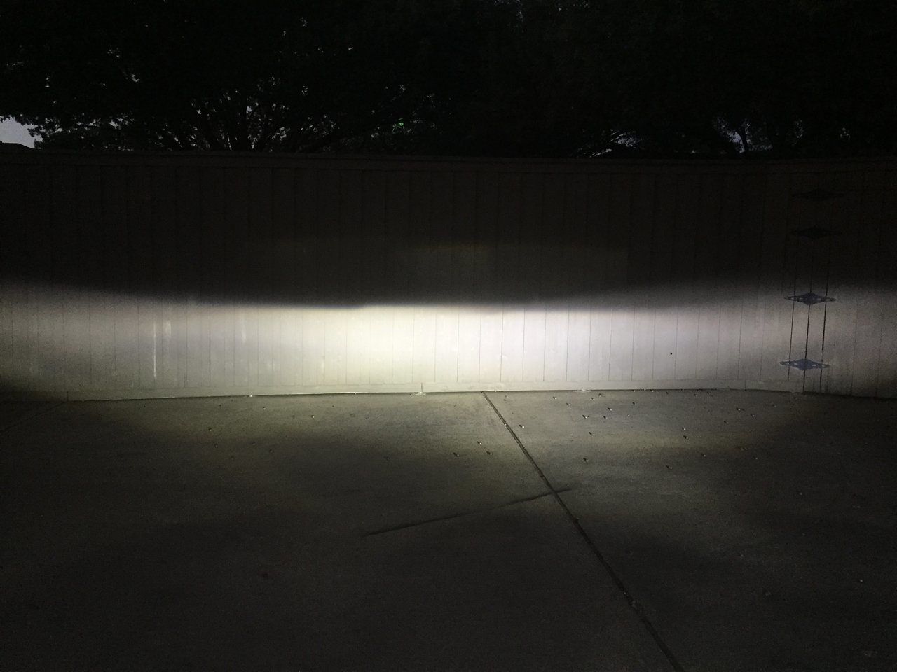

    2016 ACLB TRD OR Quicksand
    So I have the Morimoto 2stroke LED bulbs and latetly I’ve noticed that my passenger bulb would randomly dim when idling at stoplights on occasion. So I gave these a shot. I really like that there is no ballast to them like the 2strokes. These are easy to install. No need to loosen the headlight like the 2strokes.
    Picture below is with the Beamtech bulb installed in the passenger side and the 2stroke in the driver side. I cannot tell any difference in the pattern, or output. I can slightly see the color difference against the fence but I don’t have an issue with that. Both colors are fine with me. I’m very impressed initially. I’ll probably install the 2strokes in my high beams now since I have them. But I’m tempted to get another pair of these so I don’t have the ballasts there either.
    Great find @itsmermf !
    itsmermf[QUOTED] and Ruggybuggy like this.
