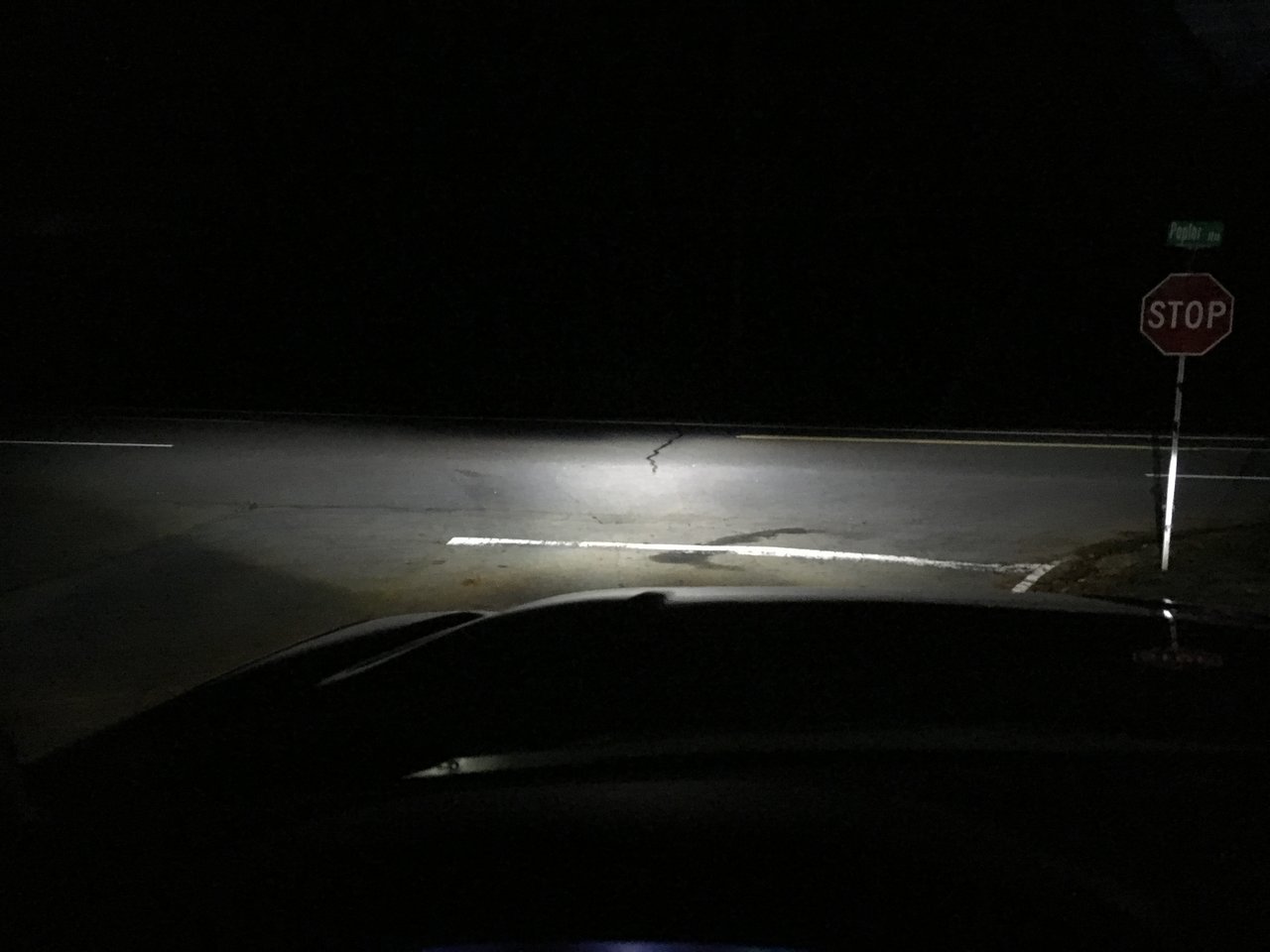

    No. I just put mine in today and there is enough space to maneuver with patience. You have to make sure the bulb is oriented correctly. Flat sides correlate with the position of the leds and they have to be perpendicular to the ground. Leds have to be oriented sideways, otherwise the beam pattern is not focused. First impression is a significant improvement over the OPT7s. I'll try to get some pictures tomorrow. I put the OPT7s in the high beams. Not sure about that. The stock h9s throw longer. Maybe a better h9s is the answer.
    Has anyone tried high beam specific leds or improved halogen h9s?

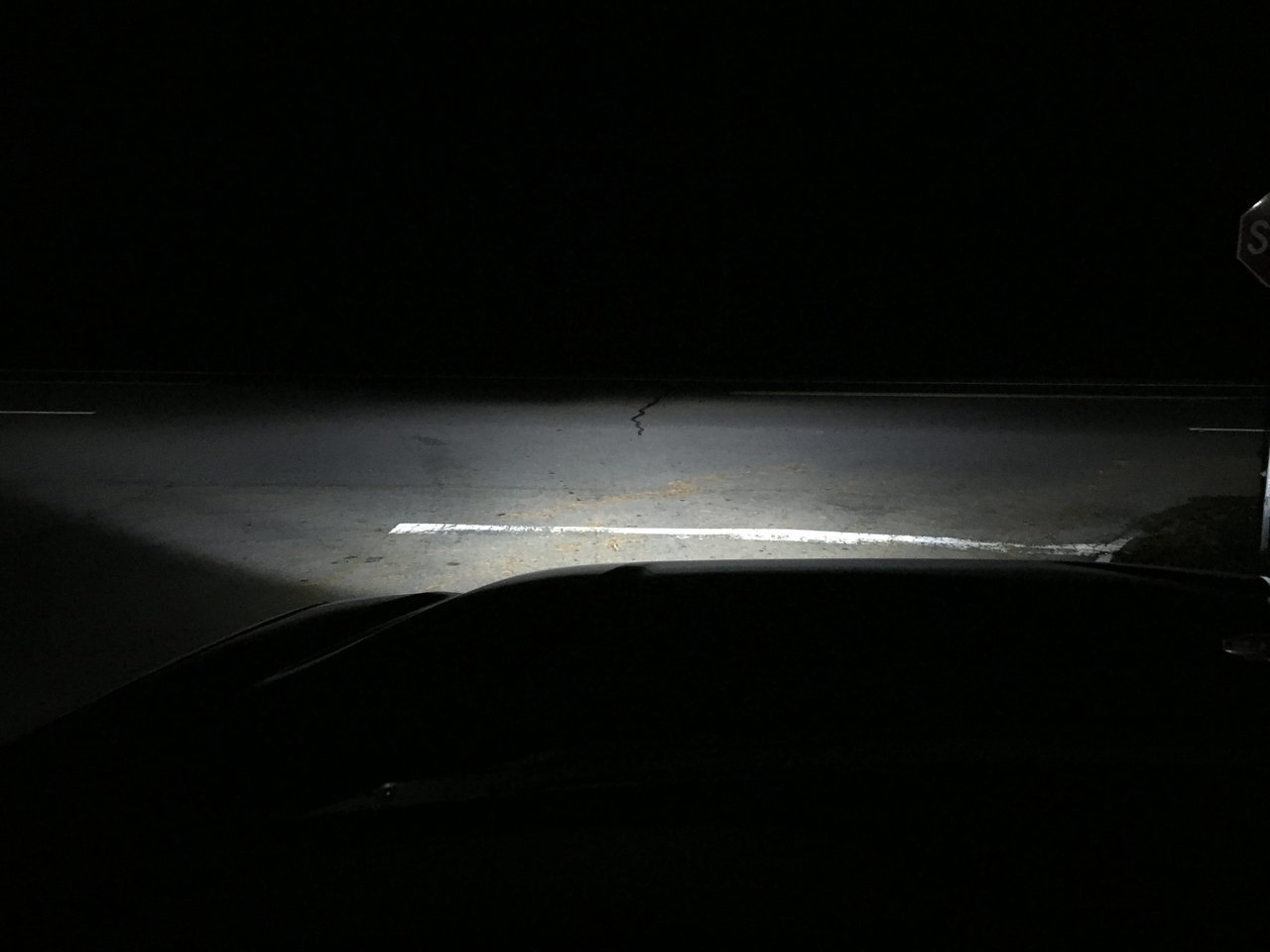

    The first picture is the OPT7s. The second picture is the GTR3. The difference is more than what is seen in the pictures. The GTR are more focused. These pictures were take on a downslope. The throw of the GTRs is significantly better. I find myself using the highs less with the GTRs. I drive backroads before dawn everyday, Usually drive with lows and fogs on.
