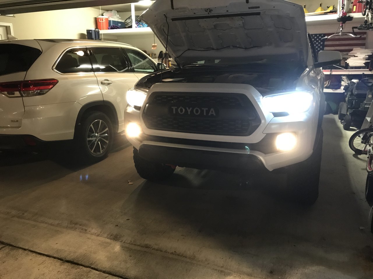

    I just put these auxbeams in. We'll see how they look.
    One of them was a flipping pain to put in, but the rest went in real easy.
    Also replaced the front blinkers with JDM AStar.
    Oh and the fins on the linked Auxbeams above are sharp lol...careful with them.

    I installed Hikari low beams today. I have LED fogs too, but I'm waiting until my bumper comes in to install.
