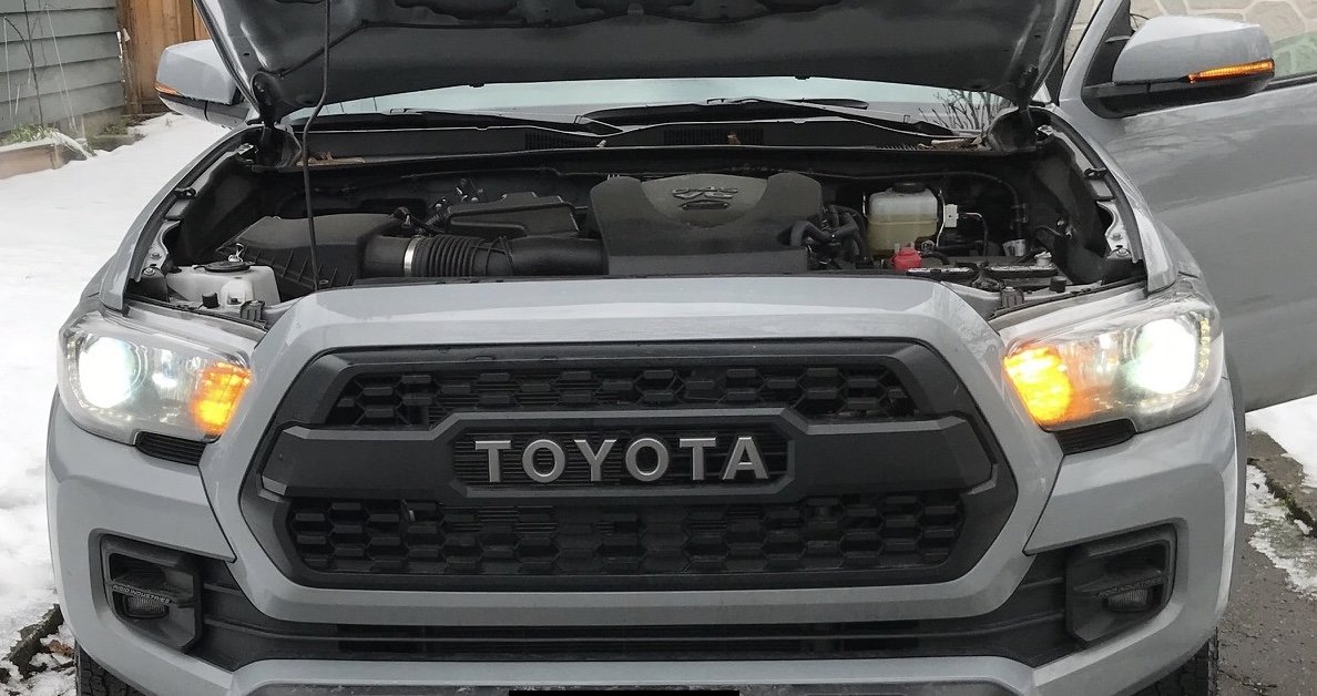

    There is V6 Triton in Amber on the right vs stock on the left.
    No hyper flashing with headlights on or off. Yes I have VLEDS in the tails as well.
    Very happy with them, no resistors anywhere and no hyperflashing under any conditions. Everything was plug and play. Completed the entire truck with exception to front side markers as I can’t get my hand in there, and Low and High beams. I’m done.

    Looking good! No hyperflashing at all right? I’m definitely interested in the Tritons, they look great on your truck.

    Correct. No hyperflashing under any condition. I bought the reisitors that go in line with the Triton connectors so they are plug and play even if I did need them. So this way all factory wiring is 100% intact and no issues if I need to go to stock.
    Only downside is the cost. Doing the whole truck cost a ton of money lol. My Pro deserves it though!
    Also, I really like that when the low beams or whole truck is off, there are no stray amber reflections in there now. But all the interior is done in 5K, beautiful crisp and white. Tails are super bright, reverse is just bonkers. I did plate lights in 6K to match the cargo lights better, all in all output is way and more modern looking. Everything looks great.
    When I need to replace my HIDs I’ll go micro in LB and HB, and when I do something up front like a winch or hidden recovery I’ll do side markers then. That will complete my conversion.
