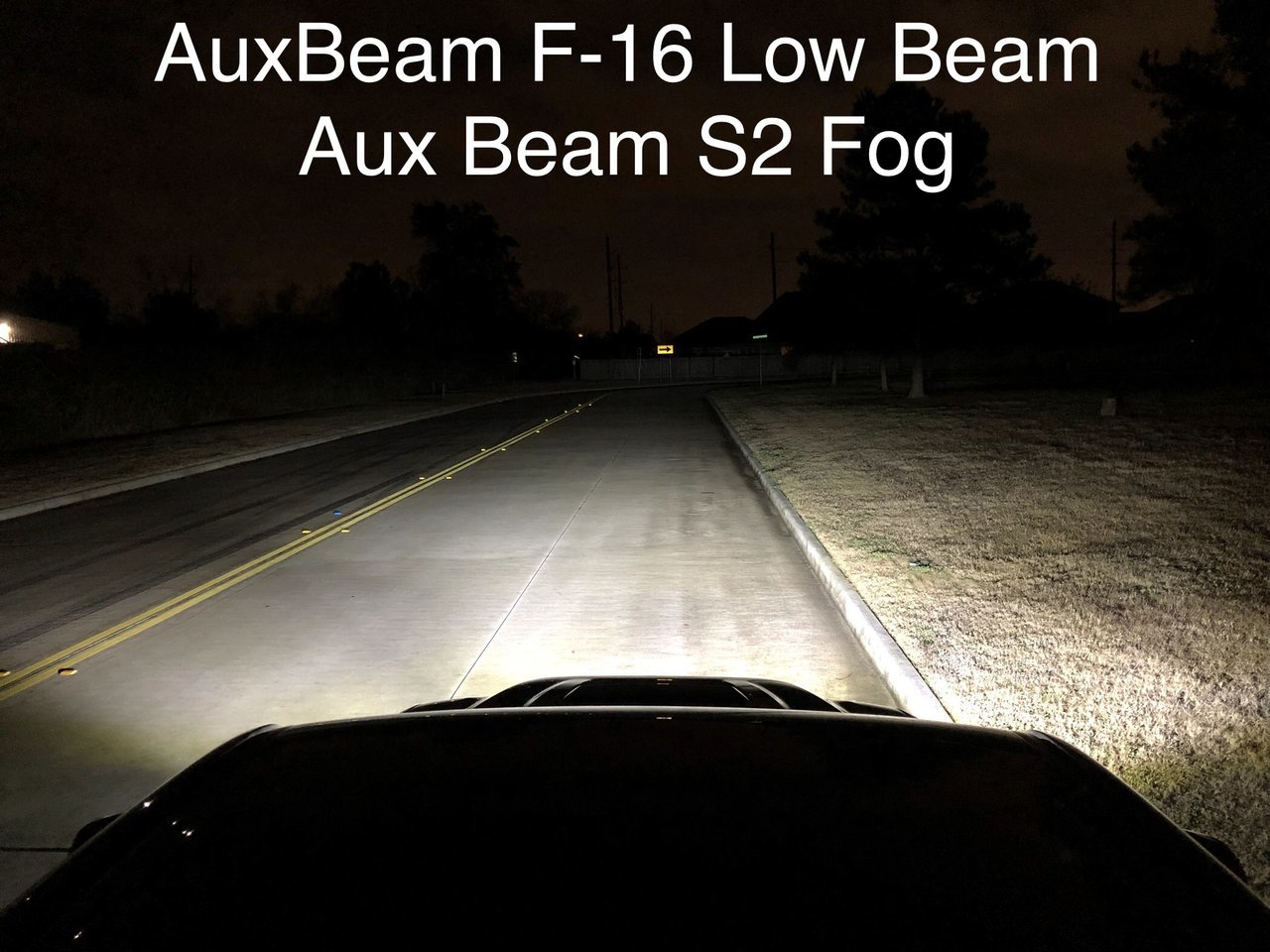

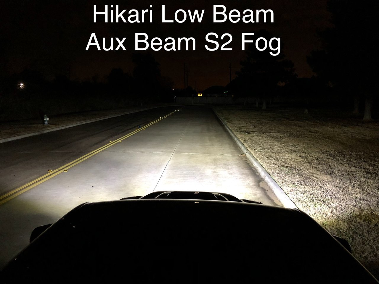

    Ok @ToyoDrew
    Here are the pics. It’s hard to tell honestly which is better. I’m leaning more toward the AuxBeam I think over Hakari but they are close. AuxBeam appears to have a farther throw. 1EA795F3-B0B7-4CDE-AAB7-6F54C4A3DC63.jpg561A4901-DC2A-42BA-9784-882CA0A8D18F.jpg
  9. Jan 20, 2018 at 7:12 PM
    #1109
    Technique
    Technique Well-Known Member
    Nov 4, 2017
    #235046
    2,926
    Alex
    Utah
    2017 Silver Offroad DCSB
    -285/70/17 Toyo AT3 -Tuned
    Ah, difference looks very negligible but the Auxbeams are about half the price of the HIKARI right?
    Parker315[QUOTED] and RobP62 like this.
  10. Jan 20, 2018 at 8:20 PM
    #1110
    RobP62
    RobP62 NVR20LD
    Jun 4, 2017
    #220718
    41,519
    Rob
    Street, Md.
    TTC Member #0125
    Thanks @Parker315 ! For you to do this for us is cool as hell. Posts like this are why I join forums. :thumbsup::bowdown:
    But :sandwich: here comes the sandwich.....
    At first I thought yea, not much difference. And the width right in front of the truck looks same same.
    But then I thought wait, if you zoom in on both pics, and look at the end of the road where it turns right, the curb all the way in the background is definitely lit up more with the Auxbeams. It's very obvious.
    Not to be a nit picker but there might be an unfair advantage in play here because I noticed the truck is closer to the turn at the end of the road in that pic. It's hard to tell exactly but if I had to guess I'd say about 30 or 40 feet closer.
    Again, I'm just pointing it out so we can all decide if that matters or not. When I'm rolling up near the house and on deer lookout high beams are a must.
    I also sort of understand what @Sedyn is saying about "trying to look outside" of a brighter light. I think it's a similar experience to using a 360 degree light source while walking in the woods. Basically, some of the light is being deflected back at you.
    Here's one more thing you guys need to know about me. I'm that idiot that would rather use their high beams in fog or snow and put up with the added glare just to be able to see those deer eyeballs sooner. I know it's crazy but it works for me. Maybe I'm able to do that because they are halogens???
    Just saying.
    Frito, ToyoDrew and Parker315[QUOTED] like this.

    They are about the same price actually
    RobP62 likes this.

    I think your right actually. After I swapped the bulbs I tried to pull up to the exact same spot. Now that I look at it again I was definitely off by 20 feet or so. DAMIT lol
    RobP62[QUOTED] and ToyoDrew like this.

    LOL, you were still pretty close...close enough that it shows us how similar the LEDs are to each other. For the cheaper price but similar performance, I'd be comfortable ordering the Auxbeams now (once my HIDs die).
    Thank you for taking the time to do that comparison and list out all of your LEDs earlier! I'm sure it'll be a big help for many of us for quite a while. :thumbsup::thumbsup: Love these forums!
    RobP62, Frito and Parker315[QUOTED] like this.

    I was basing it on the fire hydrant, green road reflector, and that sodium light beyond the fence on the left hand side in the photos. My job requires me to be that detailed oriented when I'm evaluating aerial imagery. It's a curse I guess.
    So if then light output is similar, and price is similar, then what, we just need to look at ease of installation and longevity?
