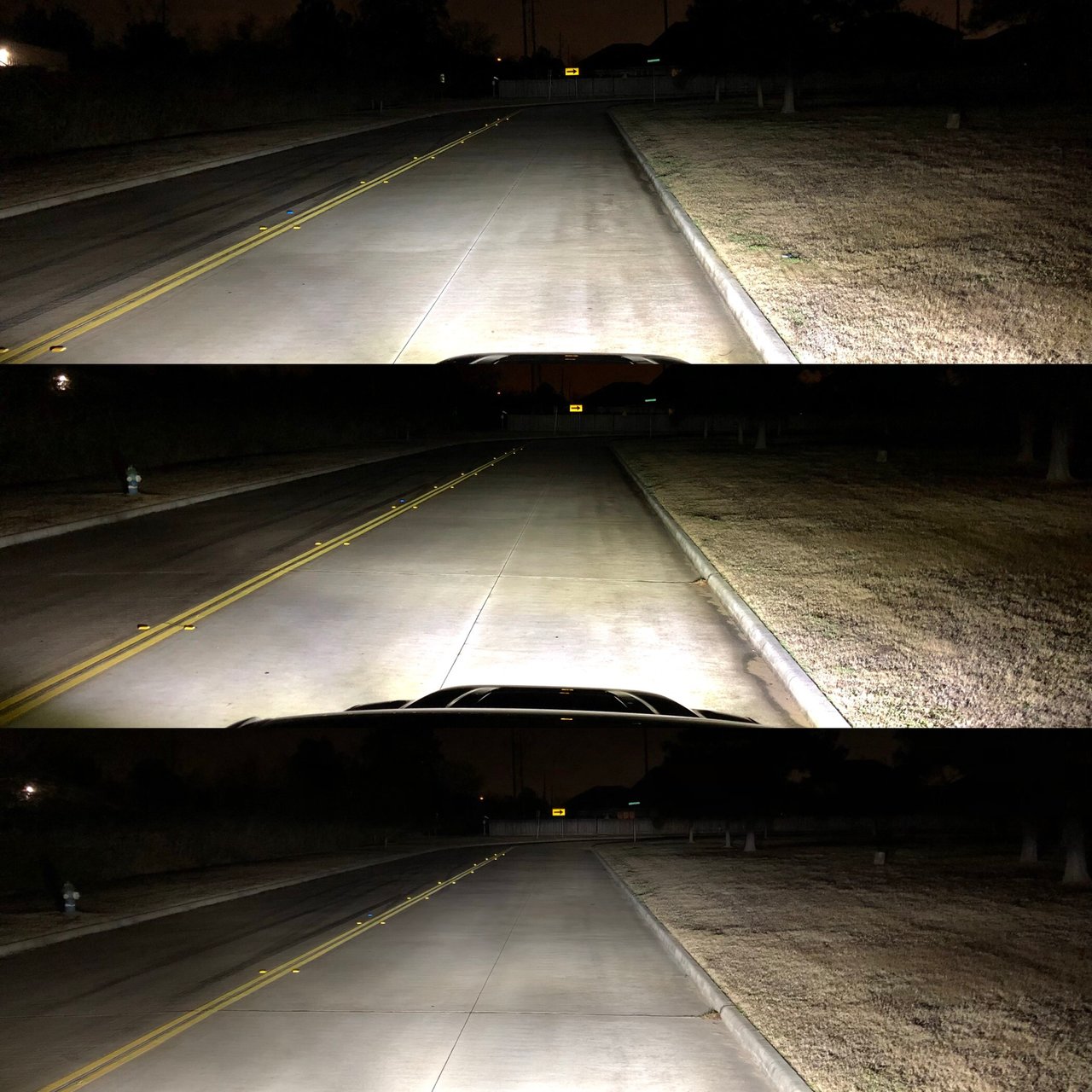

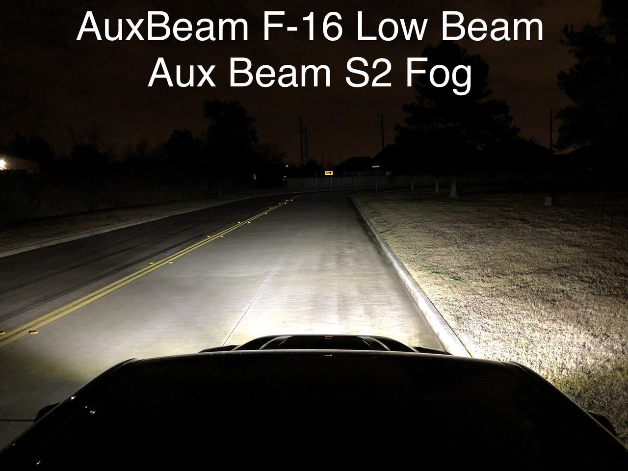

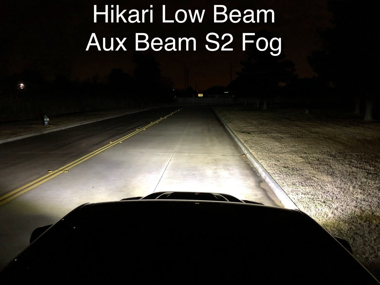

    Alright guys here it is and MAN, WOW!! What a huge difference these New Hikari bulbs are. I’m amazed with the light output and what a difference the PHILLIPS Led is over the Cree LED.
    (Note: In the first photo I was closer to the curve by about 15-20ft. Didn’t realize that till later. @RobP62 noticed it before I did.)
    Notice the fence at the end of the road and just how much more lite up it is. The light output on these are incredible and I can definitely see other competitors going this route if they haven’t already. The throw diffence on these kills the other three sets of LED lights I have. Zero comparison. New Hikari Phillips for the WIN :thumbsup:
    B926CBFC-650F-4698-814A-14BA46764D45.jpgB39E9BA4-EC00-4DA6-89C6-47004FAA6406.jpg74C187E3-963B-4F45-9CD4-89D527311D77.jpg
    (In the collage photo, it goes AuxBeam|OldHikari|NewHikari)

    Wow, that is a significant difference in throw!! :yay: Now I'm tempted to order these even tho I have fairly new HIDs in the LB (I can't put them in the HB cause then I can't flash idiots). oi, I hate these forums sometimes...just when you think you're done with something...:annoyed:

    To echo what @ToyoDrew said, thank you very much for this Brett! Time is a valuable commodity and these days no one has enough of it. Money doesn't grow on trees either. So yes, thank you very much for using your time and money to help us and the rest of the community. If we ever meet, all the rounds are on me!
    :cheers:
    I wish all reviews were like yours. It's so very decisive, factual and undeniable.
    Here's my assessment of the pictures and a couple questions too. Considering the rest of us are judging photos and not in person, the opinion I have is:
    The new Hikari bulbs appear to have a smoother, softer, less harsh look. I think this is because the beam pattern in more uniformly distributed at all distances and angles. There are definitely less abberations or hot spots. To me they look equally as bright as the other two but more pleasant.
    @Sedyn said it best here:
    "What I was saying pertains to any really bright light that isn’t flooding the total area you want to look.
    When I have standard LB 55W HIDs, for me they are so bright that when my eyes adjust to looking into the area in front of me, and I look off to an area where they aren’t shining I can’t see anything, which can be my mirrors or whatever. You don’t look into a dark spot for long while driving. Soyour eyes are just non stop trying to adjust to too large of a difference in light intensity. Then they get strained as my drive is usually a solid hour each way. "
    When I look at the bottom pic I have a better understanding now that's exactly what he ment.
    You're right too Brett, the long range illumination is definitely more pronounced. You can definitely tell that is a wooden fence at the end of the road. And more important, that the road curves around a bend.
    Hell yea, these new leds are the shiznit! Old version are out of my cart, new versions are in.
    Guys, you all rock! Thanks again so much. :bowdown:

    Hey Rob!! Good morning my friend. Your very welcome for the post and I am so glad that it helped and was detailed enough to show differences. You are right the light throw is farther and the light isn't as "intense" but a very clean soft light output and bright enough to do what its intended.
    The LED lights with the cooling fans get a bad wrap, well because they have a cooling fan. Most see it as just something else that could fail. Which i totally get, but with that said though. Computers also have cooling fans that spin constantly and how often do you see those go out? Almost NEVER. Does it happen, yes, but very rarely.
    As for adding the Hikari to the fogs and high beams in addition to the low beams, well i dont see why not. Yes the AuxBeam's work just fine and are plenty bright. I'll throw the new Hikari lights in the high beams one day soon and test the difference between the old and new.
