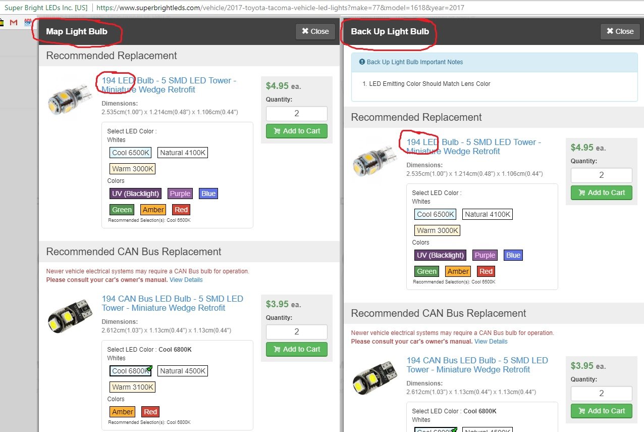

    I just want to know the bulb number that people have used for map and reverse.

    this is what I mean. both bulbs say 194 on superled
    sylvania (was only looking for number not buying their bulbs) says reverse is 921 and map is 2825.
    Also assuming the bulbs need to be canbus to avoid hyper?
    I dont know so I ask.
    ps. I have an 18 if that matters but most sites arent showing 18s

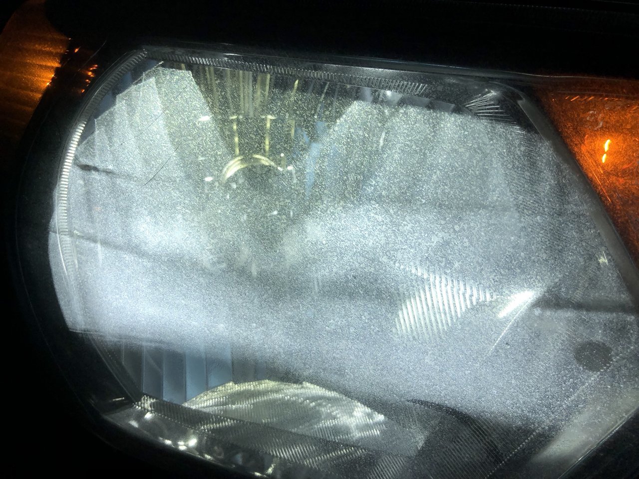

    Yes, you are right. I can be condescending. It is when people receive new information and facts that contradict their previously held understanding and rather than adapting and expanding their knowledge they double down on their old beliefs that I will be terse. There is way too much of that narrow mind set in this world. But you are right that is not very constructive, I will work on being more constructive. And the previous statement was not meant as inflammatory. I have been proven wrong on lighting in the past by some industry experts, and rather than stay steadfast in my previous convictions, I took in the information and used it to become more knowledgeable on the topic.
    Yes, I realize this is an LED conversion thread, but it doesn't change that LEDs are fundamentally flawed for the halogen headlight assembly. It doesn't matter what new versions or new LEDs come out. The optics are incorrect. I know everyone is tired of hearing it. I'll leave it at that. I actually usually leave 3rd gen LED threads alone, the projectors won't glare and you just reduce the effectiveness of your own lighting without blinding anyone. But I had multiple people contact me to about the LED headlights in this thread and pointed to the popularity of this thread thinking somehow these headlights are different. And this is how mis-information snowballs.
    For light testing I'll throw money away on a few products like this one for educational purposes, but my focus is to produce the best possible output with a quality beam. That is never going to be an LED in a halogen housing, so I am not going to put money/time/effort in something I know from an engineering standpoint doesn't work.
    As for the light rack and testing LEDs in stock Tacoma housings, you are missing the point (not trying to be rude). LEDs in stock Tacoma halogen housings will never work correctly. The purpose of the light rack is all those lights (except one) can mount in the stock Tacoma fog location. The rack is built to the stock Pro foglight height and spread. All lights have all been designed from the ground up with LED optics to match their LED light source and the majority are SAE J583 fog compliant which is purpose made for that location and results in uniform light spread with a good beam pattern and no glare. This resolves the entire issue we have been debating and will also out perform putting LEDs in the factory halogen foglight. I purchased every single SAE J583 LED fog that I could find which can be mounted on the Tacoma in the stock location to determine which is the highest performing light with a good beam pattern. I put some others in there to help educate people on beam pattern differences and why they are important. The rack and future thread is to find a real engineered solution for the best LED foglight possible. That is the kind of light testing I find worthwhile. A challenge I have on the project is figuring out how to measure output of a forward facing LED light vs a reflector based LED light. The intensity of a forward facing LED vs the more distributed light from a reflector will not make comparing output at the lens surface very meaningful between the two. I've consulted my engineering team and we have come up with some pretty complicated solutions but I haven't been satisfied with any so far.
    Anyway, on to the HIKARIs!

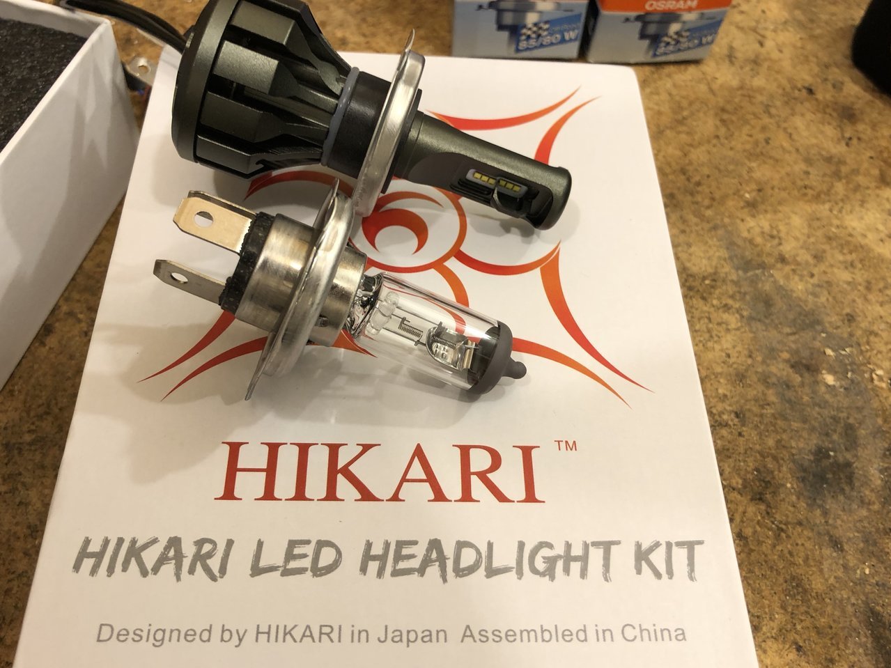

    I ordered the HIKARI bulbs from the original link. They are the H4s which isn't a perfect comparison for the H11, but the 2nd Gen takes H4s. I now see the design is different/updated on the H11s, which I did not scrutinize before ordering, but regardless I ran them though some tests anyway.
    Some initial product notes:
    -They have a semi-innovative collar design which should allow retention of the boots. I say semi because it could be done a lot better. The light is removable from the 3 tab collar mount so you can install the mount then install the boot and inset the LED in afterward. However the twist lock design does not fix the LED bulb into the exact orientation when it locks in place giving an awful beam pattern. You must then rotate the LED by hand while looking at the pattern on the wall to make sure you have it oriented correctly. I pulled it back out and noticed the 'locked' position is about 15 degrees off of where it should be. Headlights are precision instruments, there should me no free handing of the light source to correct the beam. For you 3rd Gen projector guys, if you have these lights and rotated the light till it 'clicked' or locked in place it is likely not properly aligned and your beam is suffering because of it but you might not know because your projector light shield cleans up the evidence. Wall test the rotation or pull the collar out and look at the LED orientation when it clicks in place compared to the mounting tabs on the collar. The LEDs should be level horizontally right and left.
    -These have fans. No modern LED should be running microprocessor cooling fans in an engine bay which are prone to failure and noisy. I can hear the whirring of the lights when they are on if I am outside of the truck or in the truck with it off. Passive cooling technologies which are not prone to failure, are silent and use no power is common now, and cheap. Cooling fans are a very dated LED technology.
    -On the H4 model, the glare guards are large and not close to the LED chip. Comparing to Philips which almost looks exactly like a halogen bulb glare guard, these are very different. Cannot say better or worse, but significantly different. In competition with Philips I think it is safe to say not as good.

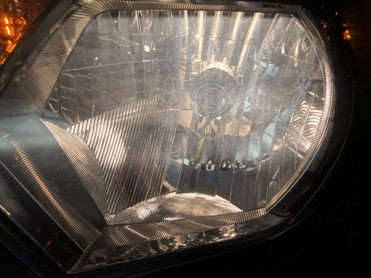

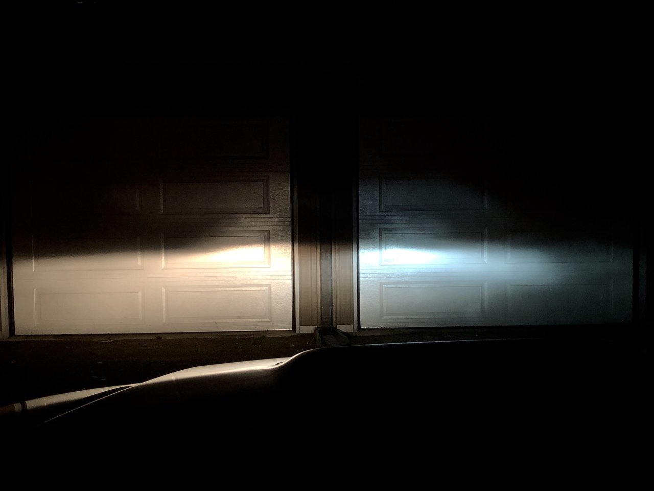

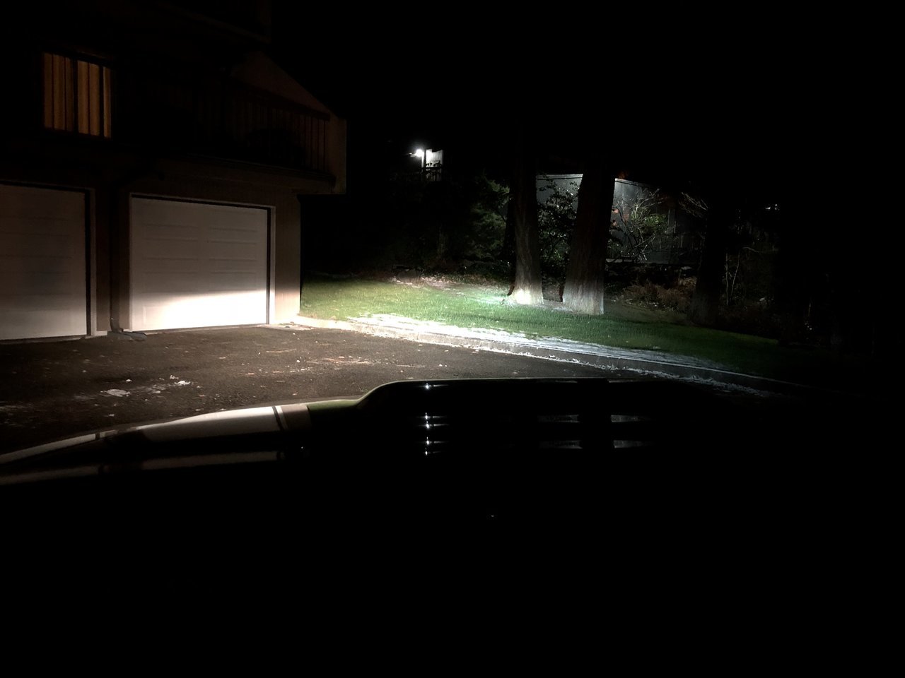

    This is the type of wall shot many people post, super close which really does not provide any information other than beam color. Subtle changes in the beam that are difficult to see are extremely magnified at distance due to basic geometry. A few degrees up close is a short distance on a wall, but those subtle shifts projected over a great distance have a big impact. This is also similarly part of the reason why small shifts in the LED chip placement compared to a tiny wire halogen filament inside the housing have such a negative effect on the beam.
    Backing away from the wall, it is easy to tell the LED beam pattern lacks saturation and has exceptionally poor spread. The beam is very narrow and you almost cannot even see the edge of the garage door on the passenger side. This is going to cause a significant loss in peripheral illumination.
    While this is not an issue in the 3rd Gen projectors, even with the glare shields in the H4 version of the LED, there is still glare.

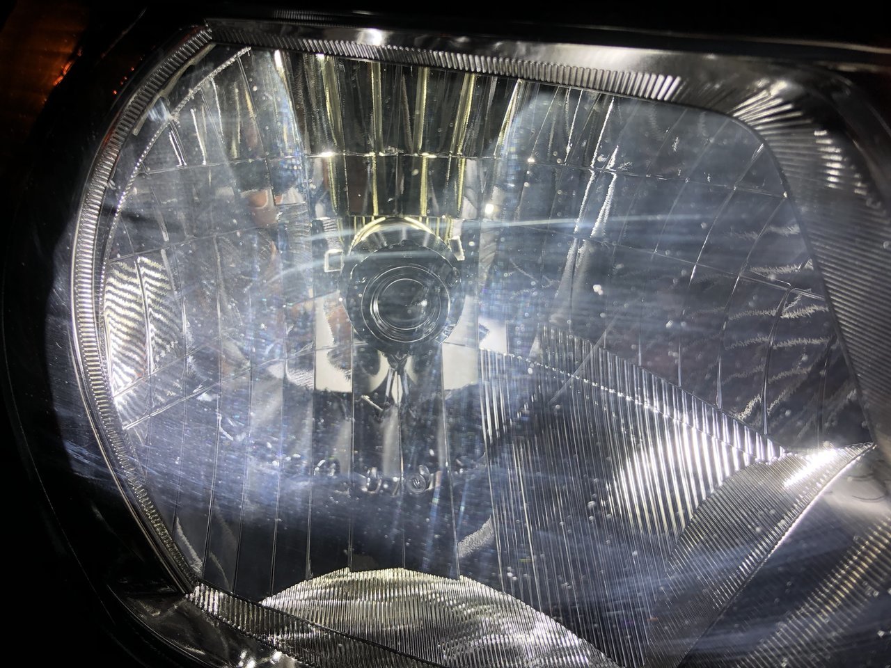

    I try to tell people about uniform housing illumination, which applies to both projector and reflectors but can likely only be easily seen in a reflector. Non-uniform illumination, or failure to illuminate the upper portion of the housing will affect the beams projection distance (aka throw). This is another part of the reason LEDs fail to project distance when they are put in a housing that wasn't designed for them.
    Before cleaning, the dirty housing showed this effect nicely with a clear lack of illumination 'V' above the bulb. This is due to the LEDs being a directional light source, and having them in a side firing configuration. There is no light going to the upper part of the housing.
    You can still see this very easily after then lenses were cleaned.
    Compared to the halogen light source they were designed for which you can tell has a very even illumination line across the top of the reflector to produce a fully saturated and evenly spread beam.
    While many may pass this off as no big deal, loss of distance illumination is a significant hazard. If your projectors increase foreground light with LEDs the problem is further compounded by having your eyes constrict due to the foreground light causing your eyes have less effective night vision so you cannot see as far while also having your headlights not project as far and artificially giving you more confidence that you can see due to the foreground. This is also why you should not drive with your fog lights on unless they are necessary. Seeing an obstacle at night sooner with less constricted pupils and better beam projection gives more time to maneuver or brake if there is an obstacle in the roadway. Fractions of a second count. This is the premise behind the very successful +130 type bulbs that are made with a more precise filament to get a more concentrated hot spot for better beam distance projection. Further controlled distance projection is safer. If you look at the filament winding of a high efficiency bulb like Philips +130 and a standard bulb, you will see there is a difference in the filament winding being tighter and more concise in the +130. If small changes in coil wind and filament precision can make 130% more light in the hot spot, putting direction LED chips millimeters off center is going to have the significant opposite effect.

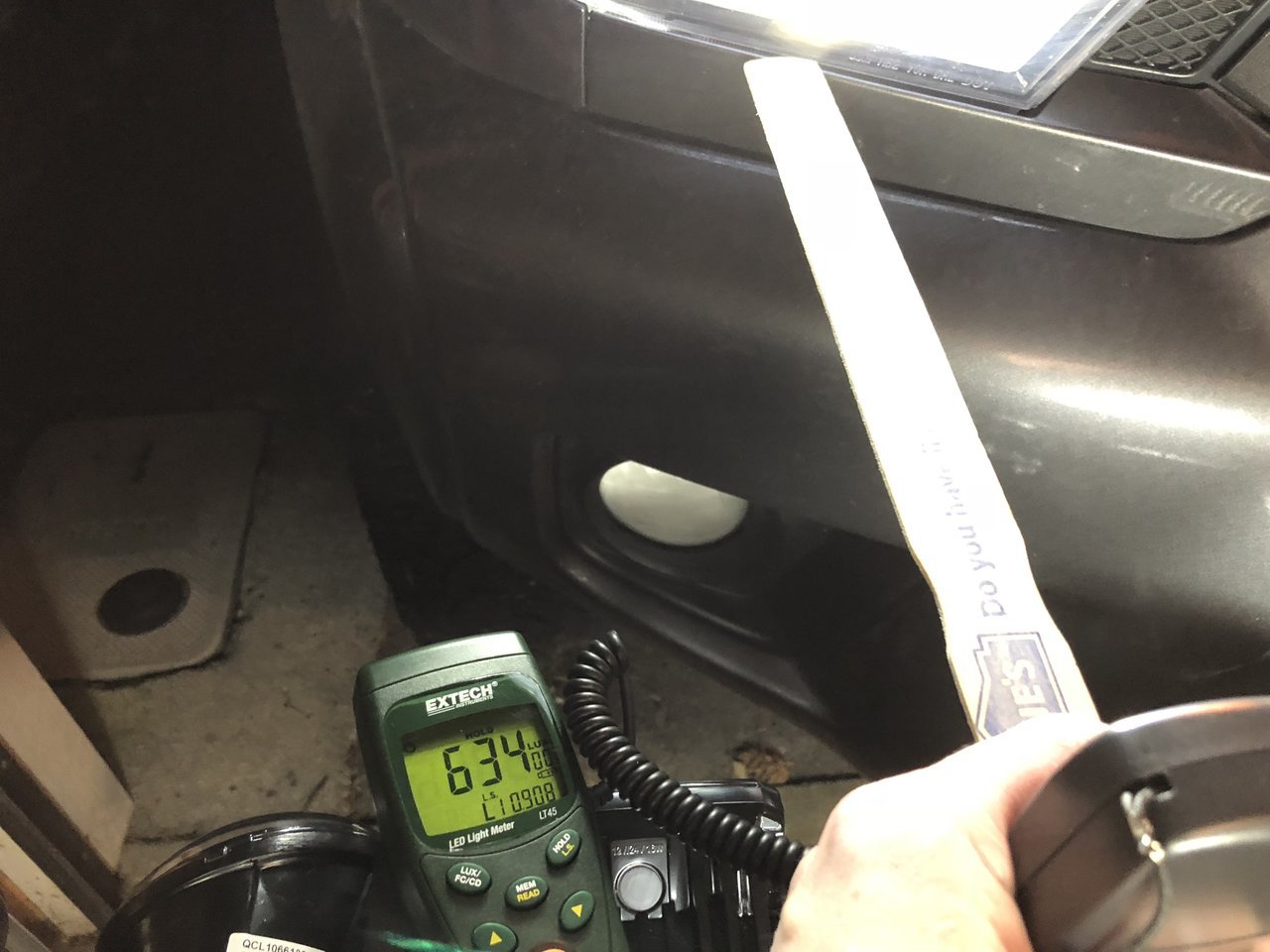

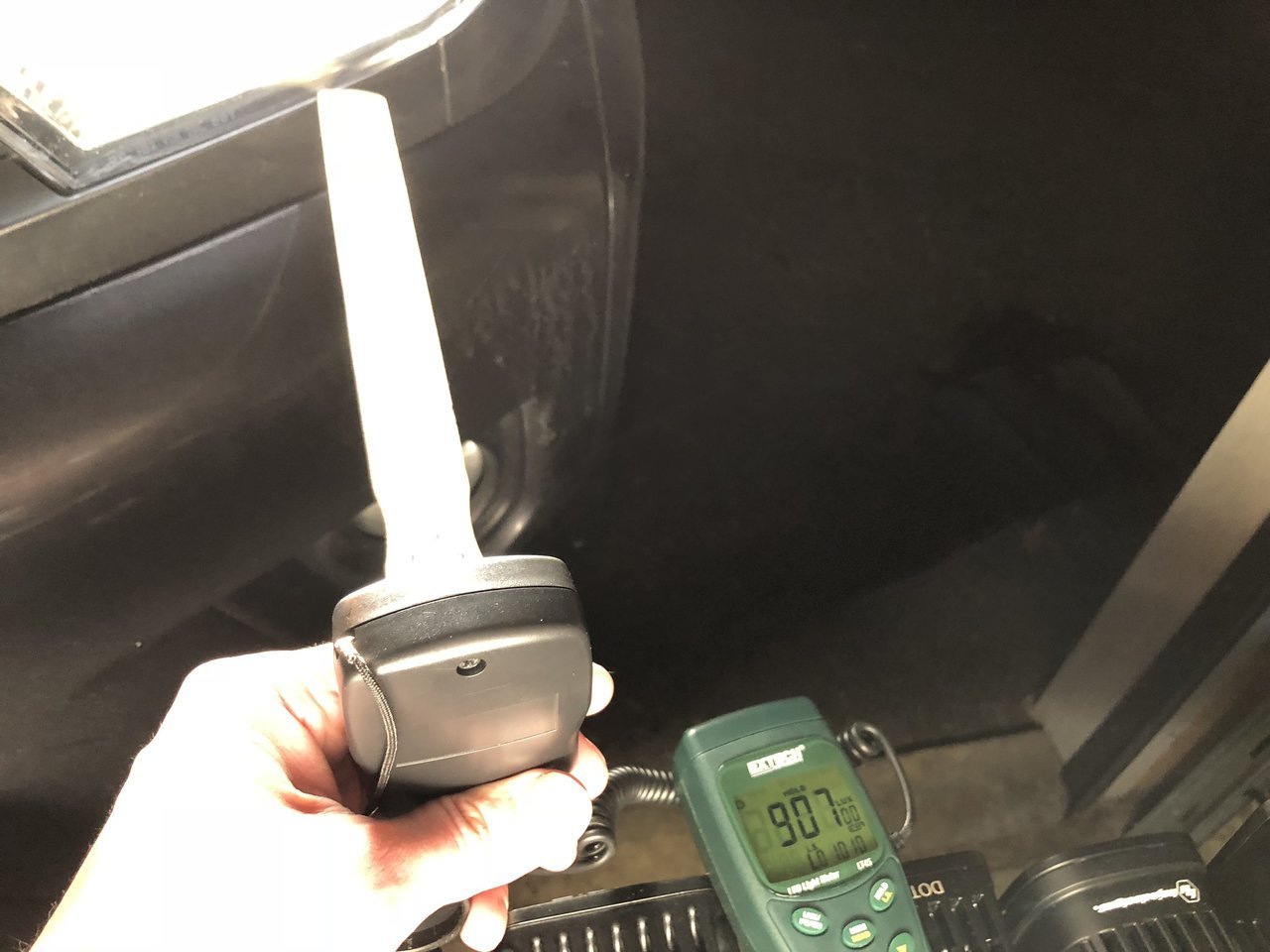

    Working with an LED lighting company, I learned to accurately test output of LEDs, you need a specialized and quite a bit more expensive LED light meter. Traditional light meter makes assumptions that all parts of the light spectrum will be present, so it samples a few points in the spectrum to create a reading, which works in an incandescent light source because they are full spectrum lights. LEDs have significant gaps in the light spectrum they produce, which is why they wash out color and cause a loss of color contrast. An LED meter must be set to take samples at the right color spectrum for the light source for an accurate reading. The readings below are with a professional grade LED meter.
    Here is a 1750 lumen performance halogen, 907 lux (scaled 100x)
    Here is the HIKARI LED, 634 lux (scaled 100x)
    Since halogen bulbs publish factual specs (vs LEDs theoretical ones) you can do a little math to back calculate a very roughly ballpark output estimate. 634 lux /907 lux = 0.7 So if the LEDs put out 70% of the halogens, and we know the halogens are 1750 lumens, then 1750*0.7=1225 lumens. Which I wasn't that far off when looking at their 12,000 lumen claim and said it would be 1500 lumens or less. Now this is oversimplified and doesn't take into account the bad optics of the LED, but it gives a decent ballpark comparison for effective output. For an apples to oranges comparison, a stock H11 halogen bulb puts out about 1300 lumens.

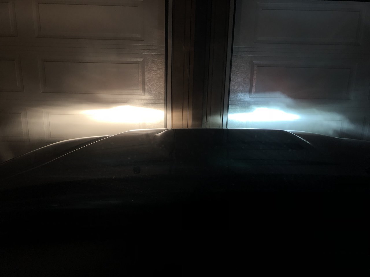

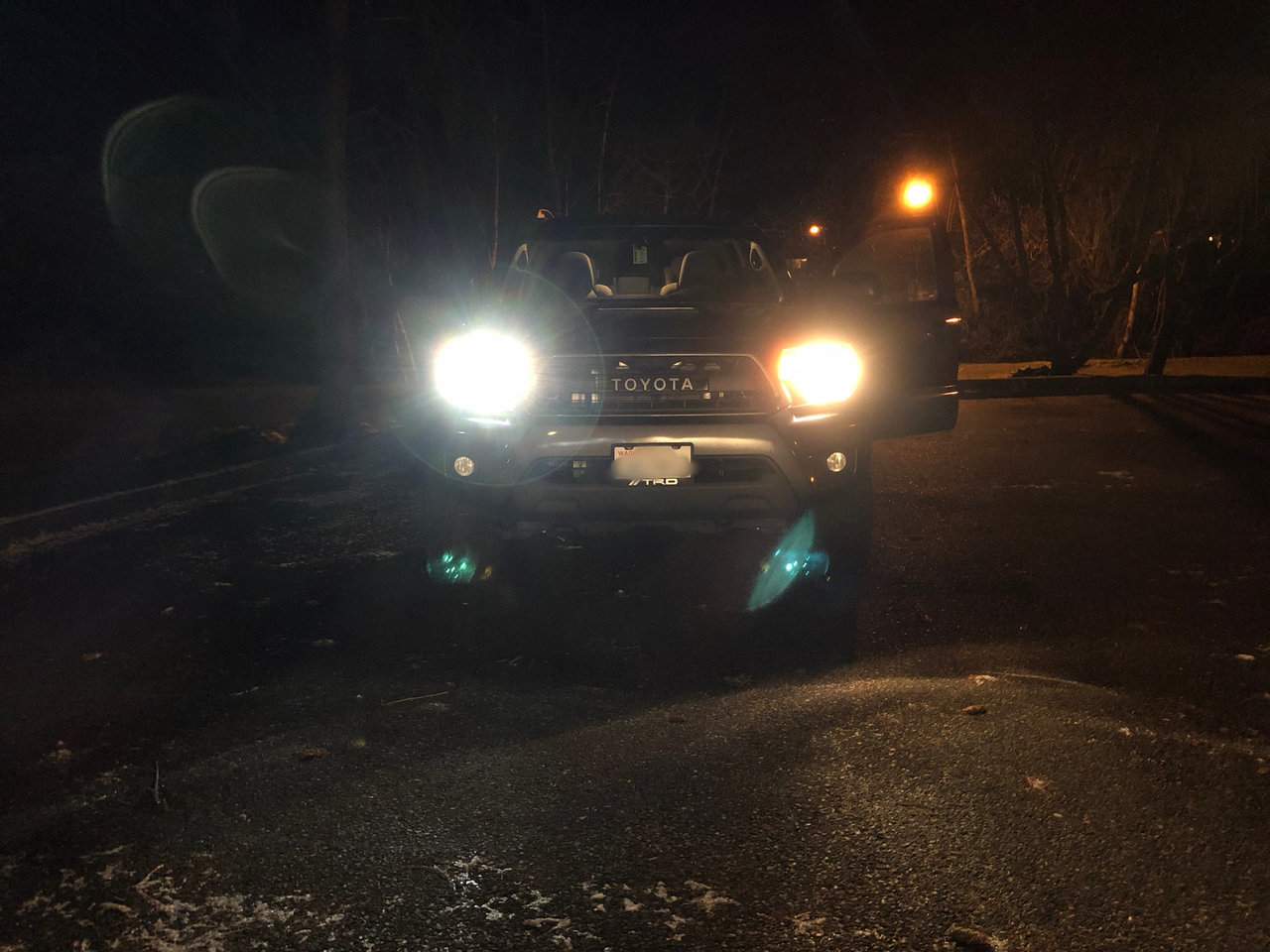

    Here is a less than ideal output comparison shot. Halogen Driver, LED passenger. Practically no passenger side peripheral illumination.
    Now all these photos were taken with my upgraded 1750 lumen H4 halogen headlights. In a 3rd Gen, you can run 2100 lumen H9 headlights that will notably outperform my 1750 lumen H4s, and cost about $15 for the set. Maybe I'll swap back to a stock bulb for another comparison.
    The listing advertises these LED lights as 'DOT Compliant'. They are not. DOT compliance is a self certification program to which a product is designed and tested to meet specific beam pattern criteria as specified by SAE's beam pattern definitions by the company making the product. The compliance classification then is only as good as the company is reputable. These LEDs clearly fail to meet the standard headlight beam pattern.
    I was referring to the H4, 2 diodes are for low beam and 2 are for high beam. Low beam and high beam do not operate at the same time. An H11 does not have a high beam.

    Used the following bulbs:
    194 for Maps lights & the license plate lights
    921 for the reverse lights
    31mm long festoons for the dome light
    7443 for the Brake lights & the turn signals*
    H11 for the Low Beams, High Beams, and Fog Lights
    ??mm long festoons for the vanity lights (I haven't upgraded these yet, so maybe someone else can chime in).
    *Hyperflashing is only an issue for the turn signals (both front and back). All other bulbs are usually a direct replacement. For the turn signals, most LEDs will need a resistor spliced into the turn signal wiring (at each corner) to prevent this. However, there are some brands (such as VLED) that built in enough resistance so that you don't need to add a resistor. You'd have to go search this thread to see which ones worked without resistors.
    Also note that there is more than one type of bulb that can fit into our lights...I just listed the common bulb numbers above. For instance, the reverse/turn signals can also have 7440 bulbs. The Headlights can also fit H8 and H9 bulbs. Also, the map lights can fit 168 bulbs. They all have slight differences, but the base connector is the same.
