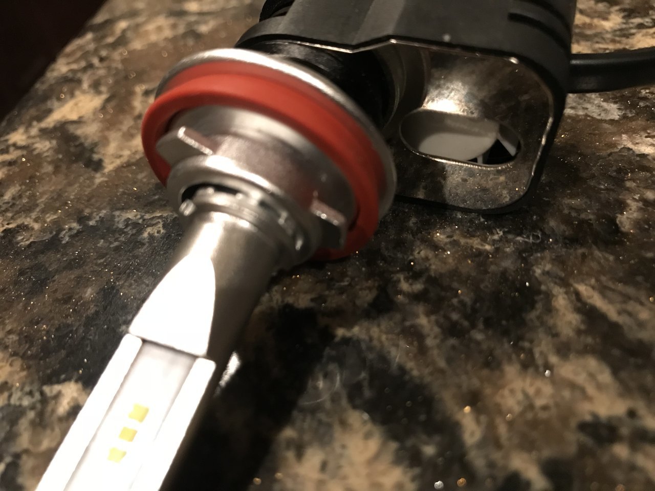

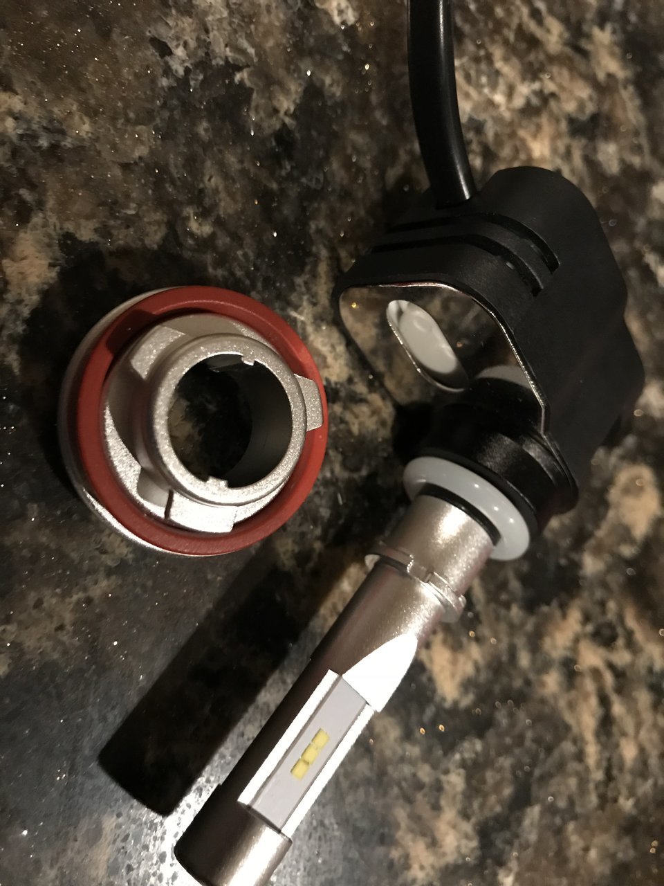

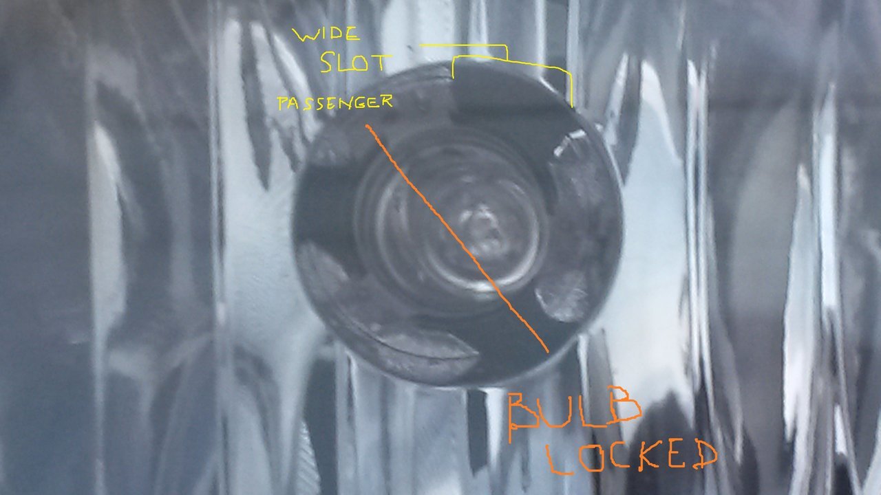

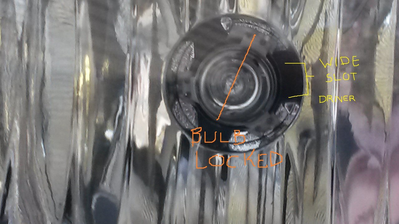

    Hikari Philips. I suggest holding off for high beam use. Found an issue with the Hikari bulbs in high beam housings. In simple terms the wide tang of the lock mechanism is directly in line with the top of the light bulb. On our trucks the high beam wide opening for the wide tang is at 3 o'clock on driver side and 12 o'clock on passenger side. Insert bulb and rotate to lock. The bulbs are not vertical now and cannot be adjusted.
    FIXED PASS SIDE BY REMOVING COLLAR, DRILL NEW HOLE 35 DEGREES FROM EXISTING IN COLLAR, INSTALLED SCREW, INSTALLED BULB. NOW IS VERTICAL.
    The collar is fixed and cannot be adjusted. My bulbs are not completely vertical. The driver side bulb is at 4 o'clock and 10 o'clock. Passenger side is closer to 7 o'clock and 1 o'clock. Removed the bulbs. Removed the collar screws to rotate and align the bulbs. NO-GO. The screws pass through the 2 drilled rubber collar holes into the base in 2 fixed threaded holes. They should be set screws to lock the collar at any rotation. My low beams were perfectly 3 and 9 o'clock in the housings. After measuring the driver side is slightly off 11 degrees but the passenger side is a whopping 35 degrees off with both bulbs fully locked in the housings.

    I reworded my post to clarify the issues and the fix. Worked and aligned properly in low beam housings and now in high beams.

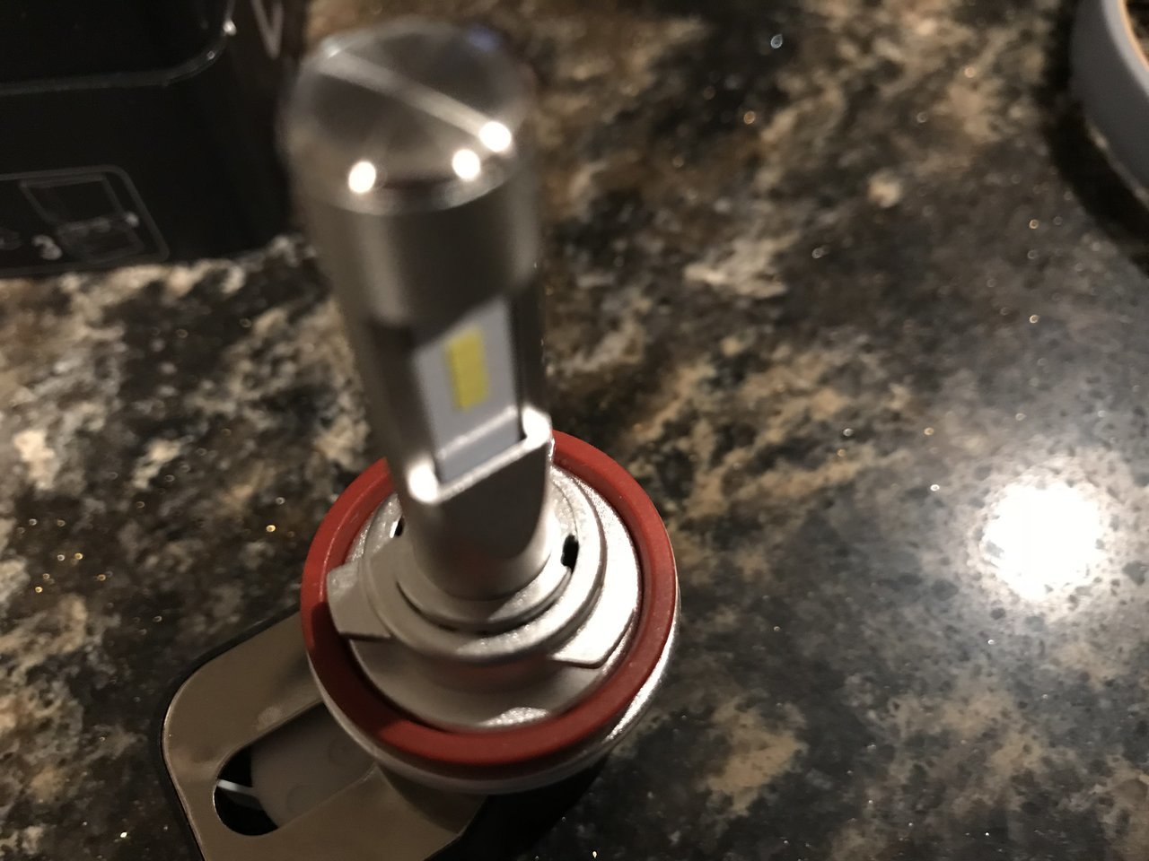

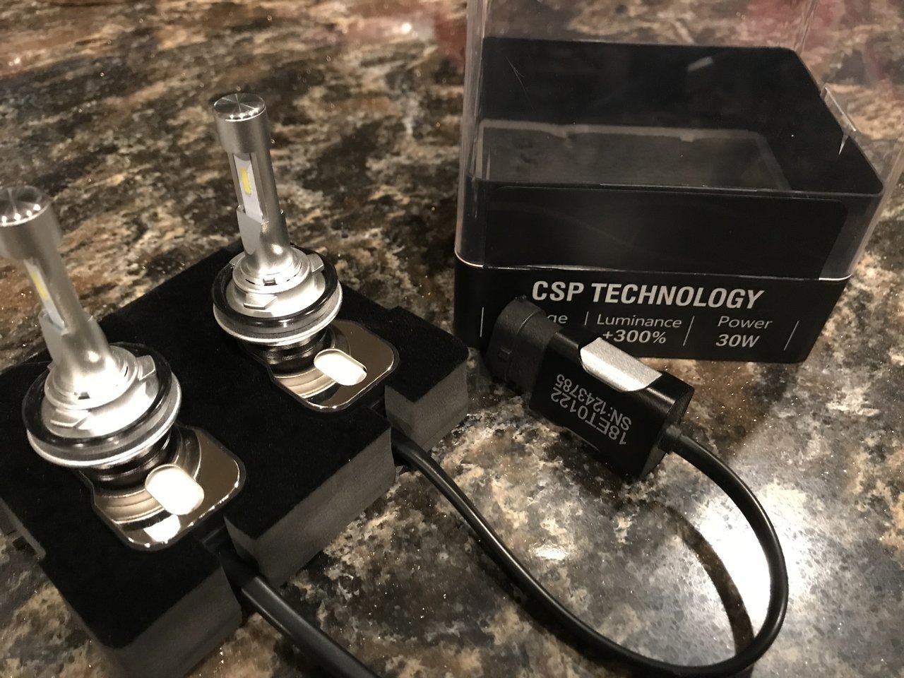

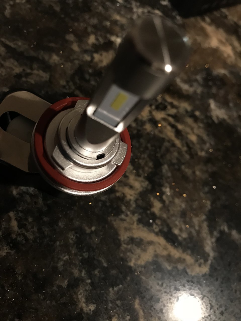

    Really disappointed. They work and look good in my lows. Look directly at your high beams from the front. You can clearly see the wide slot for lights to mount are different on each side. That means you must either use adjustable beam lights or exact fit made different for passenger and driver side. Wonder if auxbeams have a rotation adjustment.

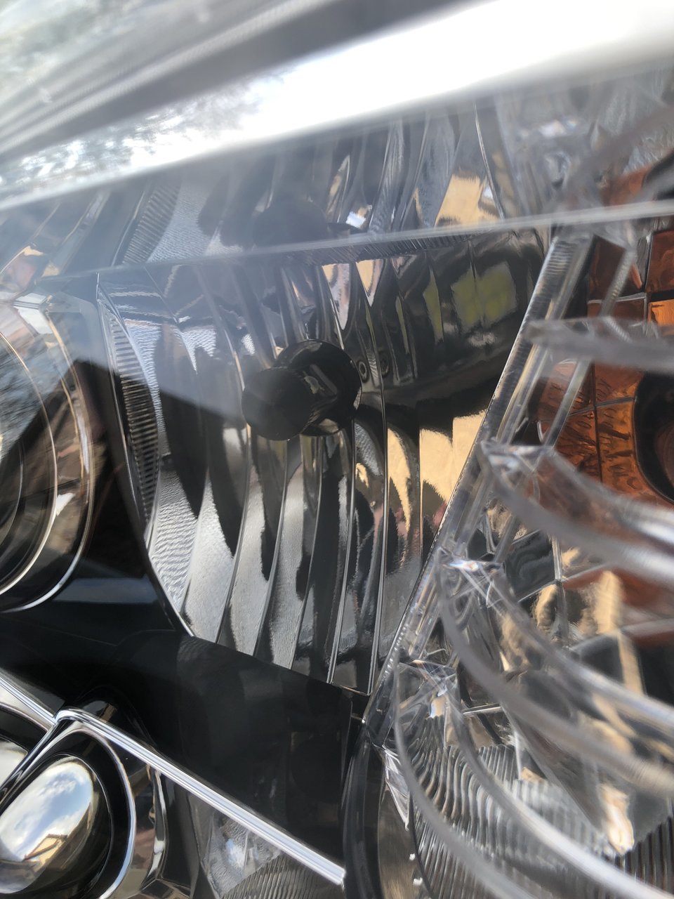

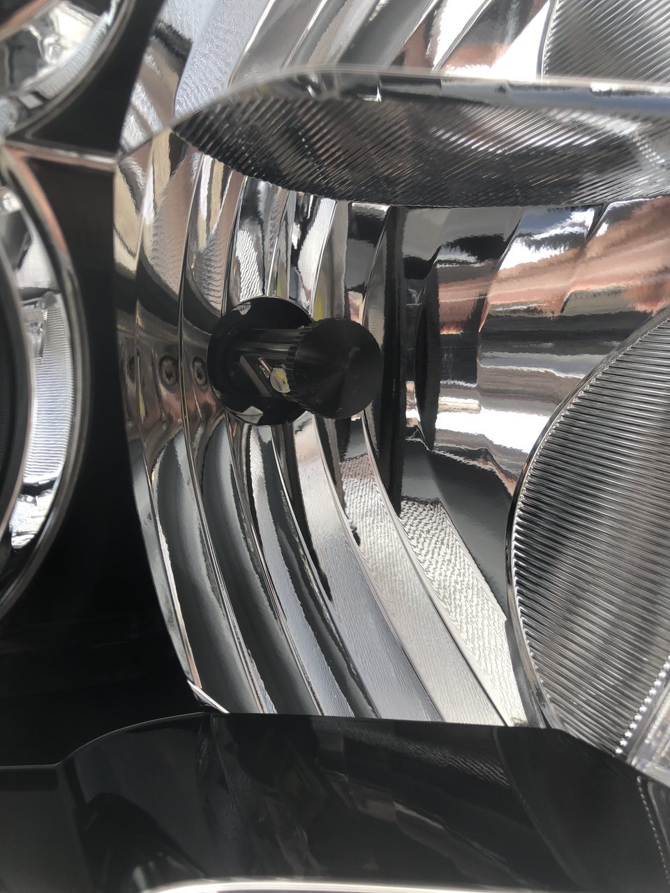

    Here is my passenger side highbeam. I would think it matters more in the projector housing more than the high beam housing since the high beam is just a reflector. Idk though I’m not a specialist.
    All I know is what I can see and for me these in the Highbeams work great.

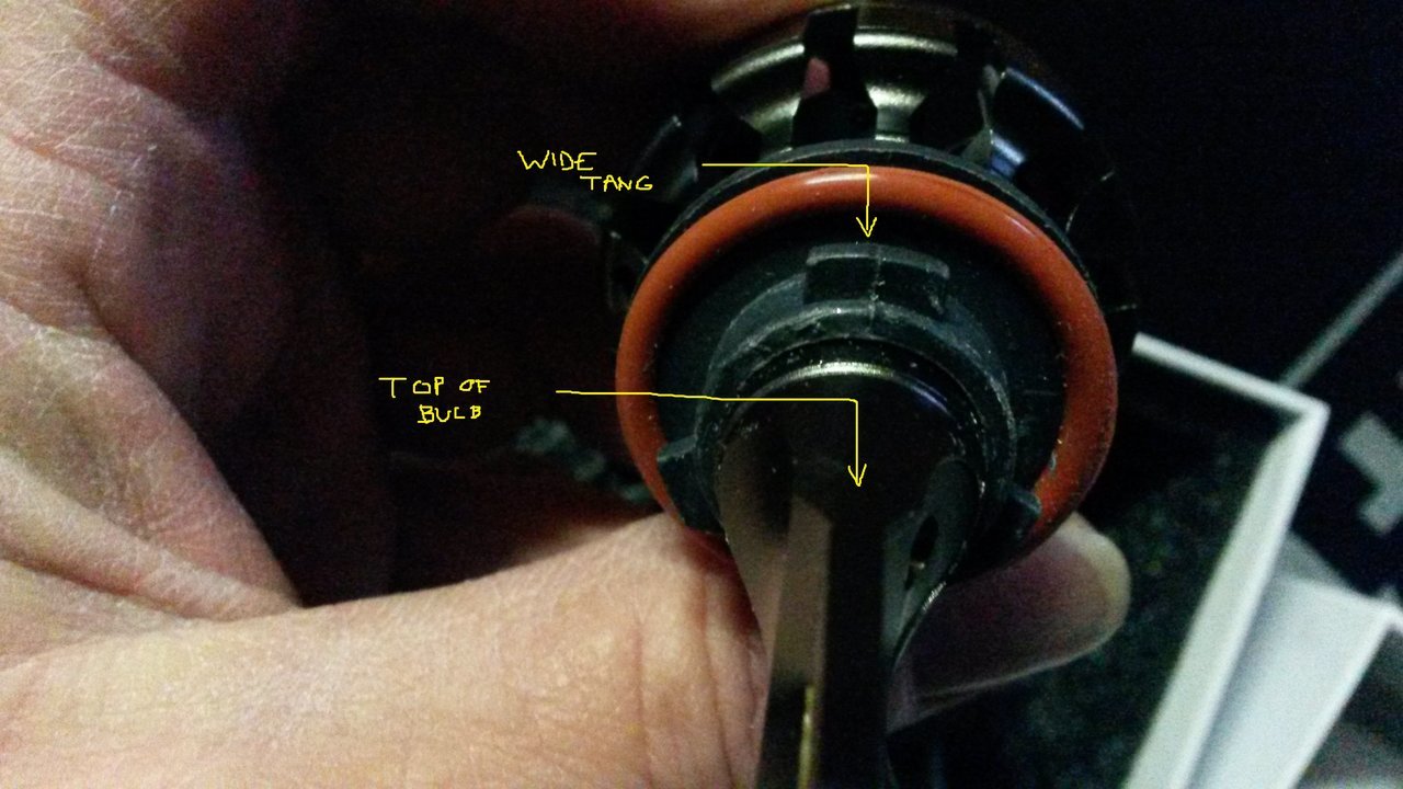

    Problem solved. Installed and dead nuts vertical now. 5 simple steps. First was most important
    1-remove head from ass and regain machinist mentality
    2-remove collar
    3-drill hole 35 degrees from original hole
    4-install screw and collar
    5-install bulb in passenger side
    Will test sometime tonight. That 35 degrees was just eating me up. Too damn simple to fix. Actually punched new hole by hand with a spring loaded punch.
    Hard thinking when head not on shoulders.
