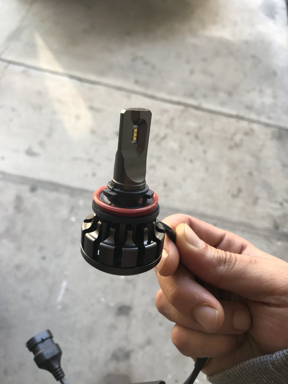

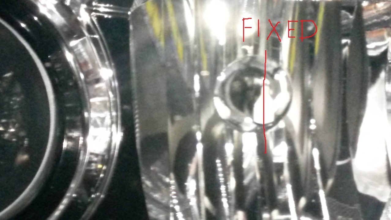

    My HIKARIs are not vertical and the beam appears fine to me. I noted that after my tests. The avg Joe looking for an improvement to the stock halos will be completely satisfied.

    @Parker315 so your Hikari crees sit the same way? Meaning slightly off from correct orientation? I’ll still try them I have them in hand..plus how often are we using high beams anyhow...doesn’t bug me...

    Very cool that you figured this out :thumbsup: :bowdown:
    Did you correct the drivers side too?

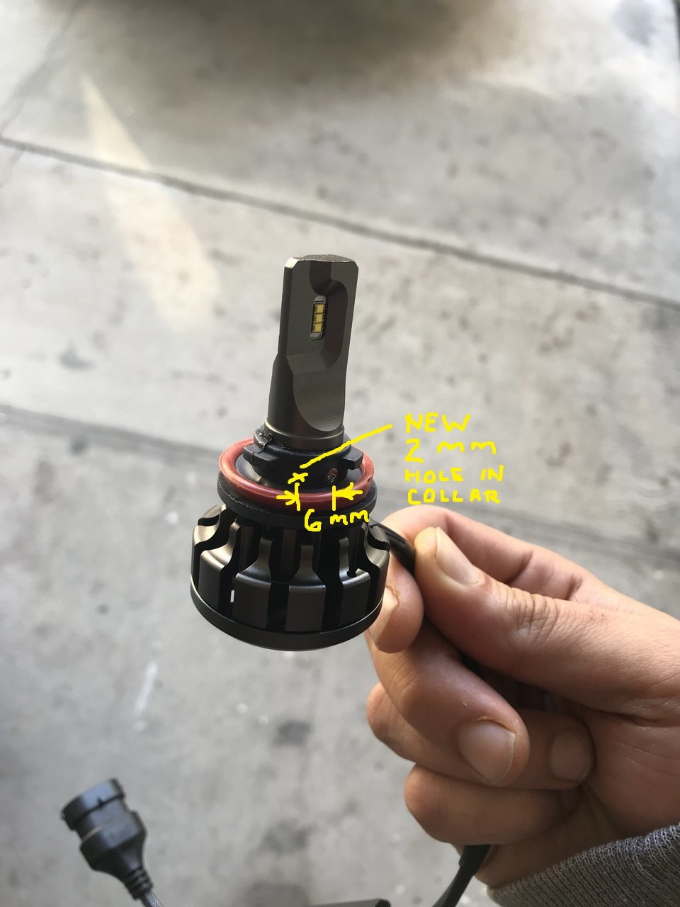

    Not sweating 11 degrees. Would have been ok with both at 11. That 35 got under my skin. Easy fix. All good. Changed prior posts. Very easy fix. Did not drive tonight but look great across back yard. Really should have been correct when delivered. Such an easy fix. Should have fixed as soon as saw the issue. Others state beam pattern ok but just feel better with better alignment.

    I'm glad you pointed out the diffiecncy, because without it I wouldn't know I can correct it to attain the best output possible. I think everyone can benefit from the experience.
    Would it be possible for you to post a pic of what part of the bulb assembly you're putting a hole in? Thanks.

    Yes sir. Exactly... the original Hikari sot the same way. If you want to disassemble your light and drill a hole in them than that issue can be resolved occurring to @mrproduxn though.
    Nice work on your part man. Let us know if they are of long term now :thumbsup:
    Not sure if that’s something I’d take the time to do, but some others might.

    That's good news, @mrproduxn! I'm glad you fixed the angle of the that bulb and that it didn't seem like it was too difficult to do. I have a feeling that it will be an issue with any bulb that we put in the HBs (that does not have an adjustable collar)...so we may need to reference your 4.5-step approach. :D :thumbsup:

    Looks exactly like my Hikari Philips. That little screw is in the collar hole I moved on mine to make it align at 3 and 9 o'clock in passenger high beam. Just popped out the 2 screws and slid off the collar, drilled, re-installed.
