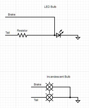

    Most LED's will cause issues like that because of how they are connected internally.
    Dual filament incandescent bulbs have 2 individual elements that are each connected to ground, the one is brighter (higher current) the other is dimmer (lower current).
    Many LED's have a direct connection for the bright circuit and the dimmer circuit is connected through a resistor to a common LED or LED's and thus will backfeed voltage from one circuit to the other.
