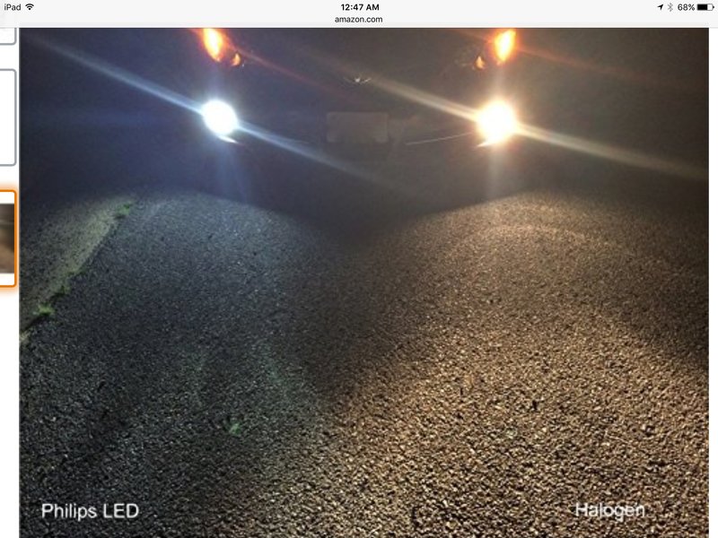

    image.jpg This photo (from Amazon and I assume provided by Philips) seems to support the idea that the LEDs are visible when looking at them... But don't provide better visibility for the driver. Looking at the ground in front of the vehicle... You see more ground on the halogen side.
    The frustrating part is I carry a LED flashlight at work and it is far superior to my older halogen version.

    I had a rental '16 Corolla with factory LED low beams, and they looked great. Tons of throw, even lighting, I honestly thought they were HID until I looked it up online.
    It has everything to do with the projector/housing being designed for LED. If it is you get excellent performance. If it isn't, not so much, as lots of people on here have attested to.
    However, the '16 Tacoma stock projectors seem to work pretty great with HID from what I've seen browsing this forum. I plan on replacing the halogen bulbs as soon as my truck gets here.
