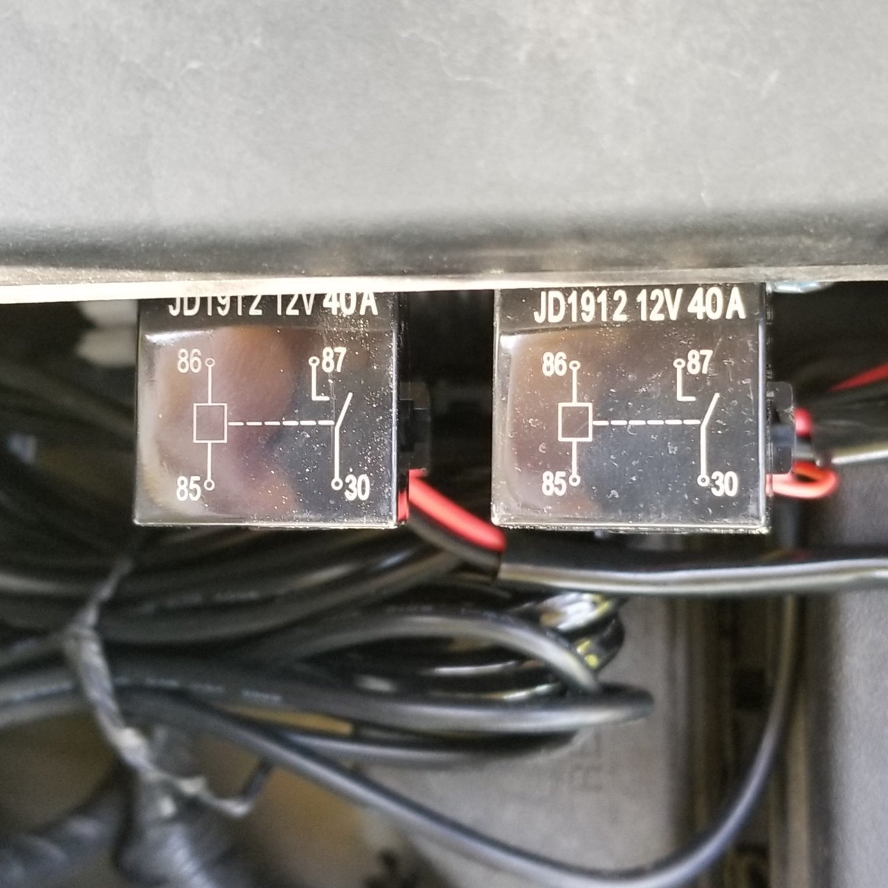

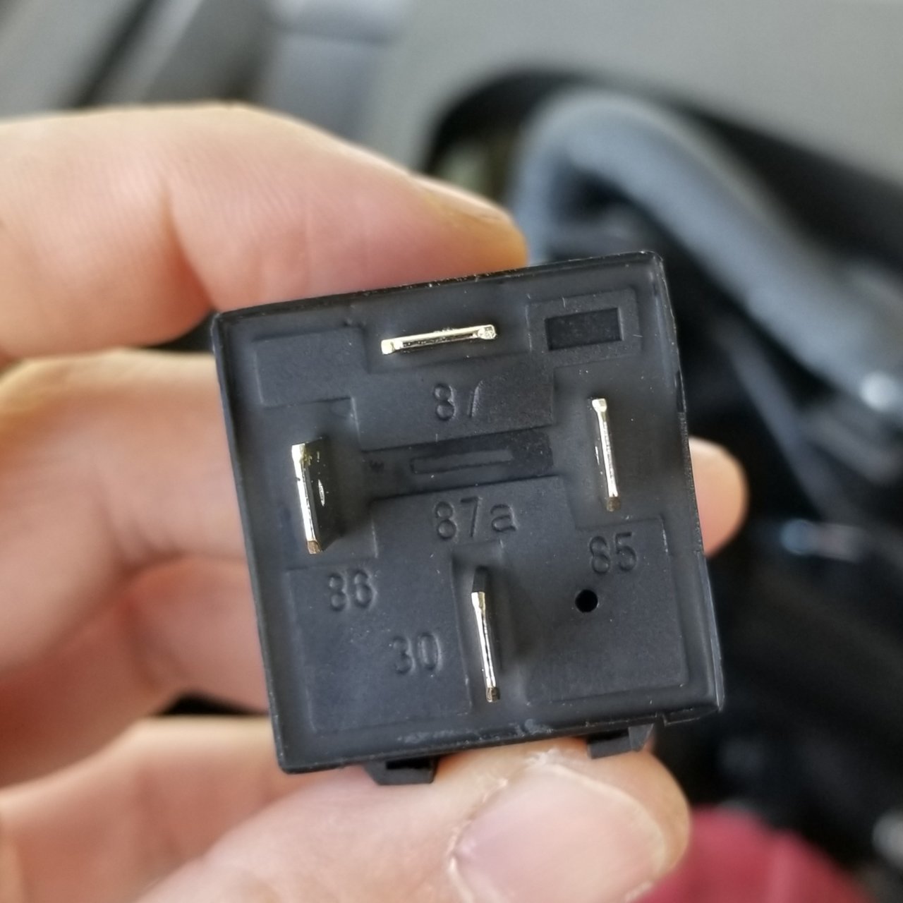

    Try to swap green and red wire from switch.
    Eaither under or top of the relay, there should be number indicated on each terminal.
    Green -> 30
    Red 1 -> 85
    Red 2 -> Option 1. You can also hook it to 85
    (both letters and icon of switch illuminate when switch is on position)
    Option 2. tap into source of oem switch illuminating
    (this is what I did so letters illiminate when other factory switch illuminate & icon of switch illuminates when the switch in on)
    Option 3. leave it as not connected
    Black -> ground

    Wire colors of relay may differ as other brands/seller used different colors of wires. This video will be very helpful for people who buy exact same relay tho.
