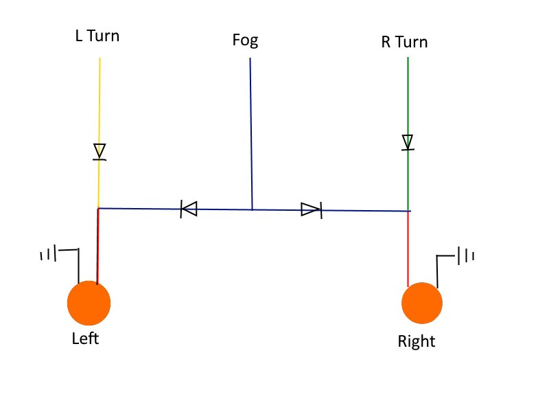

    Yep, just need to wire a few diodes in,4 to be exact.
    Did it on my fog lights.
    Here's a quick diagram I made up.
    Fog lights would override the turn, so would need to keep that in mind.

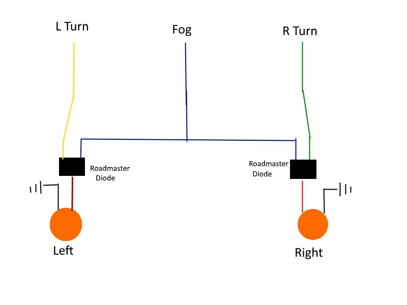

    I soldered my own, but you could use 2 of these to make it easier.
    https://www.amazon.com/Roadmaster-7...VHI?psc=1&SubscriptionId=AKIAILSHYYTFIVPWUY6Q
    I updated my drawing for if you wanted to use the Roadmasters diode.
    Connect the positive side of the light to the output of the Roadmasters.
    Connect the switched power wire for the foglights to one input on each Roadmaster.
    Connect the L Turn to the other input on the left side Roadmaster.
    Connect the R Turn to the other input on the right side Roadmaster.Fog Turn2.jpg
    Hope this helps.
