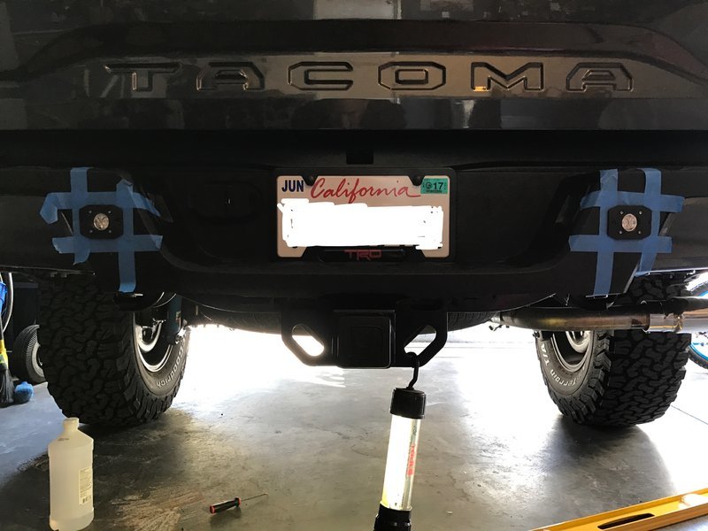

    Let's see some pics of how you guys are mounting led's in or on the factory rear bumper on 3rd gens. I was wanting to flush mount some but it doesn't look possible with the thick plastic bumper.

    3,161

    You're welcome. The back up cam image refocuses brighter but not blinding.
