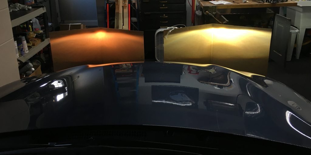

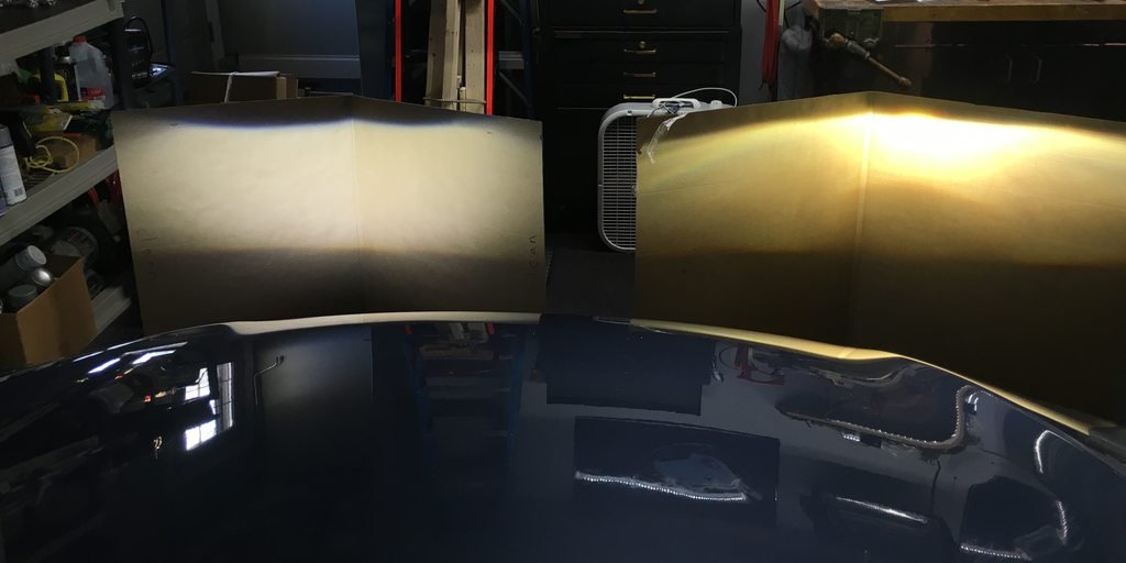

    I have halogen projectors in my Subaru, and replaced those with HID. The light output is immensely better than stock while retaining a good cutoff line. LEDs are garbage and lack the hot spot to throw light farther down the road, so maybe that's where your informant was confused.

    I'm running the Xenon Depot HIDs with the upgraded Phillips bulb at 4300k.
    Bear in mind this is in my Subaru, but you get the idea. Here's LED vs HID. You can see how it lacks a hot spot for throwing light down the road.
    Here's OEM vs HID.

    The HIDs in that pic are 4300k, which isn't too white, but gives you the most useable light. I believe 5500k is a pure white like the LED in that picture if that's the look you're going for.

    I would strongly recommend going 4300k. From inside the truck, it still has a fairly white look (more so than OEM) but the light output is amazing. High beams barely make a difference now.
    I have the xenon Depot with the upgraded Phillips 4300k. Ran me about $200 and well worth it
