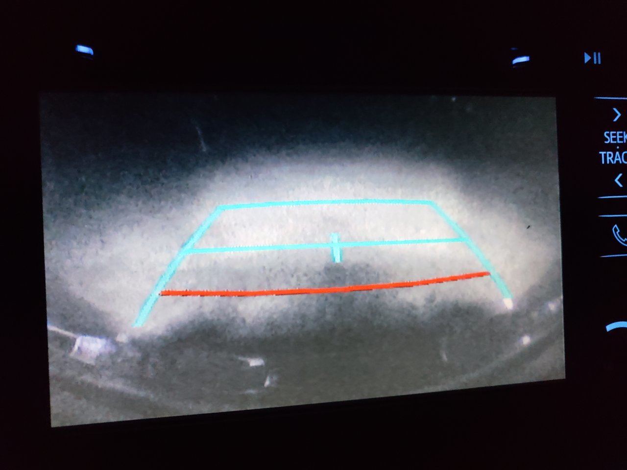

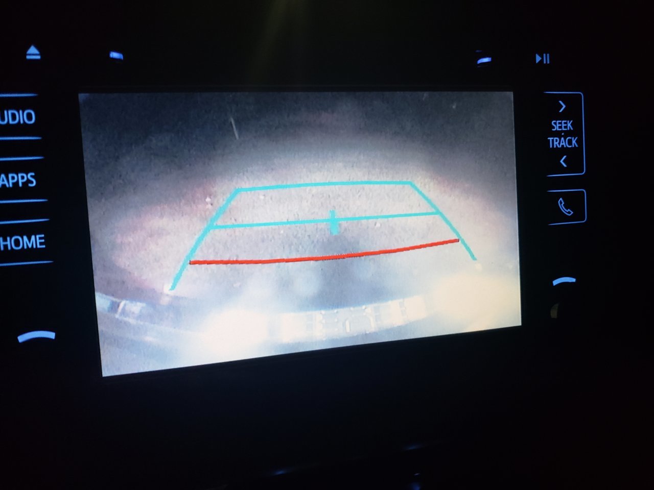

    I really like the fresh clean look of leds on the outside of the truck so I got these bulbs look great but getting alot of glare on my camera. One picture is them on second I covered them. Do I take them out tweak the camera, find a way to shield the light some how. Thanks all

    I noticed the same, with the lights covered so there was no light coming above the bumper, the glare was a lot less. I'm thinking a shade on the plate light fitting so the plate gets illuminated but the camera lens doesn't

    Your saying you notice the same glare in both my pictures?

    No, just the first picture, a lot of glare from the license plate lights. However, the backup lights tend to wash out the cameras night vision bad also. I'm going to do the anytime camera mod soon, may install a front camera as well

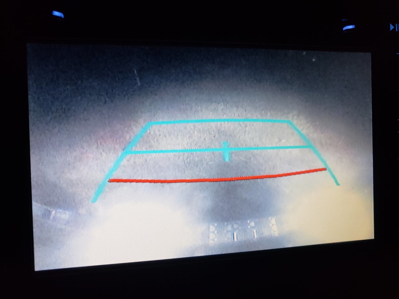

    This is the latest bulb has the leds on the side instead of the front better but I would still like it to be less.
