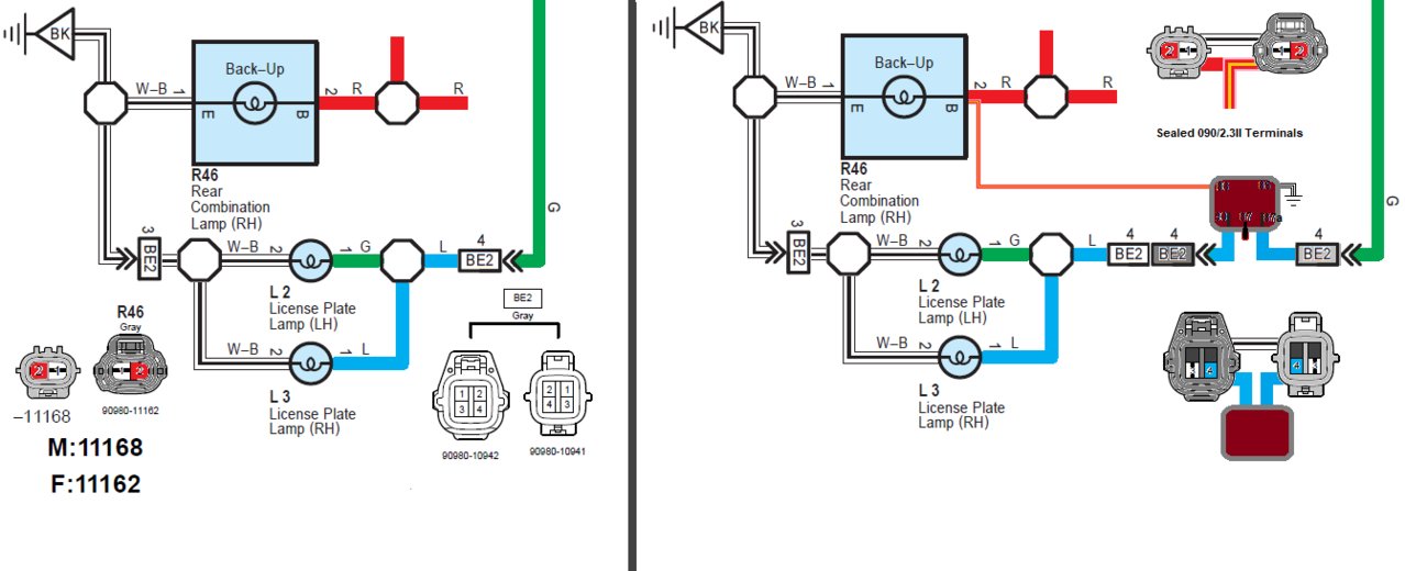

    I know it's been awhile since I was last in the forum but finally got around to installing the switch. I bought a "normal closed" switch from Amazon. Tapped into the 2 lights and the reverse light. So when power is supplied to the switch via back up light, the switch opens and cuts power to the 2 license plate lights. Since I was under the truck, I also installed a 6" LED bar light under the bumper with the back up light. HUGE difference without the glare from the license plates lights. I can take some picks if anyone is interested.

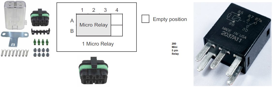

    Give me a week, and I will post a plug-and-play solution. Something @caribe makaira and @daveeasa cooked up.

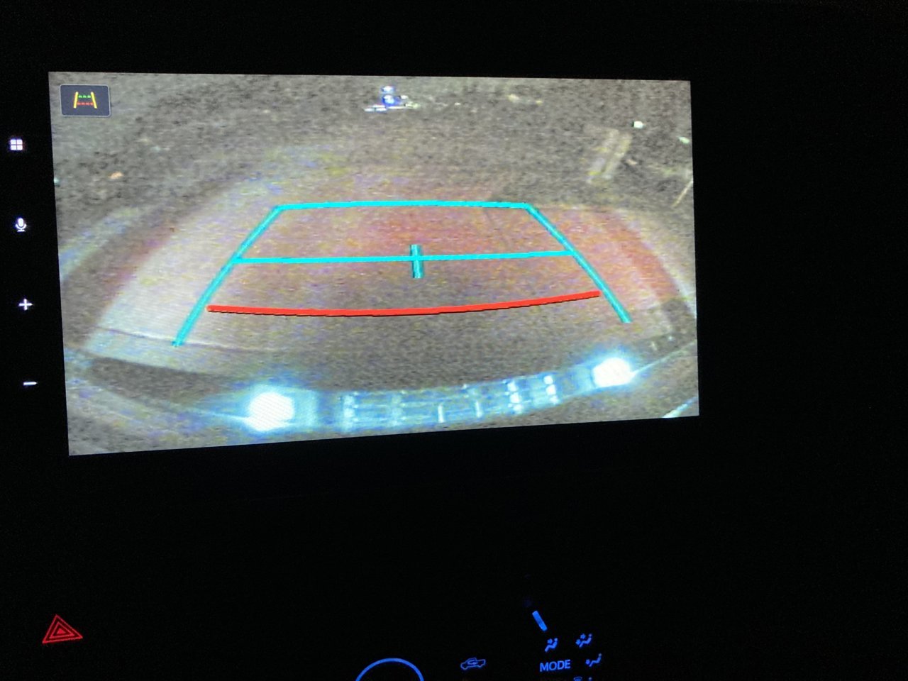

    I feel like something is wrong with your camera. Lens moisture on the inside maybe? This is what mine looks like, and I also have LED license plate lights.

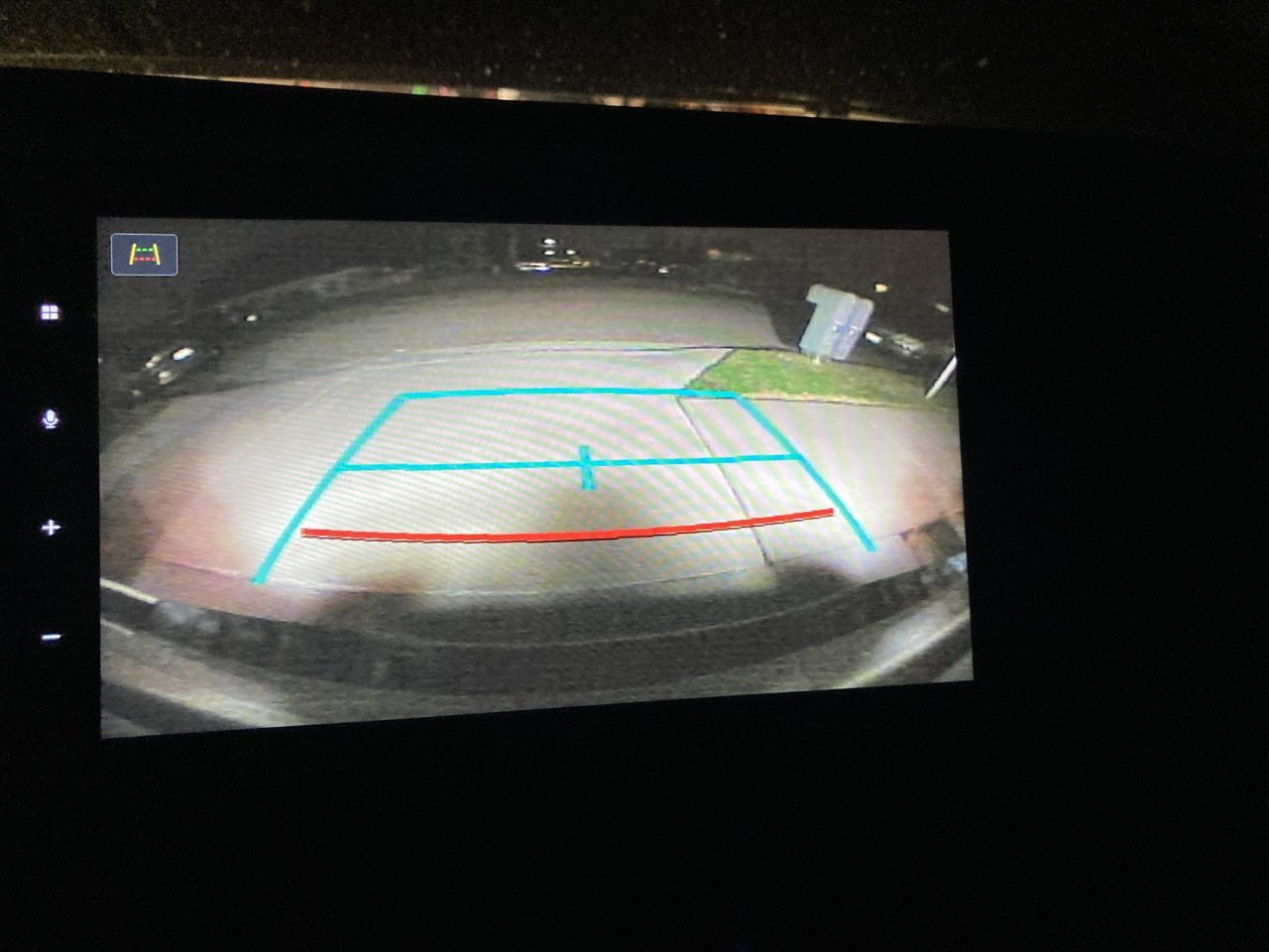

    @Puppypunter gets the W on this one. Well done sir.
    Rear camera in 1st gear:
    Rear camera in reverse:
    Granted the MESO total tail bulbs help a lot by illuminating the road behind the tailgate.

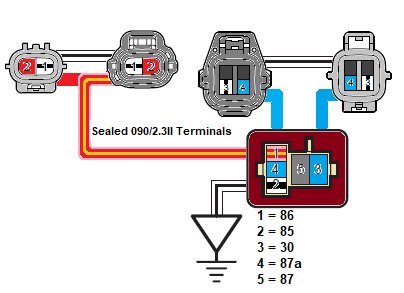

    You could wire the plate lights to a Normally Closed relay, then have the reverse lights shift the relay to Open. This would shut off the license plate LED when you are in reverse.

    daveeasa
    daveeasa FBC Harness Solutions
    May 14, 2020
    #328079
    7,482
    David
    PNW
    2016 Tacoma OR DCSB 6MT, 2005 RC 5MT PreRunner, 2002 Tundra SR5 RCLB 4x4
    Option #1 does not eliminate the possibility of option 2 :)
    ^^ See link for deets on the harness.
