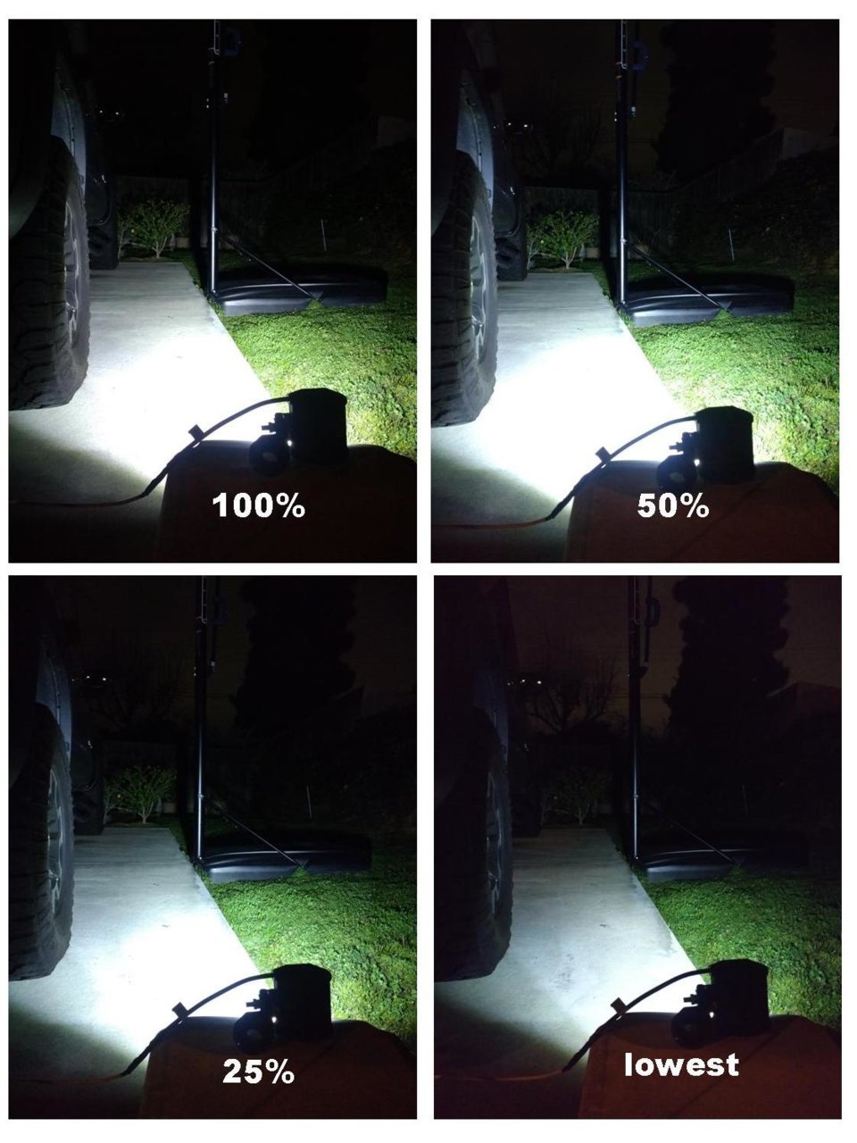

    Here are photos of the light output:

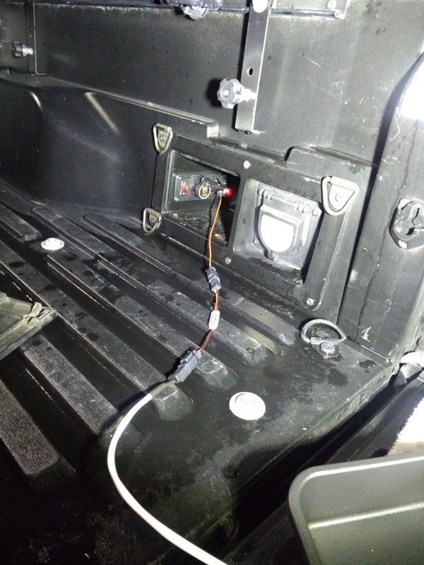

    This is all connected to my 12v bed outlets
