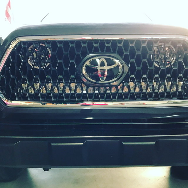

    A53C8C5F-DE43-42B0-BA2A-801636812D98.jpg I mounted Pro6’s behind the grille.
    I used the SQHD light bar bracket.

    That’s perfect! Do you have a link by chance? Want to make sure I get the right one lol
