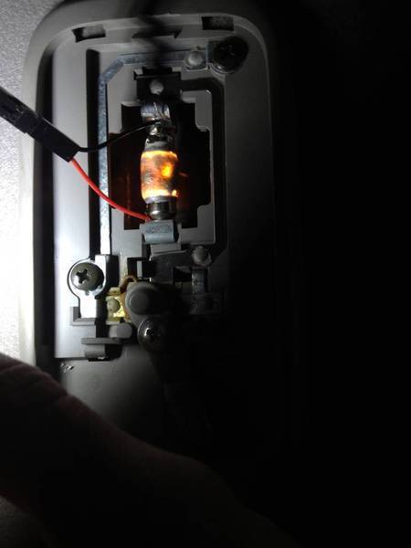

    Ok, here is my dome light.
    [​IMG][/url][/IMG]

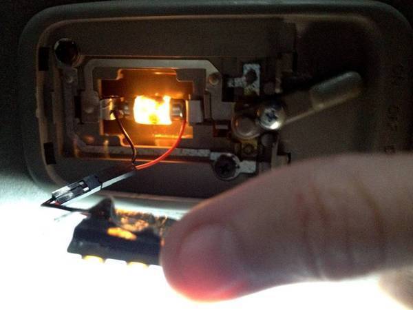

    One more look.
    :cool:
