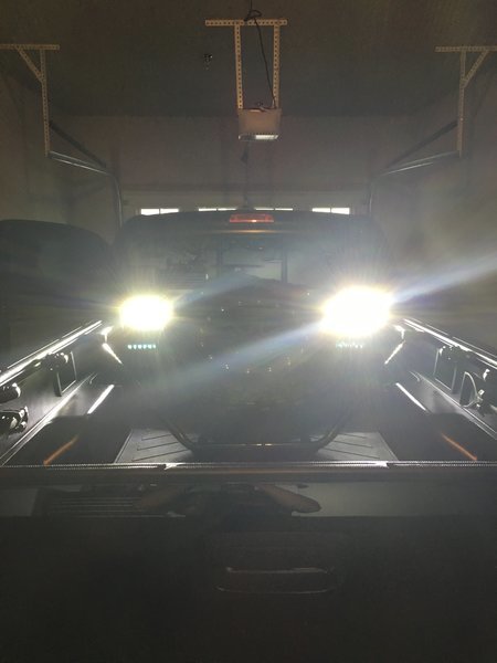

    hey guys. I have a pair of MicTuning 8in LEDs on my rear bed and i just hooked them up and they work great but they are emitting a small amount of "whine" when turned on. My front CaliRaised light bar does not make this noise. Just curious what it could be?
