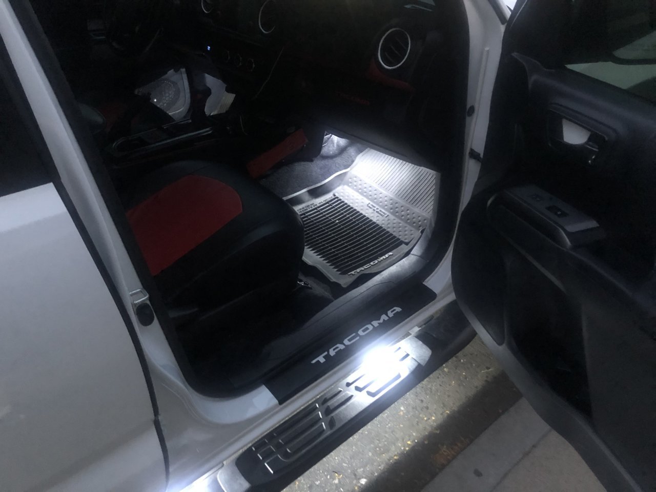

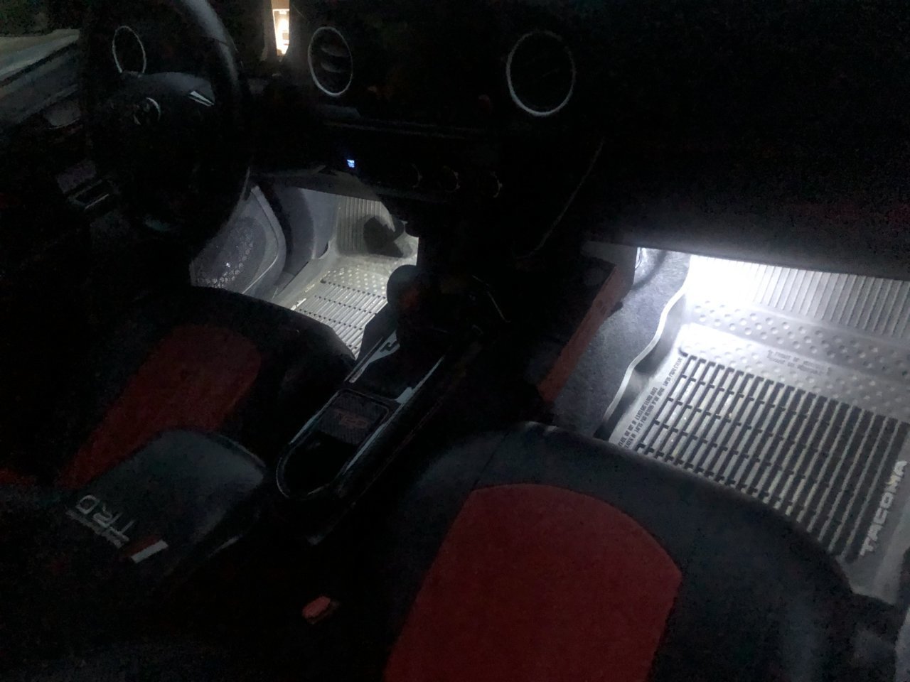

    Completed this project over the summer. Works perfectly.

    no just tapped the blue and yellow wires in the drivers side A-Pillar as @Porroquio and @caribe makaira talk about earlier in this thread.
