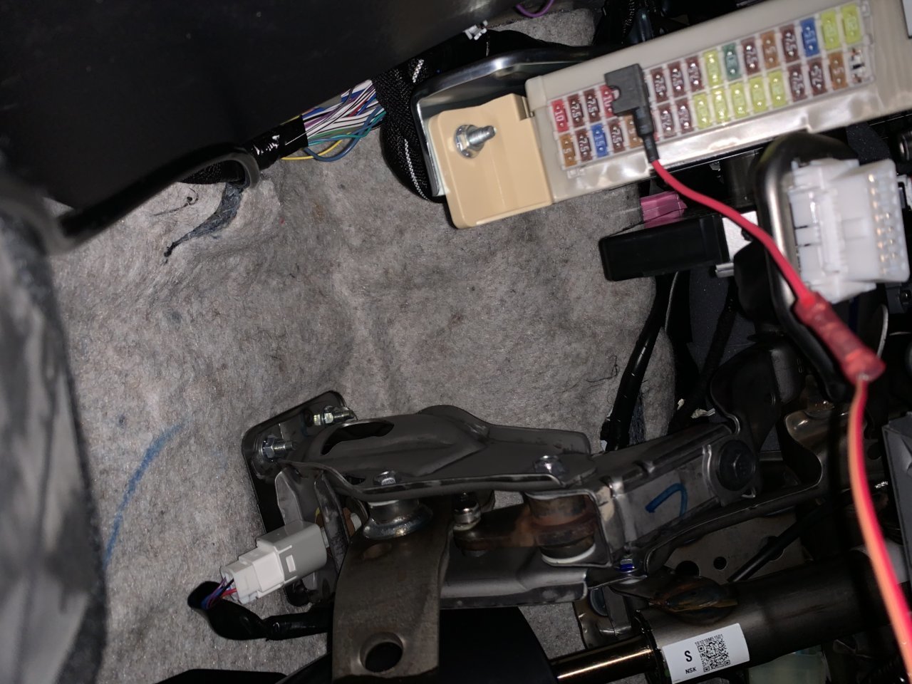

    I just put on pod light and the led switch won’t turn off after I put it into the fuse box under the panel , could it be I put it in the wrong fuse ?

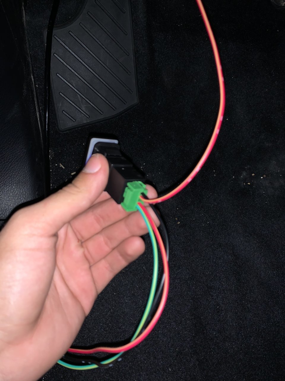

    There is 4 wires and I bought a part that has a fuse connection with a wire to connect to the 4 wire and the part comes with to fuse inlets , does that mean it has to have a fuse ?

    This is the switch

    And that is the fuse adapter that has 2 fuse connections and the 4 wire is going in there and it says it’s suppose to turn on when I turn on lights

    Which fuse circuit is it plugged into?

    I plugged it into an open slot and I also tried with a5 and when plugged into a 5 I put the fuse in the adapter with cable

    left hand column, second from the top. TAIL. Plug it in there

    Do I put the fuse into the adapter as well ?

    Yeah. The adapter should have two fuses in it.

    It has 2 open slots so I would put the one you mentioned and there would be one open slot , do I leave that slot open or buy a fuse to put in it and if so what fuse?

    You'll need to buy a second fuse. Get another 7.5 to go in there. Once you unplug the adapter, does the light on the switch turn off?

    The green wire, and the red wire directly next to it. Swap those two.
