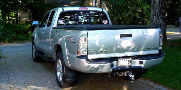

    * AFE Stage 2 XP CAI System * Westin Platinum Series Black Step Bars * TruXedo Lo Pro QT Soft Roll-Up Tonneau * Dee Zee Heavyweight Truck Bed Mat * WeatherTech Extreme-Duty Floor Liners * WeatherTech In-Channel Window Visors * Sony Xplod CDX-GT81UW Receiver * Sony Xplod 2-way speakers * Boss Audio BASS600 Amplified Subwoofer * Billet Grille Mod

    Those look nice. I went with some Depo lights off of Ebay
