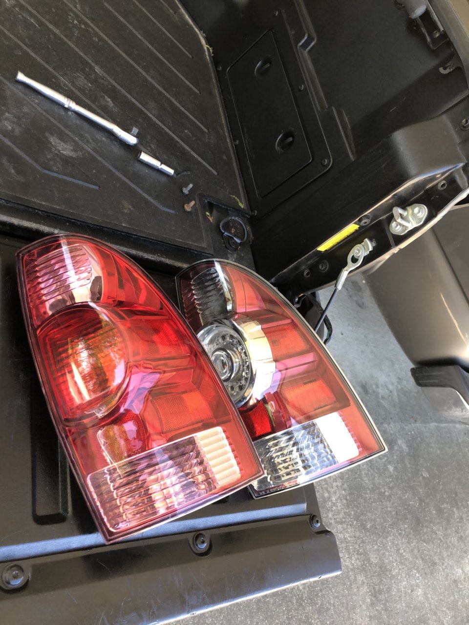

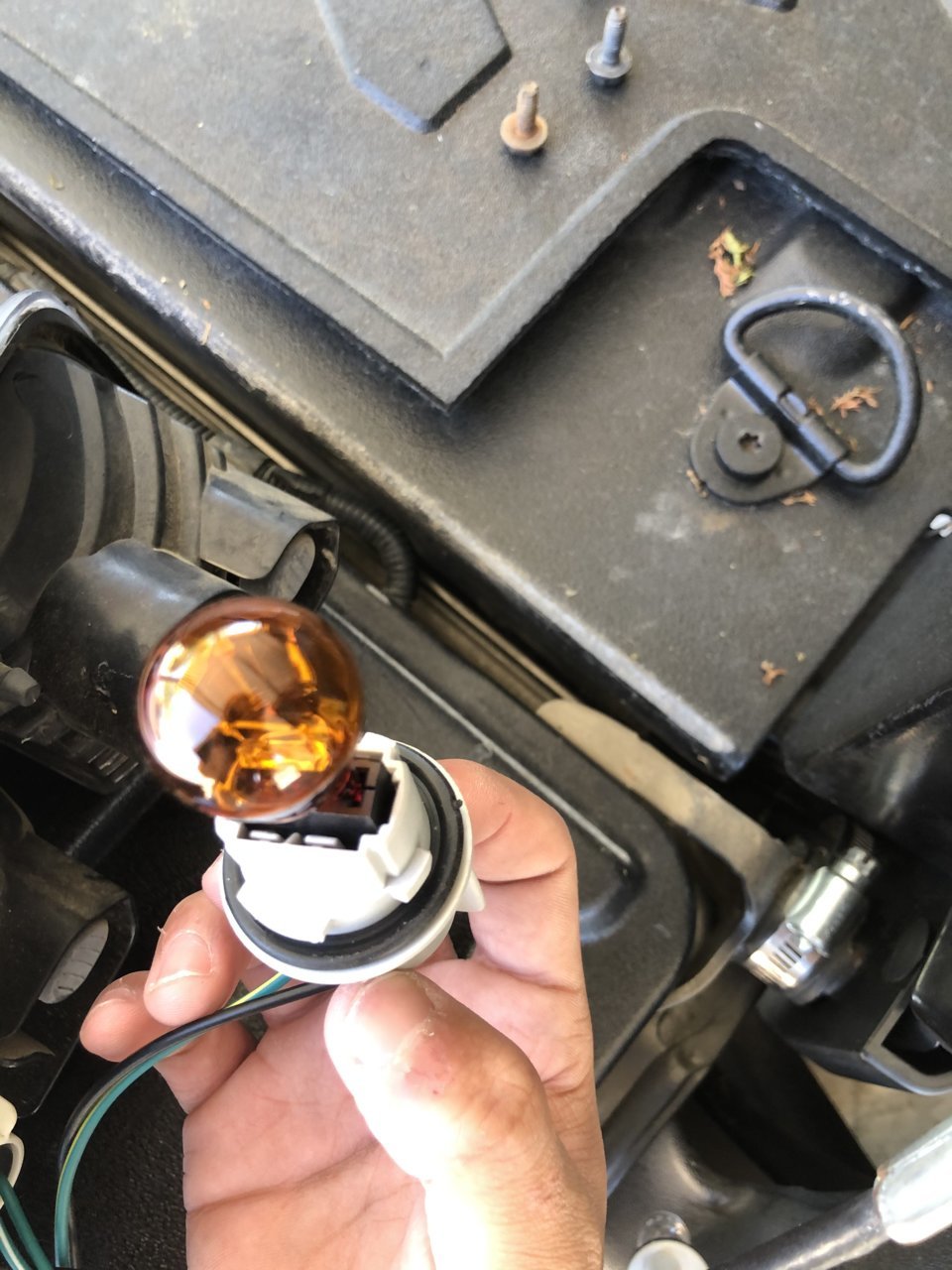

    okay guys, do any of yall know where to buy the harness with the sockets that fit on the factory led tail lights??
  7. Apr 30, 2020 at 9:35 AM
    #27
    TheBigGuy
    TheBigGuy [OP] Active Member
    Jan 7, 2020
    #315381
    37
    2013 Toyota Tacoma PreRunner
    this bulb socket wont fit on the factory led's tail lights pictured up there^ it's like the grooves are too small to fit the socket because i twist and turn it and it just doesnt fit. but they fit on the all red base model tail light (thats what my truck came with) and i had bought these factory led's ones bc i like them better but it didnt come with the sockets or harness on them because i thought i could reuse mine..

    I was under the impression that they were identical. Are the replacements OEM?

    thats what i had thought as well! but yes, factory. i bought them off a guy who had them on his truck but he got upgraded ones... but he just gave me the tail light without the harness/sockets.

    the led's taillights dont have the sockets.... when i got them from a guy it was just the tail light itself. no sockets or bulb came with them.. the incadescent tail lights are the ones that were already on my truck so yeah those have the sockets. but those sockets dont seem to fit on to the holes on the new led tail.

    I know this thread is 9 months old, but to make sure there is an answer ...
    I was looking into this for my own conversion. I noticed that some aftermarket tails mention "not compatible with factory equipped LED tail lights".
    That seems weird.
    I pull off my factory 2015 LED tails. The sockets look the same as my old 2006 tails that I converted to aftermarket LED tails. But to be sure I'll do some more investigating.
    I come across this thread. While there was no definitive answer, it got me looking in a different way...
    I found on a Toyota dealership parts website...
    Socket & wire for tail lights without LED: 81555-04150
    Socket & wire for tail lights with LED: 81555-04160
    So there are two different wiring harnesses for these.
    Now what I'm not sure of... What are the differences? Will these both plug into all 2Gen Tacoma harnesses leading back into the truck? And if they do plug in, will the systems behind everything function correctly?
    That I will have to test with a friend with a 2006 without LEDs stock, before I order my tail lights. We can swap one tail & harness and test.
    I'll update this post if they work or not, but it may be a few weeks.
    Given I installed aftermarket LED tails on a 2006 without LEDs stock, I can confirm aftermarket LED tails would work without a harness change.
    It's the LED OEM tails that have different sockets/harnesses is what the trouble is.
    But hopefully you're already found a solution.

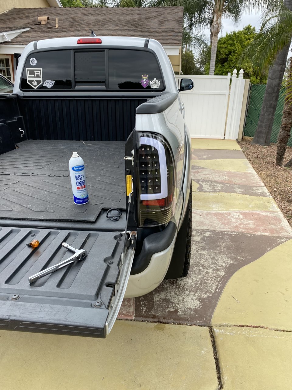

    Just put these on. Had the LED factory ones on 2013 and it was simple swap of harness. Fit great with no issues.

    I just got these same tail lights (red lens though but should be same electronics inside). My '15 harness didn't fit which is kinda expected. @Ramp021996 are you saying you bought the 81555-04150 non-LED harness to make yours work?
    I found on my '15 that all the light functions work but the top light socket (amber/turn signal) doesn't fit into the new housing as the shapes are different. If all I need to do is buy the 04150 harness I'm going that route. Here's the connector that doesn't fit to show the shape:
    Hole on the aftermarket lights - notice they are smaller and different offset than OEM:
    OEM light housing:
    Some other reference photos if anyone is interested:
