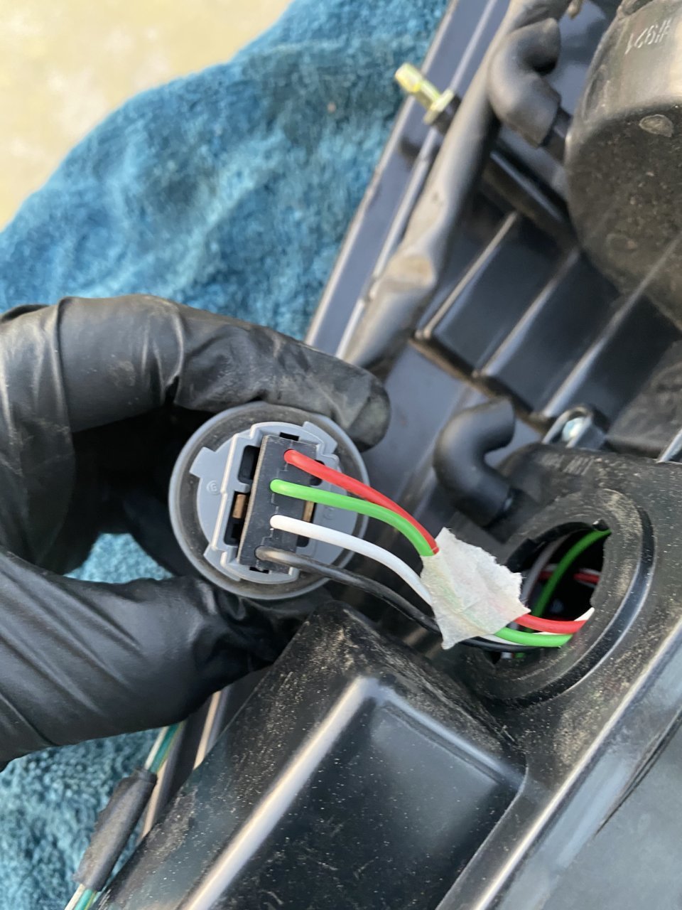

    Coming back to confirm that the Toyota 81555-04150 "non-LED" tail light harness solved my issues and allowed me to install the Spyder units. Here is a comparison of the harness plugs - OEM "LED" variant on the left, "Non-LED" 04150 variant on the right.

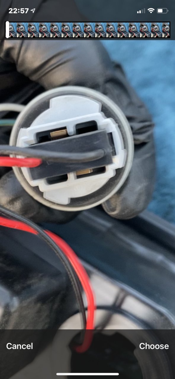

    Here’s photos of my harness that fit just fine in the lights. 8C1DBD5F-F1AC-4E69-B36A-15075E10AAE2.jpg
    wi_taco likes this.

    Great thanks, that matches the 04150 harness that worked on mine. Very odd that some trucks have them and some don't even with the same OEM LED tail lights. Basically added $50 to my light swap project but still worth it to me now that I'm done with the ugly stock units.
