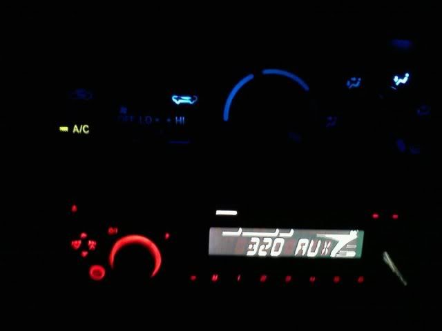

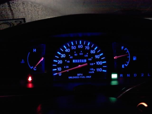

    I did my gauges/ ac controls/ dome light(noo pics of dome light)
