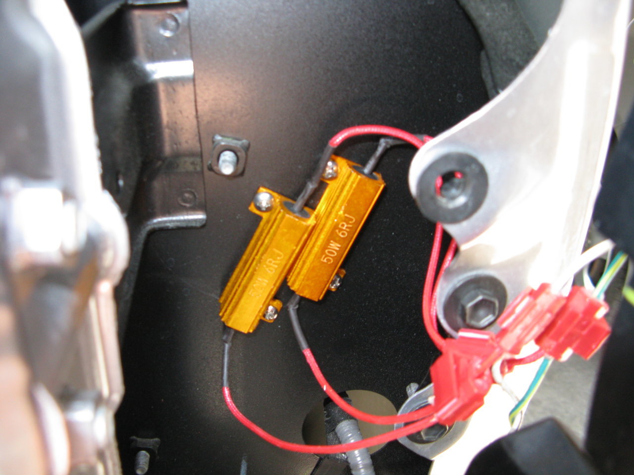

    This doesn't answer your question (I think your resistor is installed wrong)..... I installed multi - function LED's front and rear (including high mount stoplight, front markers, license lights and interiors) soon after buying my 2015 Sport, fronts were switchbacks (3157 - CK's), I have DRL's that I never turn off.
    I installed two resistors per side on the bulkhead behind the rear taillight using stainless screws. Using an infrared temp thermometer, resistors did NOT heat up with parking lights on (including fronts - DRL's on). With turn signal flashers on, (about 4 minutes) the resistors got to about 155 degrees (hot to touch, but no hotter). The metal bulkhead they were attached to helps to dissipate the heat and no wires are near enough to be affected by the heat. Trouble free for seven years.

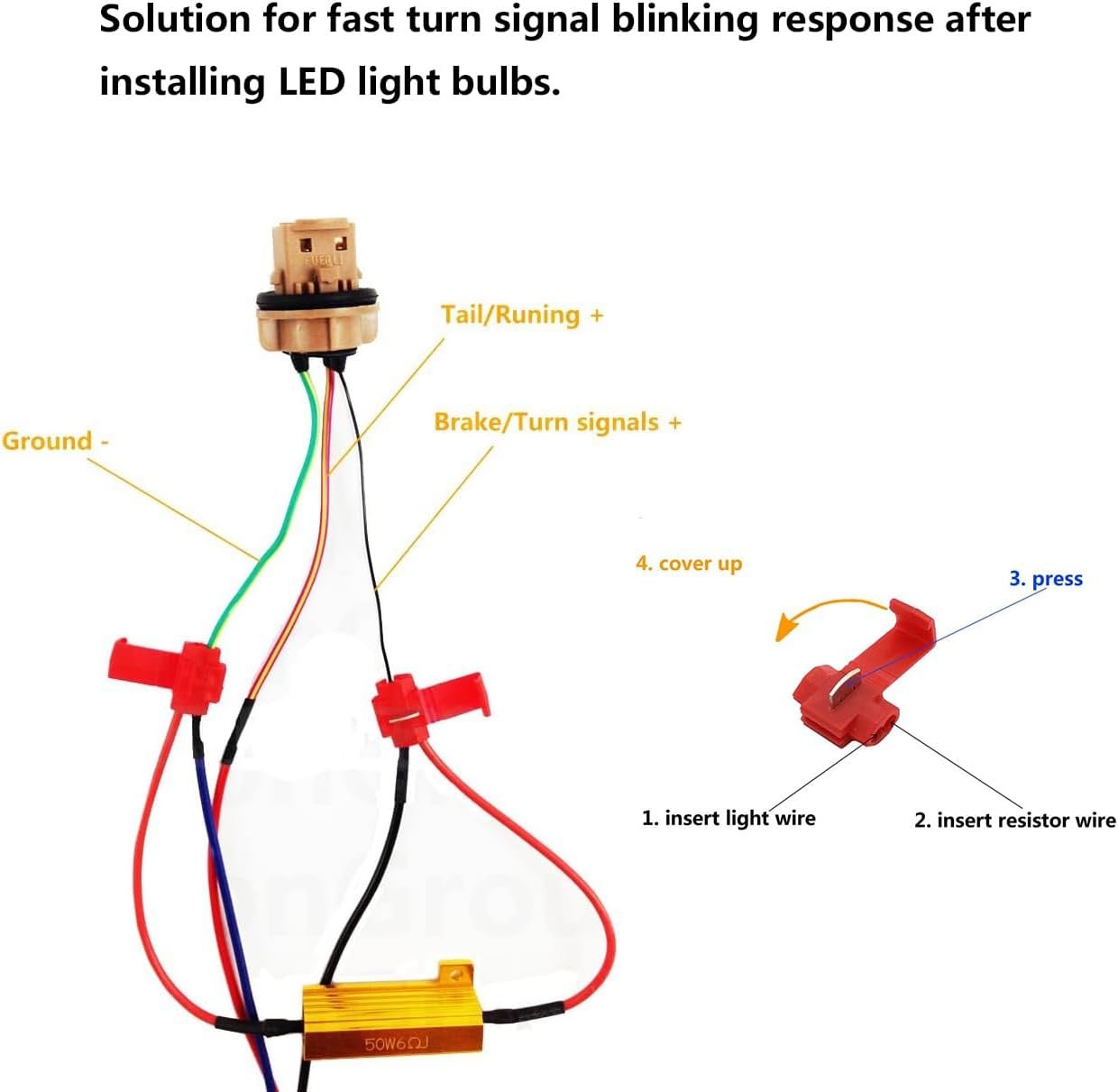

    The one on the Tacoma. The drawing is for a led lamp for a rear facing lamp on a towing trailer. That's why it reads Stop/Turn & running lights.

    From what I am reading, you need one resistor per LED light? Looking at the load resistor wiring diagram, you can have LED daytime running lights with no heat to the resistor until you use the turn signal. 61AZic-UDCL._AC_SL1307_.jpg

    A month or two ago I wired up the same cheesy resistor shown as shown. I believe it only heats up when the turn signal is on as Firefighterdan suggests!
    No hyper flash anymore!
