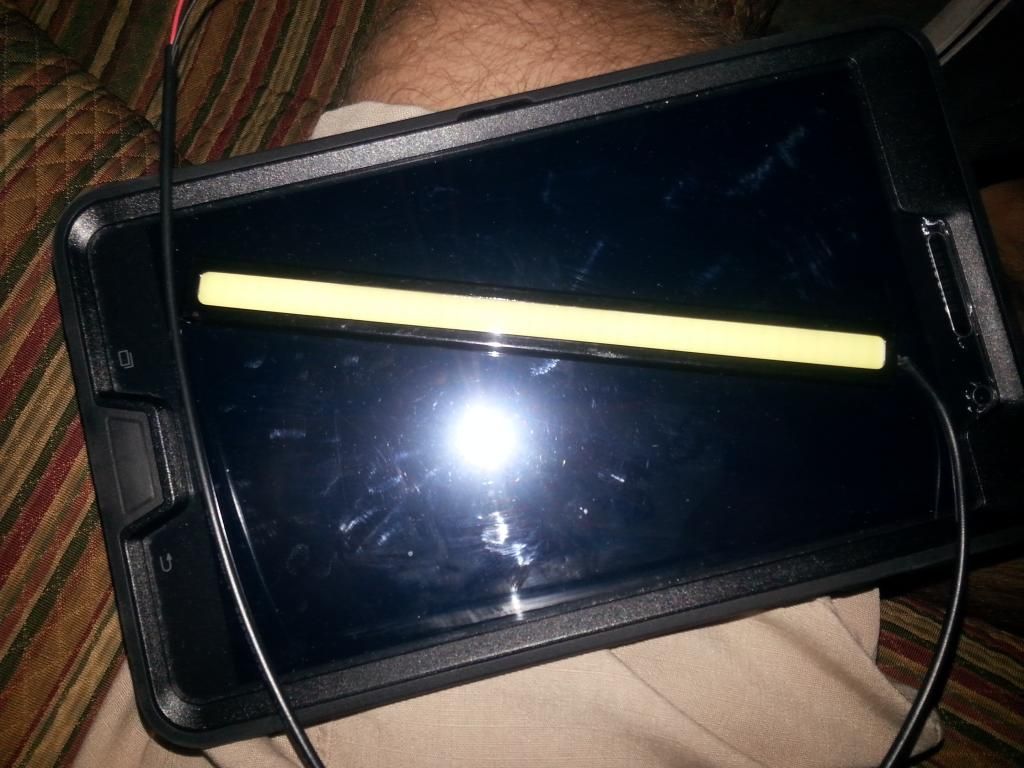

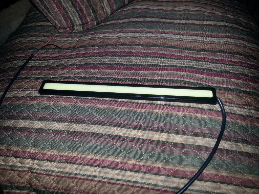

    I picked up a bumper for my truck and had an idea for turn signals since the stock location isn't an option anymore. I want to use 2 ( maybe 4) of these COB led lights.
    I want to mount them on the angled tubes and possibly the main tubes as well.
    My biggest question is how do I make it so they don't blink too fast, what size resistor or should I use an LED flasher? They are 6 watt 12v LED's.
    Any suggestions or ideas would be greatly appreciated!

    You can pick up the typical load resistor all over.. Should work just fine.
    You could also pick up an adjustable led flasher from superbrightleds.com and tune the flashing to your preferences.

    Oh I didn't know they have 'adjustable' ones!:)
    Or to make it really simple, auto store carried a generic led flasher that I popped in and done. Only thing with that though, which isn't a biggie for me, is the flasher sometimes doesn't cancel out properly so when you activate it again it'll flash quickly the first time then continue flashing normally.
