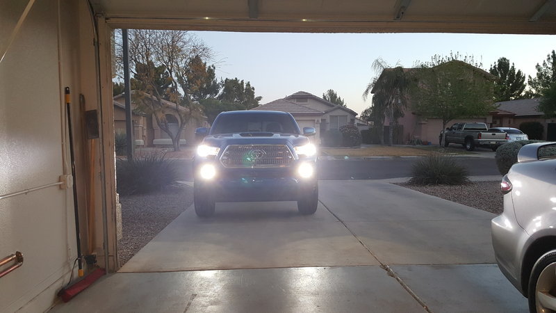

  4. Sep 18, 2016 at 2:30 PM
    P.16taco
    P.16taco Well-Known Member
    Aug 13, 2016
    #194493
    46
    Paolo
    2016 White Tacoma TRD OFFRoad
    I went with HIDs because I've had experienced with them. People will argue that HIDs will cause your light output to look scattered but to be honest the taco comes with projector headlights that makes em spread out nicer. The cut off the headlight is still there just like your stock halogens. I was going to go with LEDs since a shop close to me carries both, but i decided to go with what I'm familiar with.

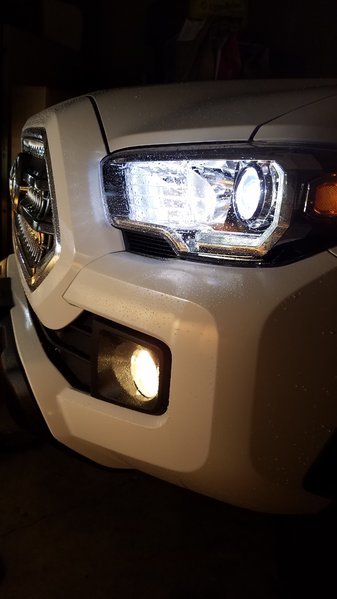

  12. Sep 18, 2016 at 2:36 PM
    P.16taco
    Aug 13, 2016
    #194493
    46
    Paolo
    Dry night drives, the stock halogen were fine with me as well, but where I live it rains all the time and driving with stock halogens when its raining I can barely notice that i have headlights on. Just preference I guess
