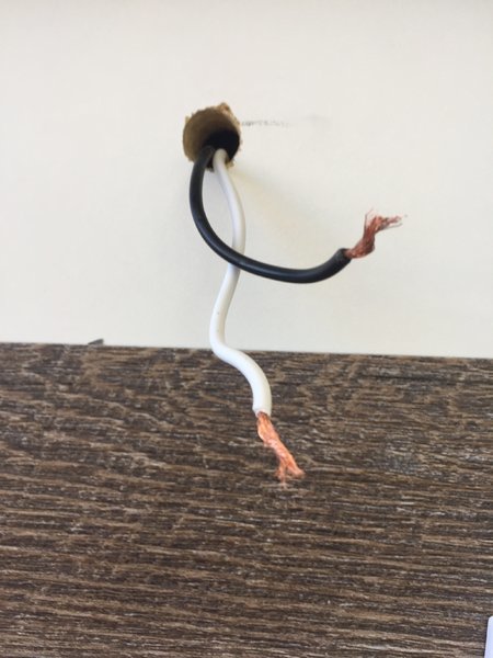

    Original/feed wires (1 white, 1 black)

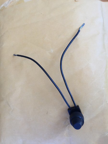

    On/off switch wiring (2 black)

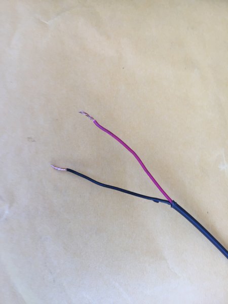

    LED strip (1 red, 1 black)

    Likely 12v. So hook up black trailer to black led. Put the switch between the white and red wires.

    I was just reading online about camper wiring.
    Black supply goes to red of light.
    Did that.
    White of supply goes to black of light.
    Did that.
    I DO get power to the light strip and the on/off switch functions.

    Could also be dim if your running the wrong size led. Is it a 12v strip

    D.C. 12v strip.

    This is a 12v strip from MattGecko that similar to what he makes for truck bed lighting. I'm just using it for a different application

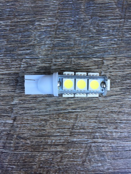

    Battery. It's new. Been used Very Little. All lights are LED now, so little drain.
    The previous light fixture had regular bulbs, worked fine. I put in LED bulbs. Worked fine (full brightness). All I've done is removed the fixture...

    if it was a bulb from a house then i dont think that its 12v going to it
  19. Nov 17, 2016 at 1:29 PM
    #19
    Cuffs
    Cuffs [OP] Well-Known Member
    Feb 23, 2016
    #179153
    6,202
    Lummi Island & Grand Canyon NP.
    2016 Inferno TRD OR 4x4 DCSB/2021 4R MGM Nightshade
    Bulb from old fixture.
