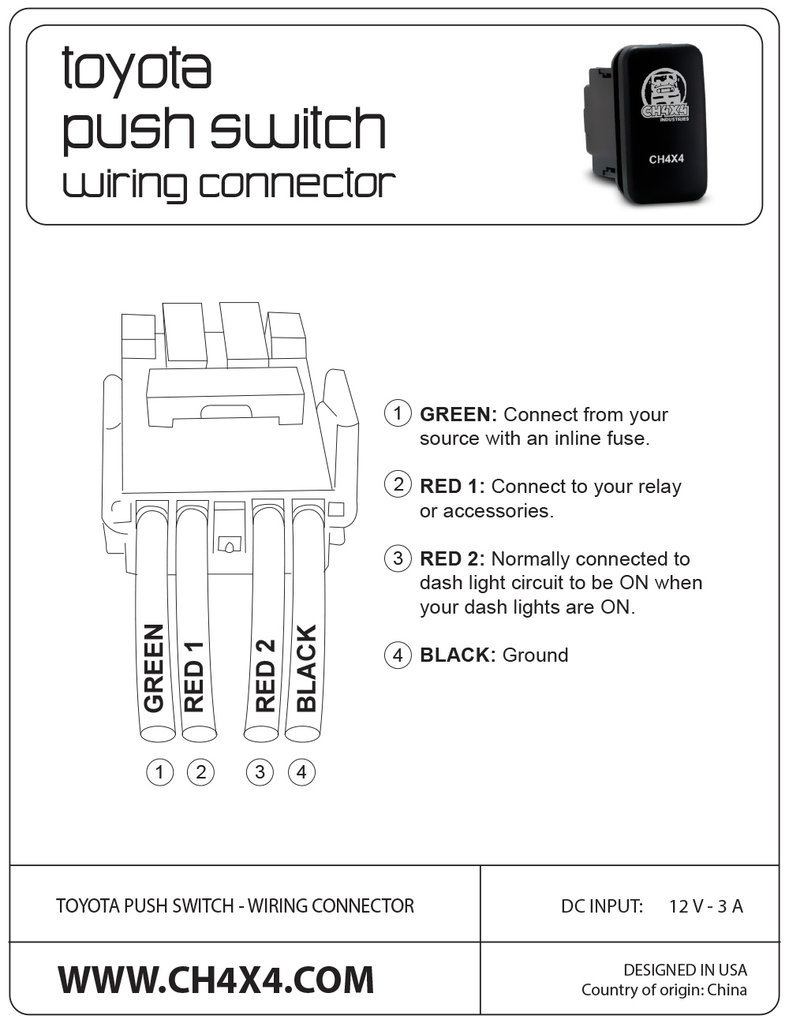

    Rigid harness wires
    Solid red - fused battery power feed connection (input)
    Red with black strip - positive wire for led pods (output)
    Black(2) - negitive wire for led pods and negitive battery connection710434d1461903126-wiring-spod-ch4x4-toyo_90d5015659bb49eebf059b5c64f789b07cf5fbdd.jpg
    MT_TACO16 likes this.
  8. May 7, 2017 at 9:33 PM
    #28
    fergyz
    fergyz Mmmm...Tacos
    Apr 25, 2012
    #77624
    743
    49th State
    06' DBC 4x4 6spd
    Rigid harness connection to relay
    Solid red wire to pin 30
    Red w/black strip to pin 87a
    Black wires to pin 85
    Switch connections
    Red 1 wire to pin 86 on relay
    Green wire to a fused input - switched or constant (your choice)
    Red 2 wire to/using add a circuit to "tail" fuse or leave unconnected
    Black wire to chassis ground

    Okay this is my last question and I will have this figured out, so the green wire from the switch, you said to connect it to a fused input, switched or constant your choice. What do you mean? Like do I run that green wire back to the relay or connect it somewhere else?
  12. May 9, 2017 at 8:21 AM
    #32
    snowbrdd
    snowbrdd Well-Known Member
    Mar 17, 2015
    #151172
    232
    Somewhere else. Fused simply means that you have a fuse inline before the switch. Switched means it only has power when the ignition or accessory is on. Constant means it has power all the time.
  13. May 9, 2017 at 2:18 PM
    #33
    fergyz
    fergyz Mmmm...Tacos
    Apr 25, 2012
    #77624
    743
    49th State
    06' DBC 4x4 6spd
    the green wire should be attached to a fused source more for safety reasons than anything else i.e. electrical shorts = fire. Since the rigid harness is now connected to the relay, instead of a direct connection to the switch. You will need to provide the 12+ power feed to activate the relay via the switch.
    You can accomplish this by either running the green wire back down to the relay and splicing it into the battery wire on pin 30 (constant power).
    or
    run the green wire to a wire that is powered when the truck is on. Cigarette light/power port tends to be a good option. an add a circuit to cig fuse (unsure of actual fuse name) or a direct splice can work here.
