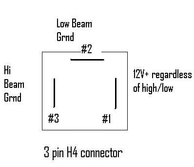

    Yeah our lights are a little tricky. They are negatively switched. Meaning:

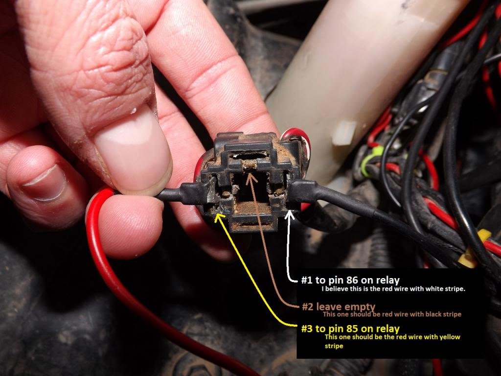

    And here's how I wired mine:
    pin 30 goes to battery.
    Pin 87 goes to led bar.
    Edit: my passenger H4 is blank due to the retrofit. So that's why I used those pins. But you can use whatever method, such as wire taps/splice connectors, you wish if you have stock headlights.
    And in my pic I think I have the wire colors swapped. 85 i shoukdve made black and 86 red. But it doesn't matter at all on the color.
