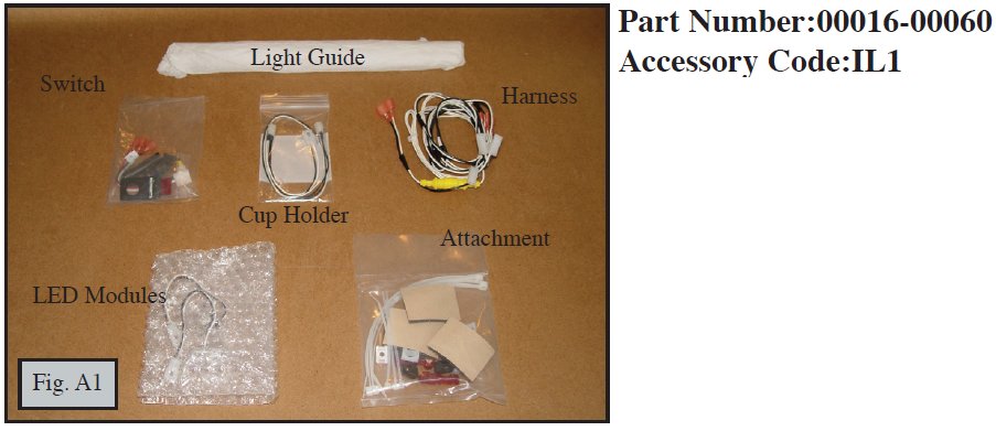

    This kit has 2 LED light bars and 2 LED for the cup holders and has no added fuse, it wires into the same location you were thinking. (A/C lamps)
