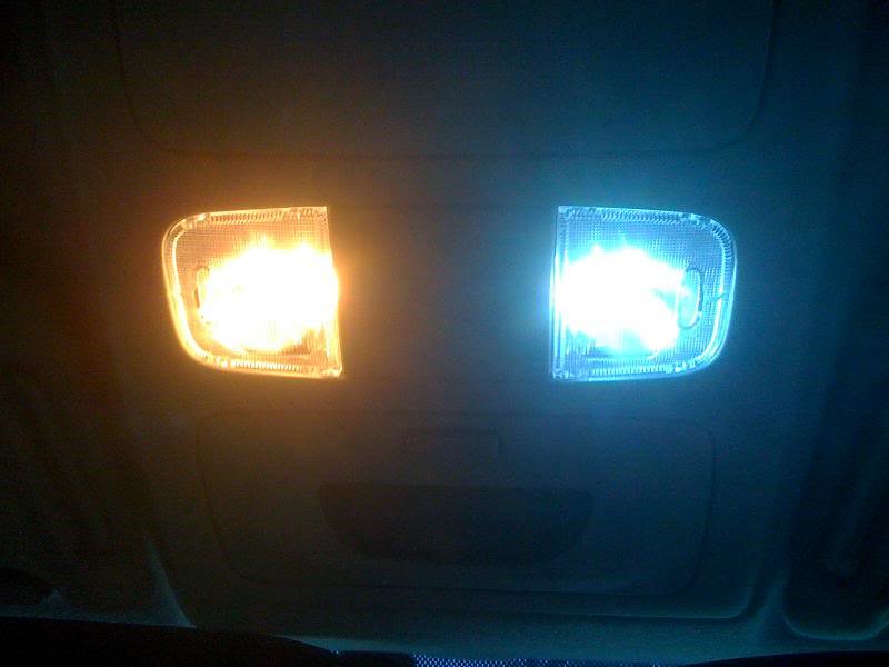

    I ordered all of the bulbs the OP suggusted but i'm a bit let down with the color difference from the interior map lights (WLED-x5 Cool White) and the dome light (4410-x9 Cool White).
    Did anybody else have this problem? The map lights are a nice solid bright white light and dome light looks like a blue bulb i picked up at pep-boys.

    Yeah, mine came out the same way, but I'm happy with the light it puts out. The map lights are much better looking.
