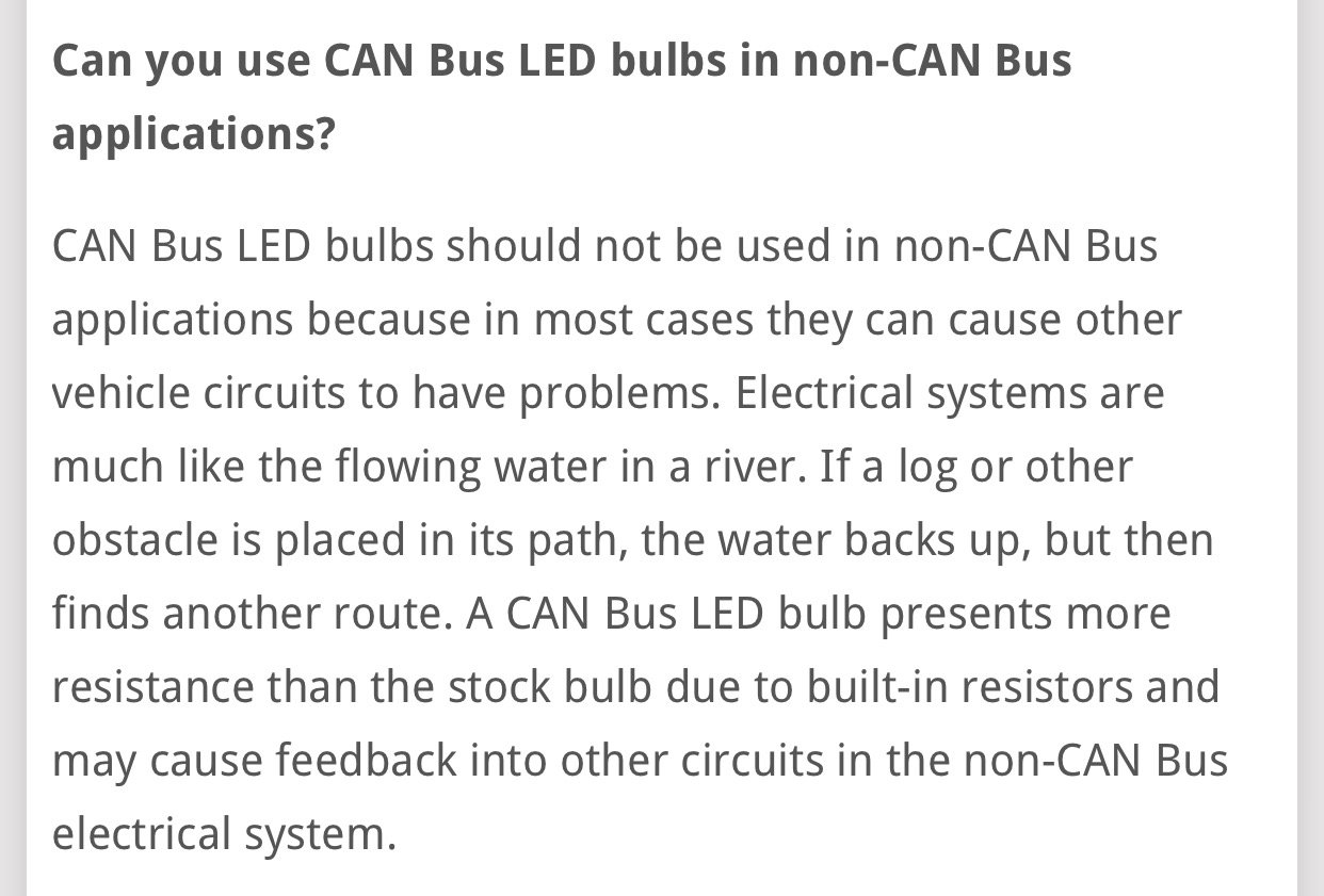

    Looking to pull the trigger on some interior LED's as well as reverse and license plate lights.
    Before I do anything, I am trying to figure out if I need CANbus LED's or not. My tail lights are LED but I know for a fact I don't have a bulb out indicator light either....
    Any help is appreciated. May just call dealer in the A.M. :boom::burp:

    My Toyota dealer was less than helpful which is very frustrating. "We don't recommend anything aftermarket" which I'm sure they are required to say that. Why the parts and service folk couldn't tell me a yes or no answer if I need a CANbus bulb is beyond my comprehension and somewhat infuriating. It seemed like all I could get were curt answers with slight attitude and I am a nice person.
    I was told to purchase an electric wiring diagram from HelmInc.
    Not sure what else to do unless I speak to a manager or corporate.
    The light manufacturer said more than likely non CANbus will be fine for interior. CANbus will work with non CANbus bulbs but not vice verse.
    I may bite the bullet and pull the trigger since I can exchange them with no problem within 30 days.

    https://www.superbrightleds.com/blog/can-bus-led-bulbs/293/

    Interior red LED lights have already been done - about a week ago.
    That being said I've always wanted to figure out if my LED headlights installed by a local shop really needed a CANbus or not.
    I walked into that sale from them with absolutely no knowledge or research. From not knowing if I needed said part to the fact that LEDs can not be used in a stock halogen projector.
