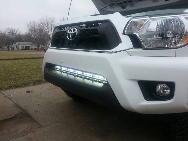

    ok i found the link someone posted for those switches.. thank you, and they look nice. but ill stick to my $6 ones, $39 is a little bit more.

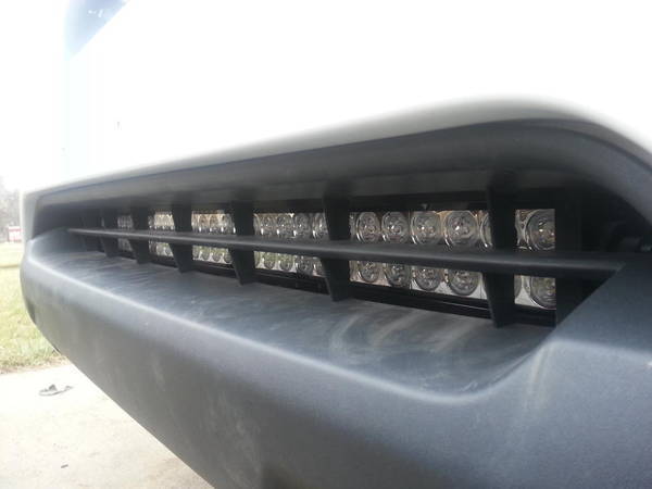

    OP i really like the light bar you made, i am curious does it have to be 40" or could it be 44" or 46"
    What does one cost? I have a 30" rigid E in the bumper now and its just too expensive to get a 40 inch for the roof, however i like that yours looks quality unlike many of the less expensive or alternate brands.
    In my pic above is my first LED bar i believe, it was an unknown brand before i got the rigid its nearly identical minus the bolts around the front.

    For my self i think im going to put a 30" in the bottom was think about the top but i dont know

    A 40" bar for me would cost 440$ with a wiring harness, you could always do a single row which would be a little less but if you want the look of the double row then thats different, but i have compared my light up yo a rigid and mine was pretty close to the same, i mean yea rigid has the hammer proof lenses and stuff like that but i doubt you'r gonna get a big enough rock to hit that and cause damage, but pm me if you're interested about the specifications

    Also in my pics i posted i have the bar pointed down quite a but because i was on the street but if i was on a dirt road the bar would shine further than posted
