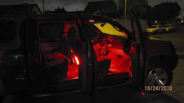

    I put LED strips (16" ea) on the seat adjuster handles (front) and on the B pillar (rear). Here is what they look like on... Red truck=red interior lighting... (;-D

    woah how'd you do that??

    I wired them into the dome circuit, found a post in here that called out the wire in the drivers side A pillar. I ran a single wire to the center console and powered all 4 strips from there.
    I can take some daytime pics to show where I put them...

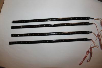

    No drilling, I tapped into the circuit behind the drivers side A post handle (with 2A fuse)... Ran the wire down the pillar, along the door sill behind the front seat and across to the center console. From there I powered all 4 of the light strips.
    The light strips I used look like these:
    I bought them from PepBoys $22/pair.
