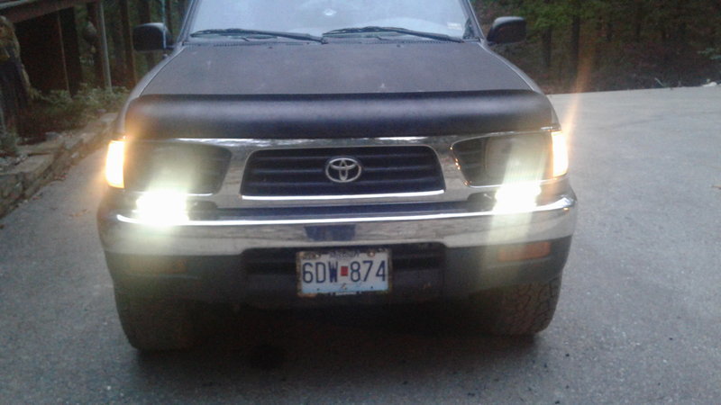

    This is the leds I put under my headlights. Turned out great. Not done with it yet will post picture when done.20161014_072036.jpg

    Finally I see someone does it. It's so professional for factory like looking.
    I was looking into something like that for adding Phillips or Osram DRL (They are DOT and SAE legal) to my truck (95). Did you cut inserts or you just removed them altogether? I don't remember it (I've removed grill so many times but old age...) how much space (how deep) is behind inserts?
    I will be waiting impatiently for updates :bowdown:.

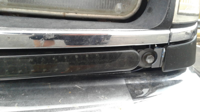

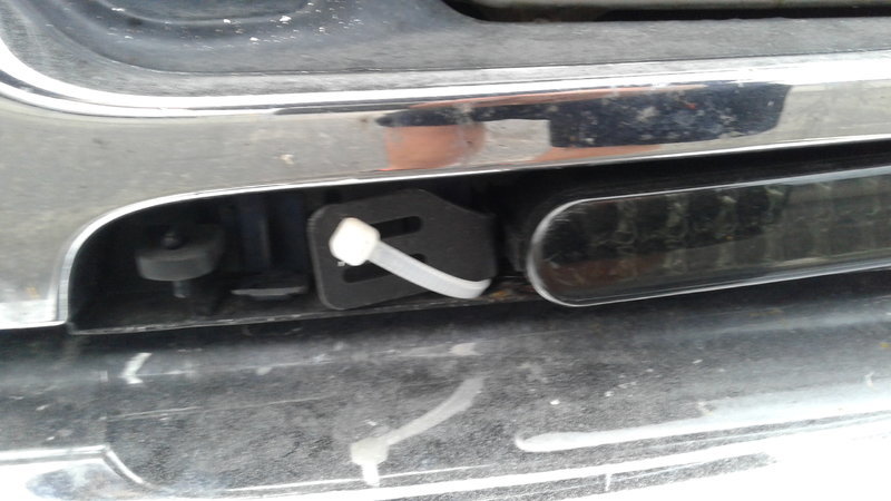

    The ziptie might be replaced with a bolt. The filler might act as the anchor though when i get them put back in

    Thanks a lot. Darn, no ECU or DOT markings. :annoyed:
