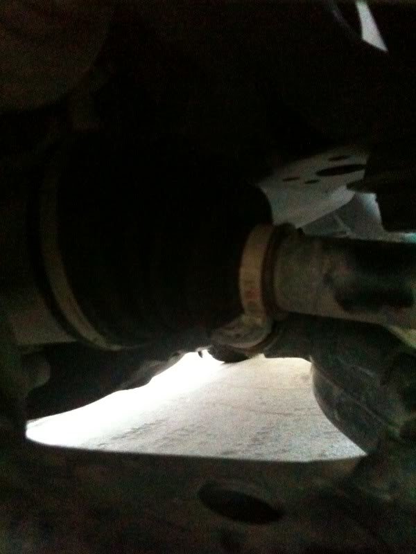

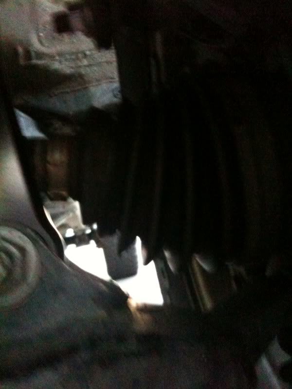

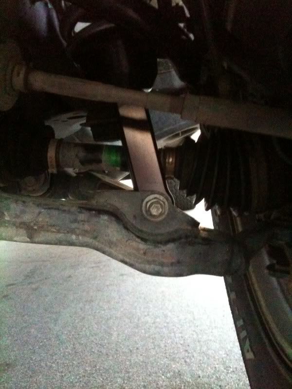

    check your CV's, if the fins on the boots are touching, lower the shocks a bit and check again. once your good to go, hit up some dirt and get a real review of those bad boys :D

  16. Jun 14, 2010 at 8:06 PM
    #36
    nighthawk87
    nighthawk87 [OP] Well-Known Member
    Aug 9, 2008
    #8434
    1,019
    Here are the pics of the CVs that I just took :D. How am I? Do I need to go lower?
