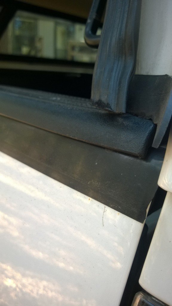

    OK, here are the pics
    Picture #1 is how I protect my paint from the cap door, heavy rubber tape, looks like I need to trim it a bit. I'm not sure where this tape came from, my father gave it to me. It looks like plain old 2" electrical tape. It was on my 06 for about 5 years and never had to be replaced. If you look close, you can even see where the door hits the tape.

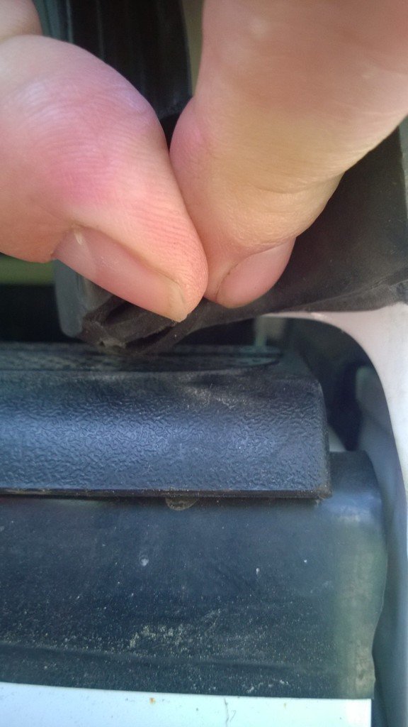

    Picture #2 is they gap between the top of the tailgate protector and the cap:

    Much appreciated hotrod. Looks like you have a decent gap there.

    Yes, plenty of room. I can however tell you that they did grind a bit from the front downward skirt curve when I got my 100r on my 06. Make sure that the cap fits on the bedrails properly and DOES NOT force the bedrails down, that's where they ground a little out for me. If it does, it will wear through your paint under the bedrails around the edge. Just to give a better example, if you slide the cap off center left to right, the skirted part will force the black bedrails inward and will wear through the paint. If installed centered, the bedrails stay up and off of the paint.
