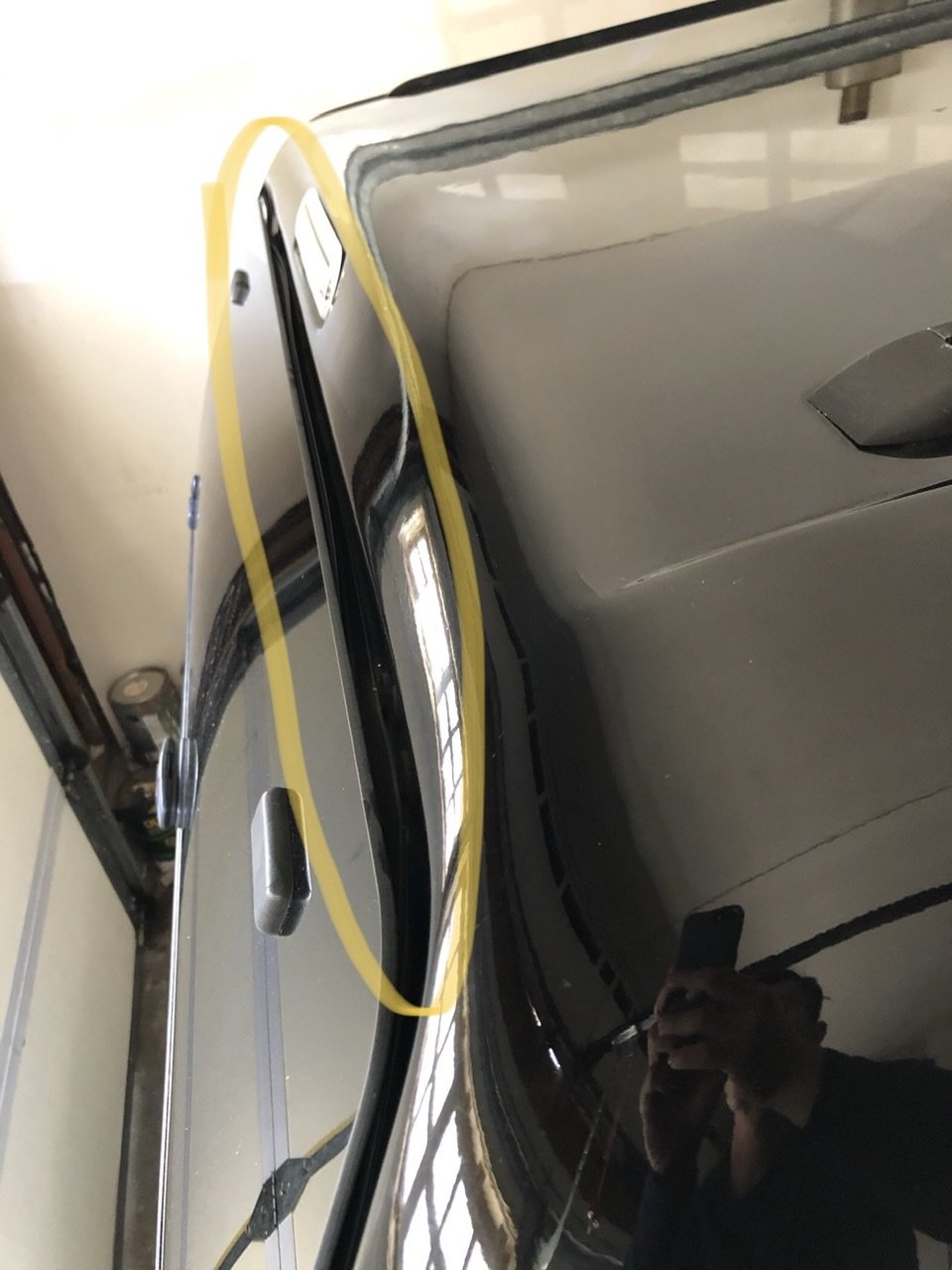

    hi all! bought a used leer100 XQ recently and i’m fixing all sorts of little problems with it.
    the top of back glass doesn’t rest fully on the seal allowing water to get in. good size gap, too.
    have any of y’all encountered this? any creative solutions?

    It looks like you are missing the bottom drip edge. It is a $100 piece from the dealer AIRC.
    Really, rotate your photo so you can tell what you have going on with all the reflections.

    bottom drip edge for the top? i’ll take a better picture soon

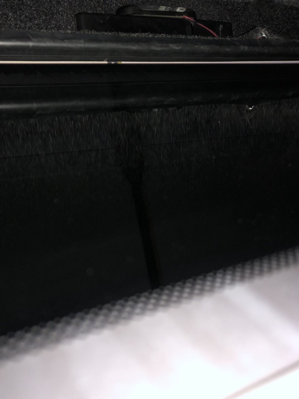

    this is looking upward with glass closed

    There are adjument points built into the hinges. From what I recall, there are some bolts and allen screws that will allow some adjustment. There's not a huge amount of adjustment, but you should be able to get some. Do a little at a time and check the fitment as you goto confirm you're binding things up somewhere else.
    Another thing to look at is the condition of the rubber weather stripping. Maybe that has reached the end of it's life and isn't compressing correctly to seal the window.

    What #Rocketball said.
