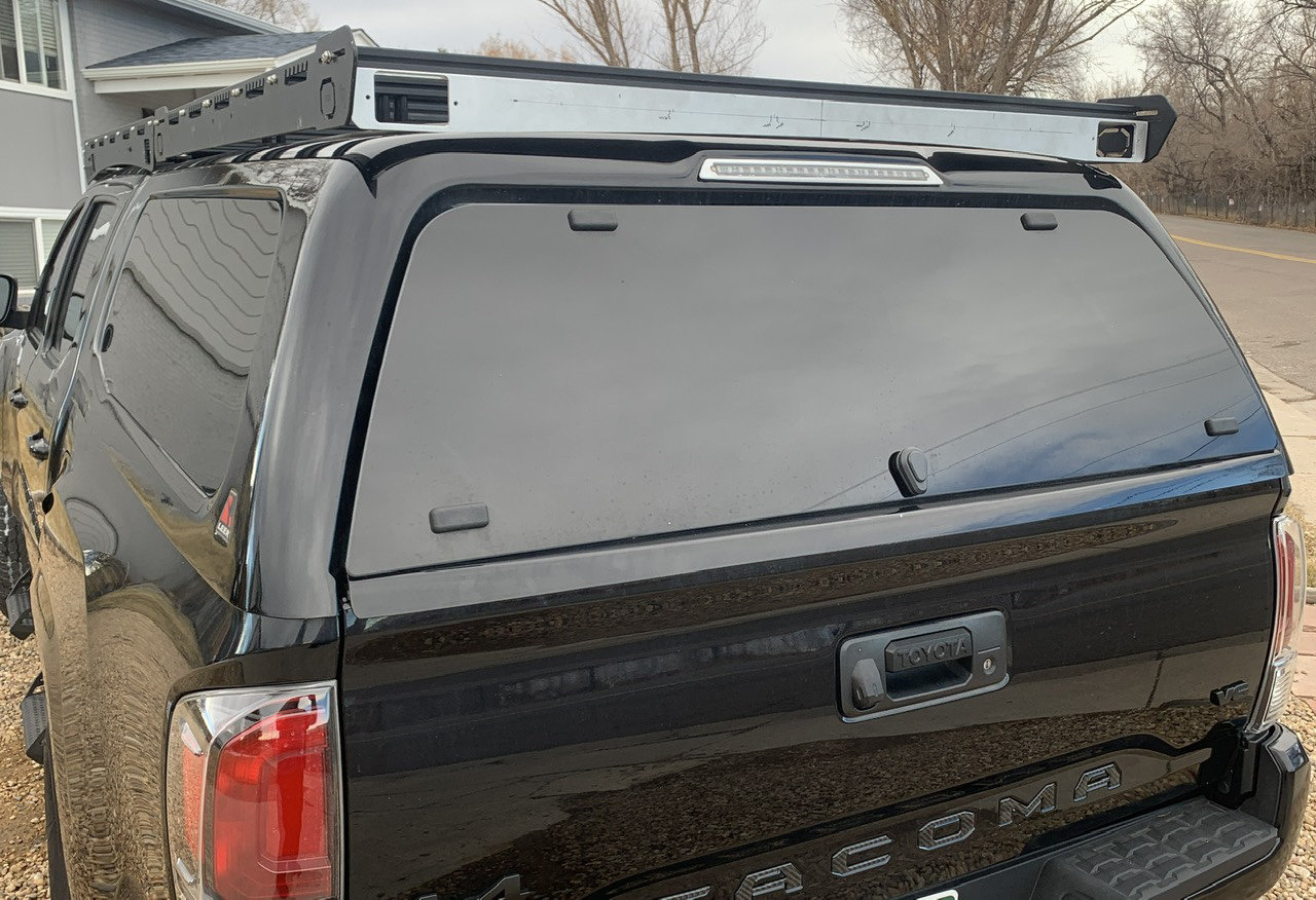

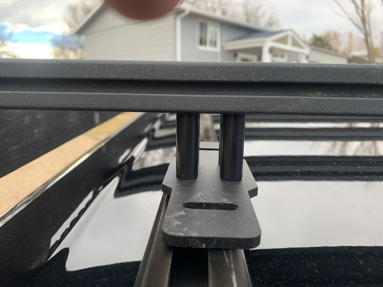

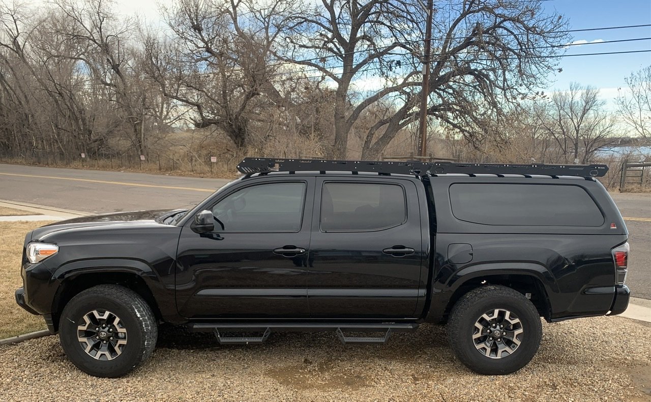

    Here are a few pictures of the test fit if anyone wants an idea what a 100xq looks like with an UpTop Overland Bravo set up. Keep in mind this was a test fit, so be gentle on me....
    763EBD04-E298-4E30-B1A4-40D47E995B44.jpg EE12E13F-89B1-4C4F-BE0D-BA8F0EFFFC41.jpg 3DFE3407-5F31-4BCA-A518-AF76B016330C.jpg
    @daveeasa just so he can see I actually do own a truck :rofl:

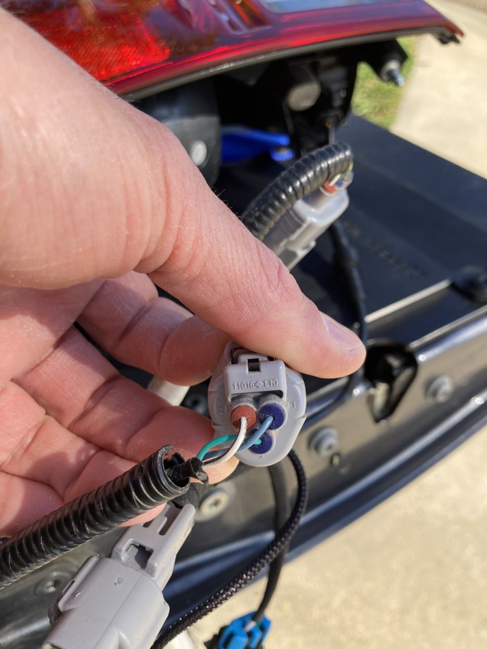

    I can sell you the one I built last week if you have your shell coming soon, I have 8-10 weeks before mine might be ready. I only did one wire for power though, figured I'd do a chassis ground. I can get you a photo of it tomorrow night (out of town right now.)
    @Puppypunter or anyone else please confirm this is the correct power lock for Leer 100XQ

    Even for someone with the OEM tailgate lock, I'm having some trouble sourcing the female on that sucker. Corsa has the male but 7283-7028-30 mating female just seems a bit elusive. Since it's already an add on harness I'm fairly tempted to just cut it and use any 2 pin sealed connector I feel like to get the tap, possibly the reverse connector. But I'm in a bit of a special situation because I already swapped male and female so that the male would sit on the mounting clip nicely and I can quickly remove the tailgate without cutting a zip tie.

    I bought the PL9555. IIRC, the directions were for the 9555 and the 9772, so both might work?
    AmazonSmile: Pop & Lock PL9555 Keyless Remote Entry Kit (with handle): Automotive
    As to the lock connector:
    Amazon.com: 1x Connector 2-way 2 pin for Ambient Temperature Sensor 90980-11070 w/out wire: Automotive
    Edit: I just looked at the 9772 vs the 9555. Seems the 9555 comes with the handle where the 9772 does not. I believe the leer handle will work though.
