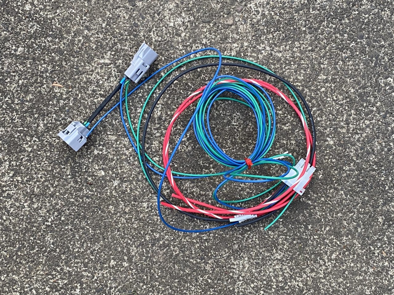

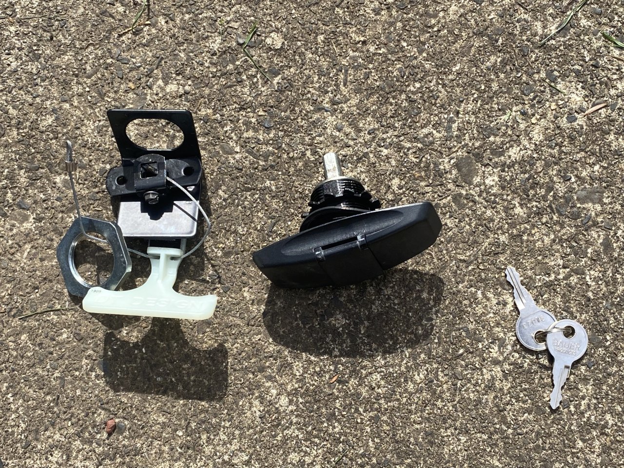

    I got the Tacoma wiring kit; Leer also took a look and had me change out the lock itself to work with the lock wiring/actuator/etc.
    Also had puppypunter make a harness to connect from the Tacoma wiring out of the Leer connector box, or something like that. I can't recall-- it's all fuzzy.

    I recall now. Puppypunter made the harness that taps into the tailgate plug/socket and then into the Leer fuse box, then wire the Leer actuator with some of the wiring from their kit, to their fuse box. The new lock by Leer shown. Feel free to pay it forward to him; he did a fantastic job!

    I do not; we have a Leer location in (Oregon City) and prior to purchasing in person, called and spoke with them about what was needed. The price was slightly over $100. You'll need a compatible key cylinder/assembly. Probably cheaper to just cut a couple wires and find the right crimp connector that goes into the Leer fuse box and to the actuator.
