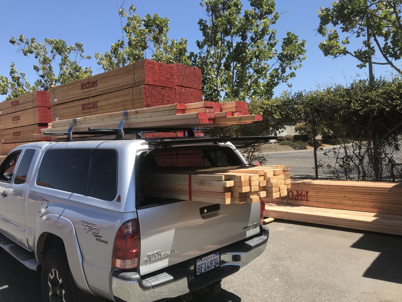

    Here is my older Leer 100XL (single handle). I load the $hit out of it equipped with roof tracks and standard Yakima bars. Never had any issues and it must be 10-12 years old now.

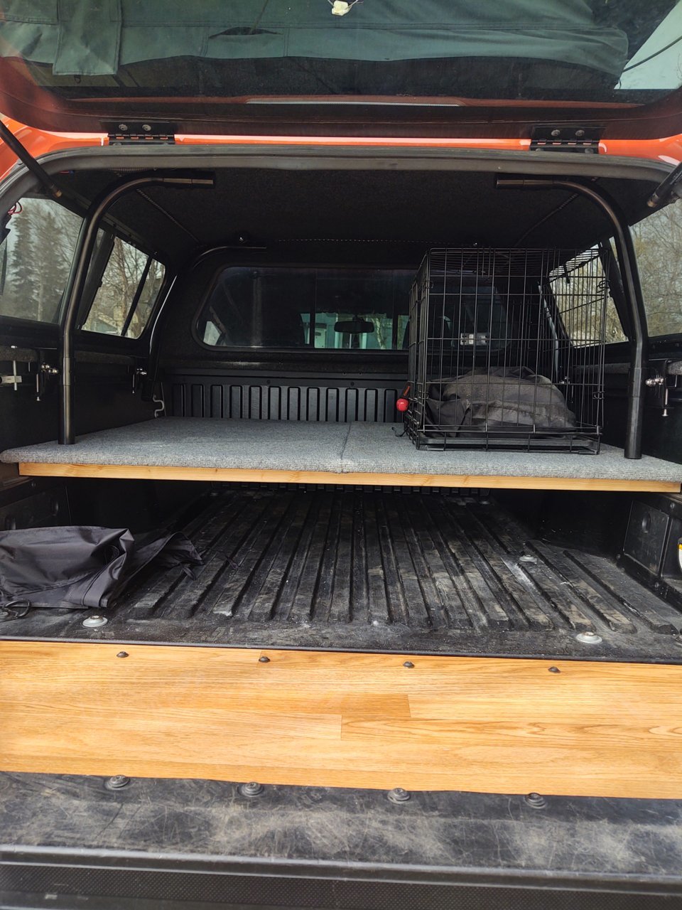

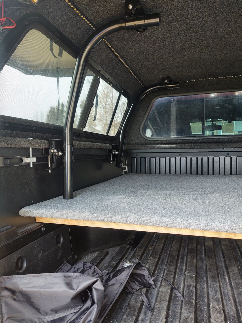

    I decided not risk any structural damage to my 100xr with my roof top tent setup. I purchased some internal supports from a company in Australia. ( Milford Loadmax)
    They are attached to the base of my rack towers through the ceiling and sit on the bed rails. The weight of the tent Is transfered to the bed rather then just on fiberglass top. No issues to report so far
