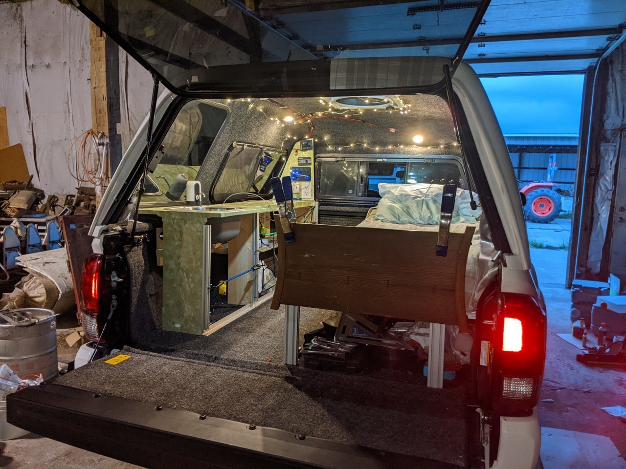

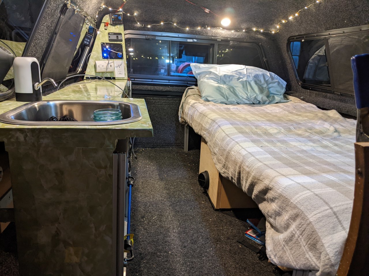

    Pretty much finished my build in a Leer 122. Features include:
    Diesel heater
    Maxxair ceiling fan
    USB rechargeable water pump
    250 ah lithium battery system
    2000 watt pure sinewave inverter
    House battery charges from the alternator, with option to add solar panels
    Cooking is electric: water kettle, george foreman grill, small rice cooker
    Latex mattress with memory foam topper
    110 volt outlet plus 12 volt and USB in the camper
    Bomb-style automatic fire extinguishers in furnace box and electrical system compartments
    Oak footboard (still needs screwing on) to keep the mattress in place
    I am really surprised to find that adding all that cabinetry somehow makes it feel bigger inside, not more cramped. The 122 is an excellent choice to build out a camper that doesnt compromise the usefulness of the truck in any way.
    How-to details in my build thread

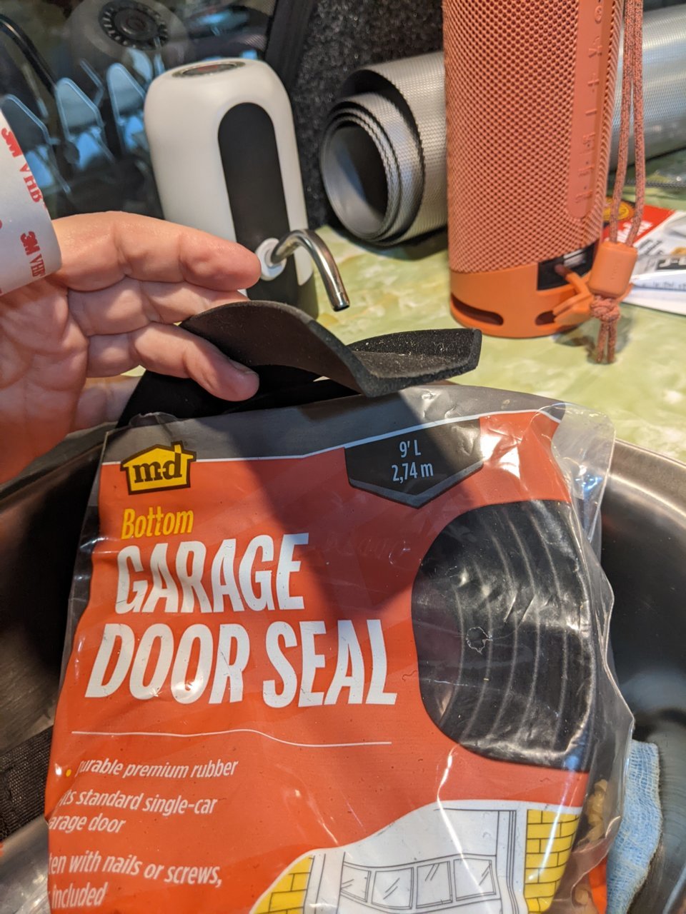

    I plan to use this along the lower drip edge, and extend it off the edges as far as the factory shape should have gone.

    This was a complete failure, don't bother. First, The material wouldn't stick to UHB tape at all. But also, once I had cut it with the flared ends I was sure would close the gaps, well, it just didn't. Even if it had adhered, this was not the fix needed to close the gaps. Back to the drawing boards.
