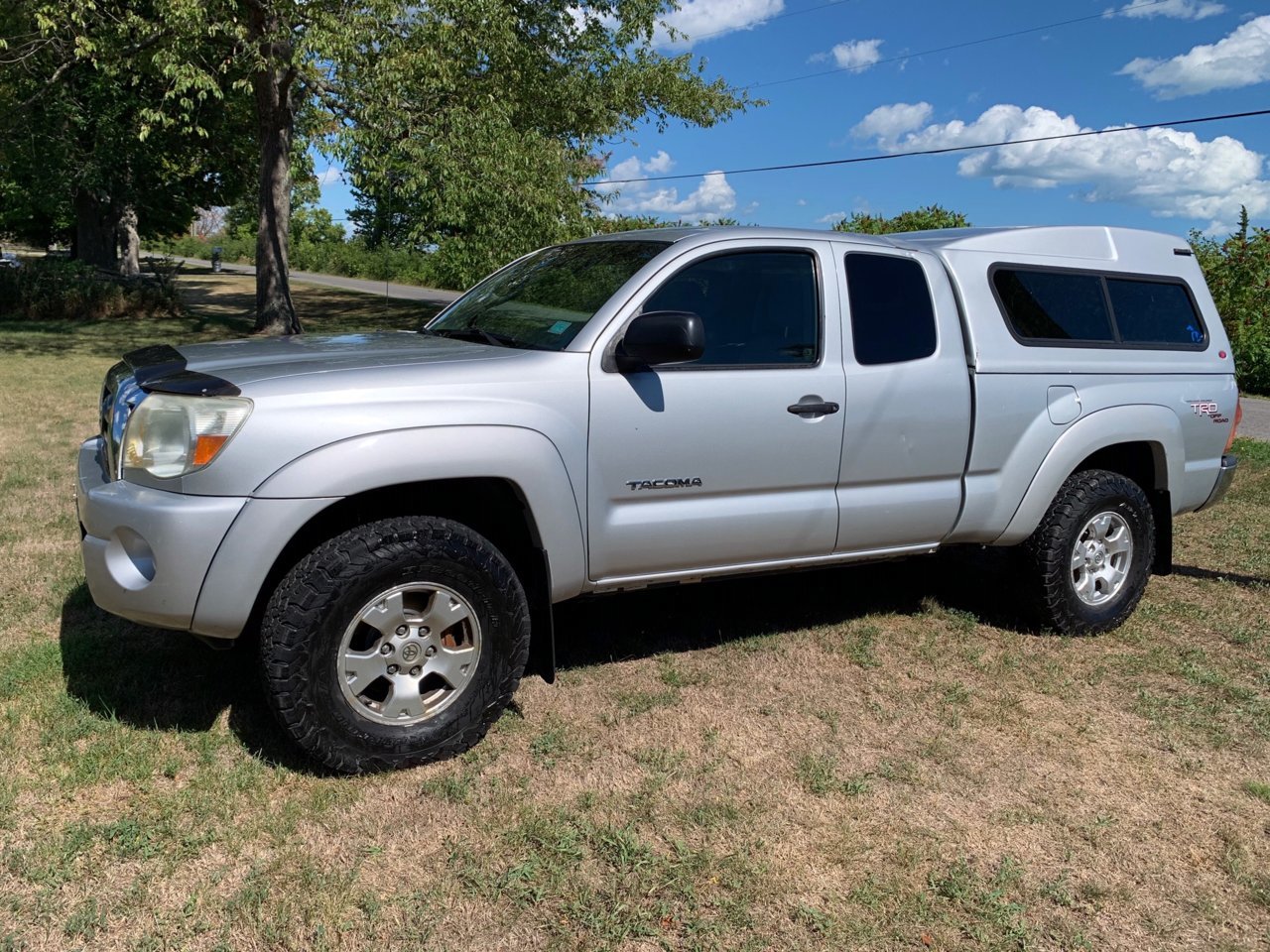

    The shell looks really nice on your truck, good find!

    damn..that looks really good despite the mismatched color!! leave it alone..ride height and everything! did the interior clean up as nicelly?

    I like the look of those 4runner wheels! The '15 Taco that I recently purchased came with a Leer top, the side windows flip up like the hatch window. Ironically, my truck is MGM and the cap is the body color of your truck!

    Already thought about that, but the place I bought it from was a body shop that did a proper job of painting it. Removed windows, sanded the whole thing, prime, paint. The story I got is that the owner bought it for his 3rd gen, had it painted to match, then when they installed it realized it was for a 2nd gen. The owner didn't like the look, paid for the paint job and never picked it up, told the paint shop to keep it or do whatever they want with it. So I drove out to VT on 4th of July 2018 to buy it before me and my wife left for a 40 day cross country road trip. (left on 7/17/18) so I found it juuust in time!
    Edit: we ate some BBQ, watched fireworks, nearly hit a moose on the way home. It was a great short trip hahaha.

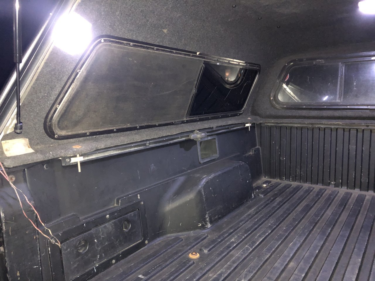

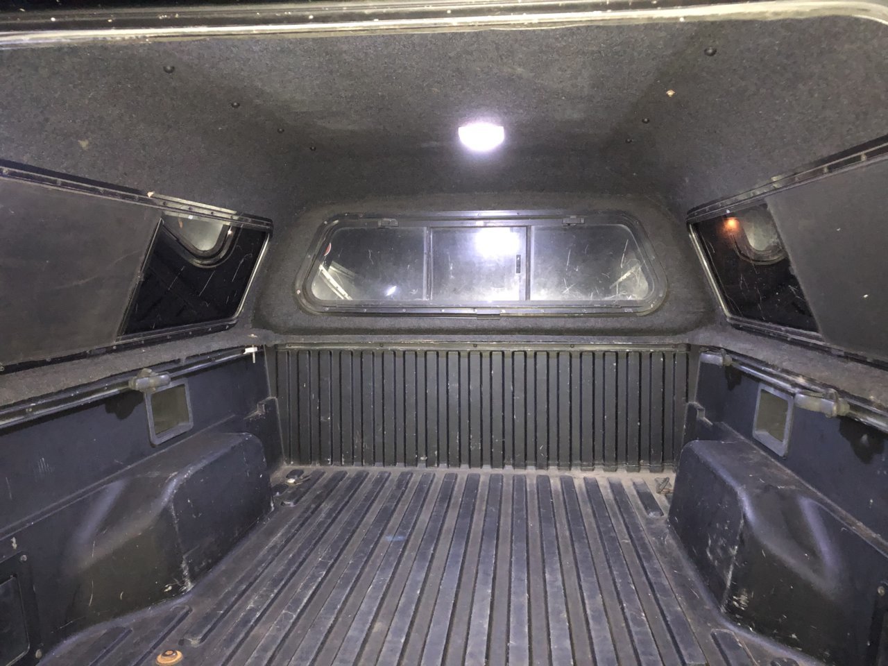

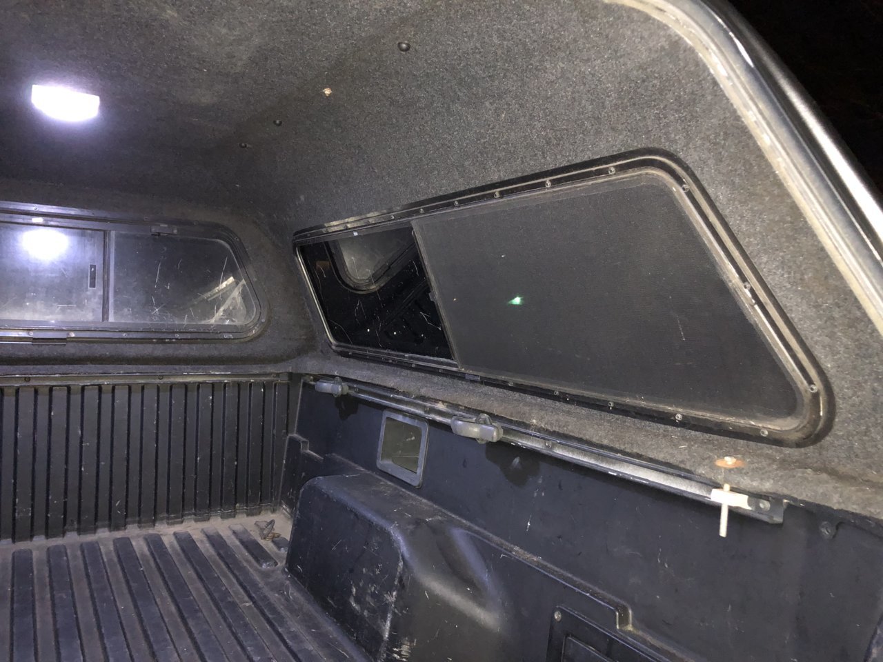

    Finally mustered up the energy to shop vac all the dirt and grass out. Next up is windows.

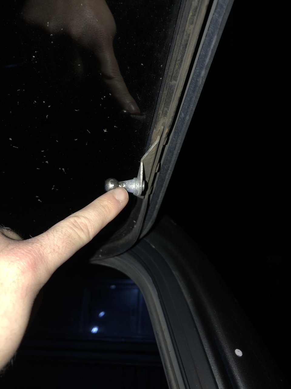

    I also welcome any advice on how to fix these two boogers. The top lift support mount on one side is wobbly. It’s riveted on there so I’m not too sure what to do about it.

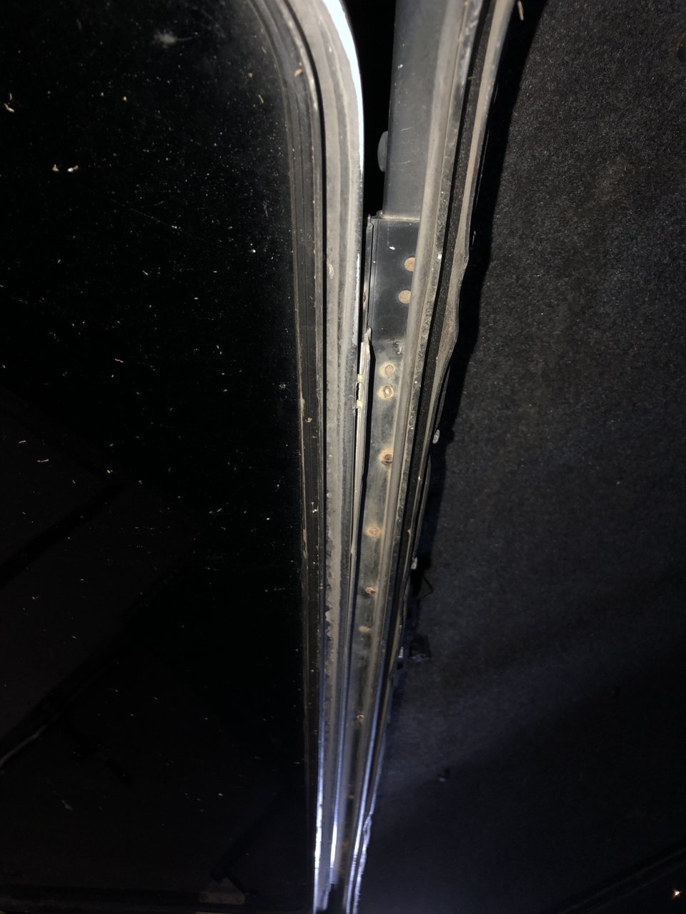

    Also, the piano hinge for the back glass is starting to separate on the same side. I haven’t taken the glass off to get a closer look yet but I suppose I’ll either have to try and crimp it back together as tight as I can or look at replacing it down the road. For right now I’m only running one shock and it lifts the whole window with no issues and also keeps the window square in the shell. When I put the lift support on this side it jacks the whole thing up and puts the hinge in a bind.

    Pop rivets can easily be drilled out and replaced. I use my manual rivet gun quite a bit on projects. Most likely you'll have to remove the back hatch. On mine, there are two set screws on each end of the "hinge." By removing the hatch or glass, will give you plenty of access to the hinge bracket. I think by drilling out the old rivets, realigning the bracket and putting in new rivets should fix the problem. At least by my thinking.

    You could also drill the rivets out and replace with a few nut and bolts.

    https://www.custompickup.com/shop/index.php?m=&c=2960&p=3418&l=product_detail&my_rate=CHF
