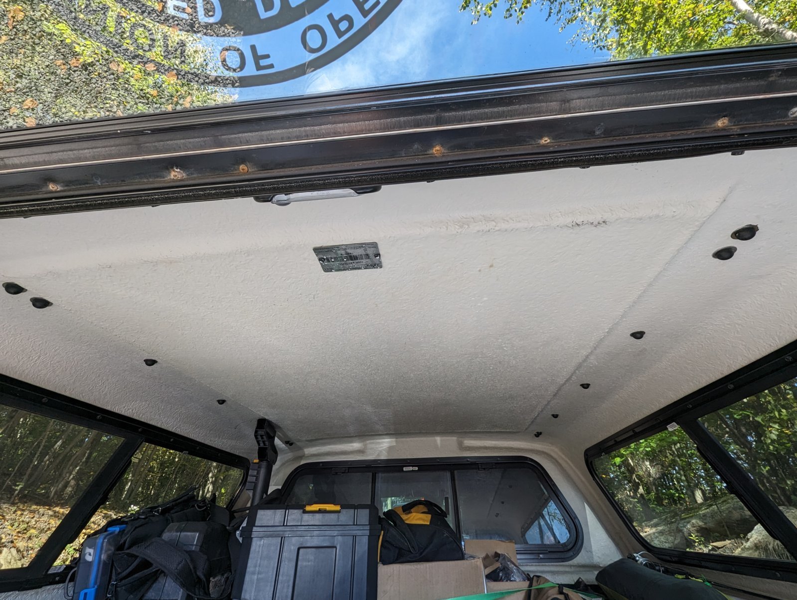

    Referring to these bolts on the roof

    So some electricians at work gave me two lengths of the superstruts they use for mounting their conduit, so what I'm thinking is putting in some longer bolts from the roof rack channels and mount the superstruts up there, then I can mount the panels to the struts, which will allow me to cover the whole ceiling of the cap. I haven't come up with anything for the sides yet

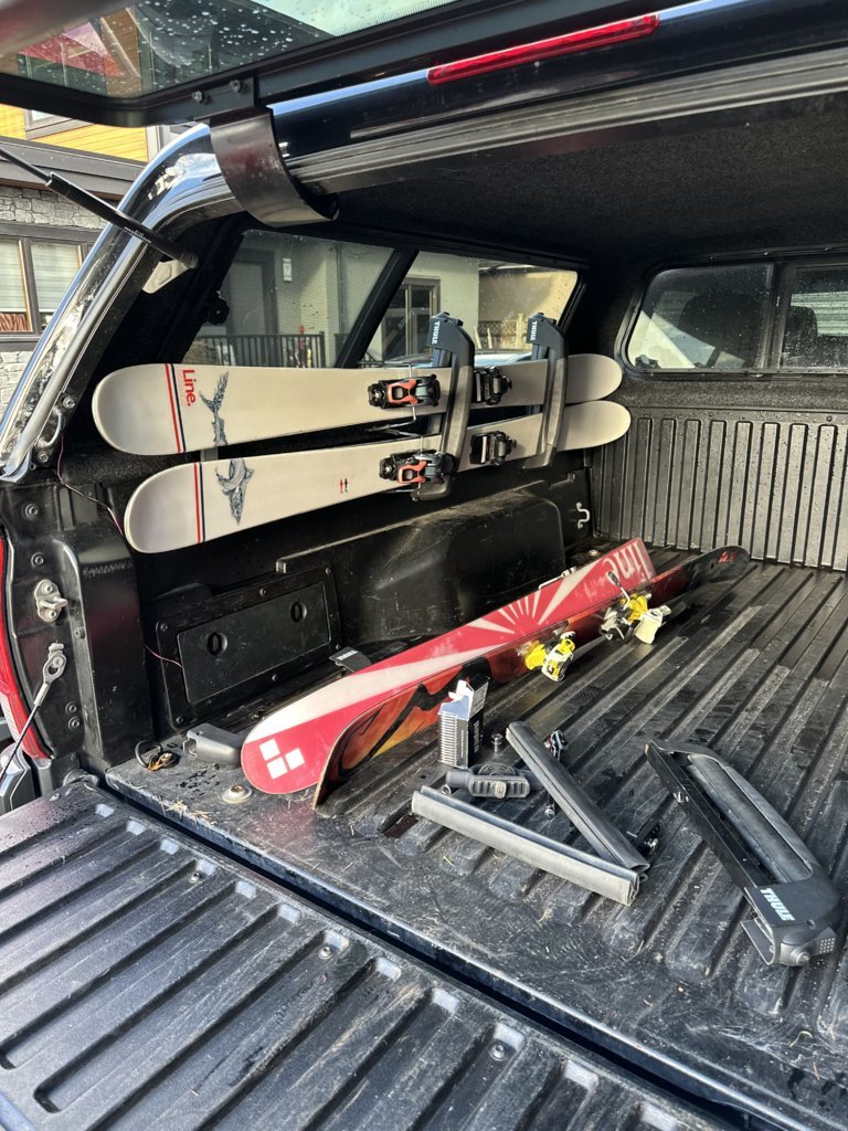

    If you want to avoid drilling into your canopy you could use the bed rails and build up from there. Recently repurposed some old ski racks with a diy mount and could see you doing something similar depending on hope much weight you’ll be putting on them

    Use longer rack fasteners to attach some L-track under the roof and sandwich the shell inside & out with 12” pieces of it in front and behind the windows. Use that to mount square stock fore/aft for the panels.
